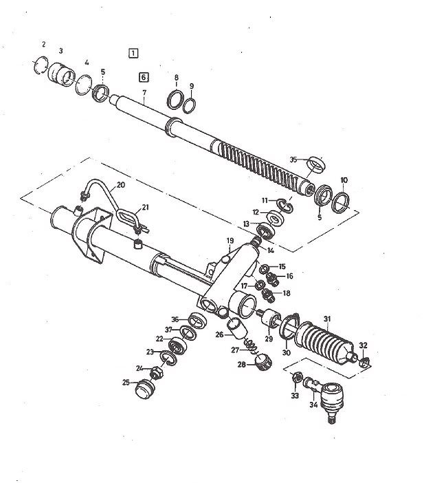

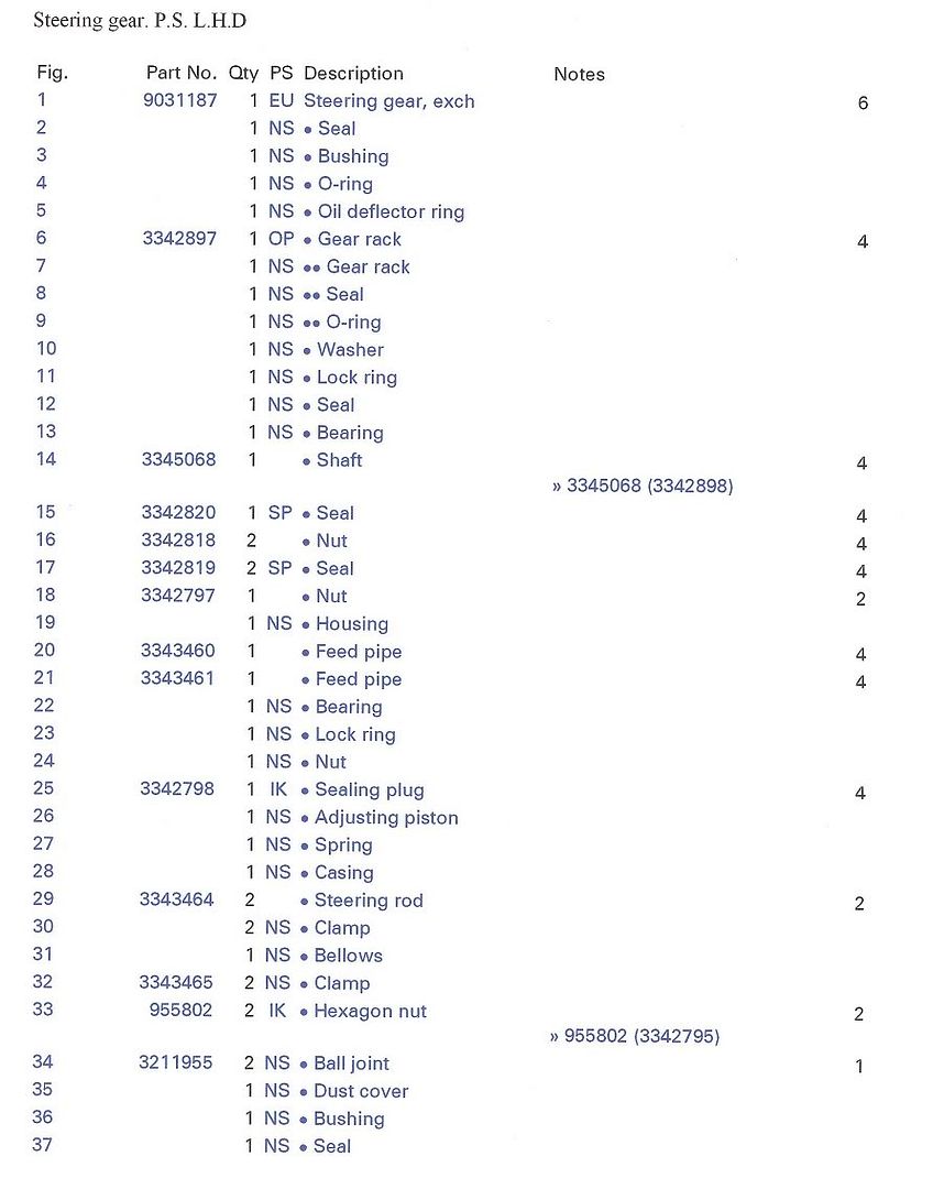

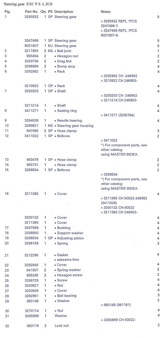

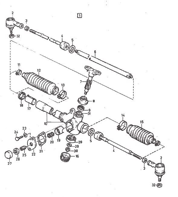

This is what I've found out:
1 Tie rod 343/345 R/L w/o P.S outside tread 3268829 85.134
2 Tie rod 340/360 R/L w/o P.S inside tread 3293736 85.172
3 Tie rod R/L PS 3343464 85.3464
Seems like dead end to me...There has been three different Tie Rods and PAS-version is unique and EXPENSIVE...damn...
