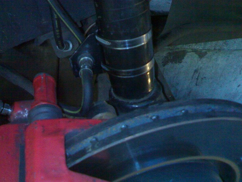

Post by 340GLT » 11 Jul 2006 10:15 pm
I LOVE MY CAR AGAIN!!!!
Right its all sorted and you will never ever guess what it was!!! Its was only visable when the car is sat on its wheels on a ramp etc!!!
Explanation.
My new brake setup has longer front hoses to the calipers, this meant i had to strap them to the strut body. This is all good and fine but when i lowered it that little bit extra it was kinking the hoses up!!!
So made some fancy brackets to prevent it and all is now ok!!!
Of course when the car is jacked up they are fine, its not until i dropped it back on its wheels that they got tight!!!
The pulling was because on braking the front drops causing the hoses to close further!!!
Just glad its all sorted!!!!
thanks guys!!!!
Adam

Post by 340GLT » 14 Jul 2006 12:30 am
For those interested there is now a pic of the modded bracket for the hose.
