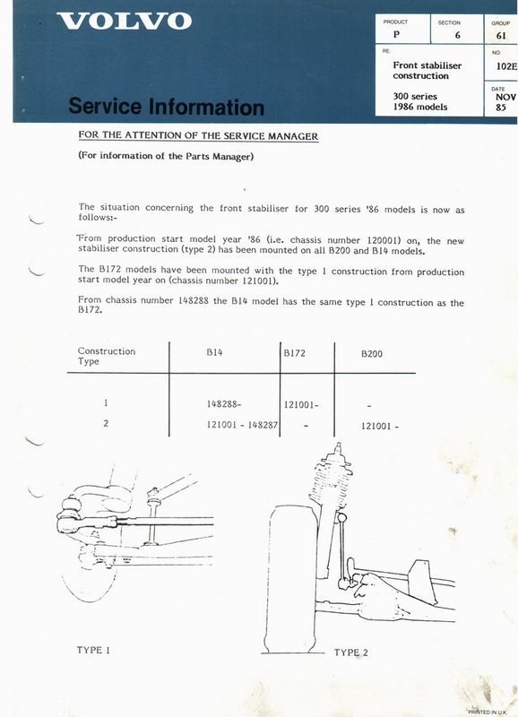

- Posts: 5465
This is what the bible has to say.
Well done that man - confusion clears!
It seems a small number of 86yr. B14s did indeed get the 360 type link rods.
That explains 1.Why the 'New Features 86' green book suggests all variants had the change. 2.Why I remember a squeaking problem in about 89 (3yr. old cars in service sounds right) 3.How I managed to fit 'late type' struts to my '84' from a B14 (I'd remembered it as an 88 but it was obviously an early 86!). It also helps to explain why Vardis is so damn vague!
Incidentally - for those who don't know the 'Blue Top' sevice bulletins such as Dai has posted were not issued by the factory but were locally researched and produced at the import centre in Ipswich and applied only to the UK market. It looks like this bulletin was issued to clear confusion. My own TMA dept. produced many such bulletins but I must confess I don't remember this actual one.
The 'factory' service bulletins had a green top and blue was used only for accessory information.
Hey ho - I was right but Dai was more right !!
Mac.
