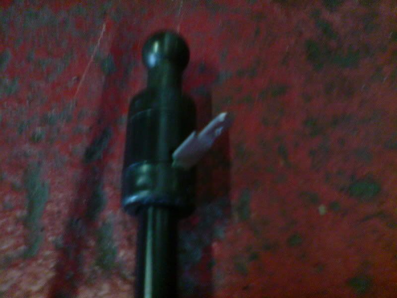

Post by filthyjohn » 19 Aug 2007 11:37 pm
On the boot strut. I've found that pug 205 struts work really well, but they don't have that connection, so what function does it perform? I realise I'm probably being a bit dim here. :oops:

the conection is for the rear boot light i believe, i also need to replace these struts... :?

Tis indeedy the boot light. I know on the struts GSF sell you need to put a bit of plastic tube (I used a bit of a pen) as therelative length of inner strut and outer casing is different, else the light never goes off, might be the same with 205 ones. Not sure about 205 ones, but 300 struts come in 2 flavours, as even Volvo realised the only way the spoiler creates downforce is the things weight... :lol:
On a related note, anyone ever had a ball joint that doesn't unscrew easy? I don't want to kill it, but can't get the switch off, and my new struts didn't have one :( All genius ideas on a postcard... :P

Maybe I understood it wrong, but why do you need to unscrew the ball joint? My struts had a kind of half-moon shaped clip on them, once that was removed it was easy to pop them out of the ball joint ...

So he can put the joint with the switch on his new struts.

OK, I get it - the ball joint off the strut, not the ball joint off the rear hatch :oops:

And Dalahare's right, I need to right my old switch to my new strut, I don't have any boot light at the moment. I'm sure I have a switch in my spares box, but couldn't see it the other day.

Right, cheers guys. How does that circuit work then? it goes to earth through the strut or what? I might just put a rocker switch right next to the light itself, and not bother with getting the strut switch off.

Yeah, it goes to earth through the strut when you open the boot.

If you get some off a volvo 440 with a boot spoiler they are much stronge, but not toolong, you can also unscrew the ends to screw the switch one back on!!! :wink:
