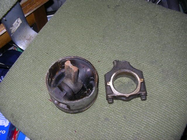

I would suggest you look for a better bottom end. The 9mm rod engines will chuck a rod through the block with no warning. I have seen 5 of these engines myself with a rod through the block and 3 of them were not even turbo engines. Everything else about the package will work well for a 360 conversion. The Motronic weak point is the crank sensor so always worth having a spare one.

I honestly wouldn't worry too much about the B230ET having 9mm rods. It'll be perfectly fine in standard tune. They are weaker, granted, but I've never heard of any original 740/760 turbos blowing their engines because of them - even when lightly fettled. 1stRaven and CHESH740R ran their ET's at upto 220-230bhp and the rods didn't cause a concern, just other (unrelated, mostly Motronic!) issues...

Steve, I have seen a lot of these chuck a rod and only one of the engines had been tuned. It had been running around 300BHP for quite some time bfore that went and it broke in a 40mph limit at about 2000RPM so not even on boost. Again you hear these kind of stories on TB. If you are not bothered about loosing a bottom end the 9mm rods are no problem but if you want an engine to last then 13mm rods all the way.
1987 was probably an especially bad year for rods as 75% of the ones I've seen let go were 87 engines. Here is one from a 87 240 GLT so non turbo
