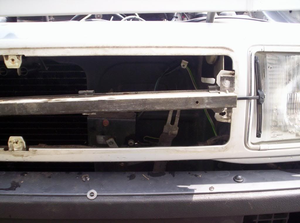

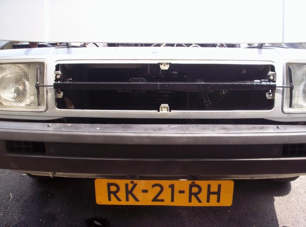

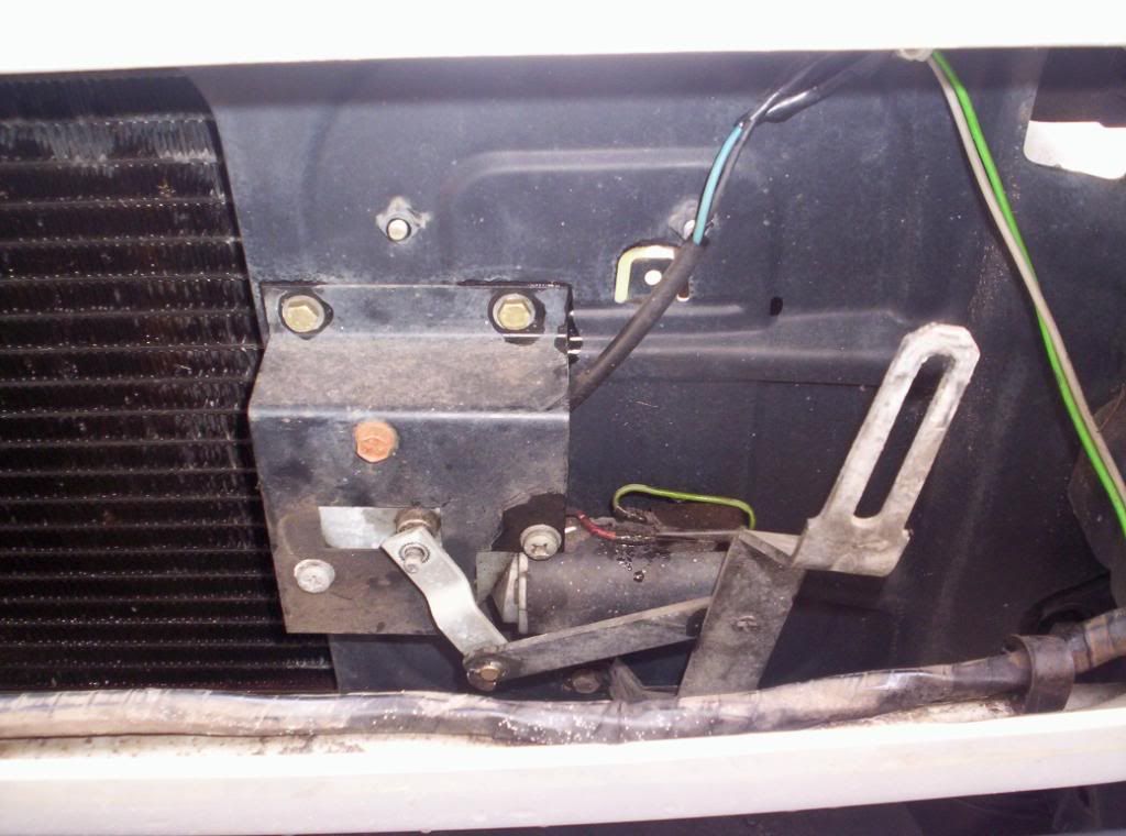

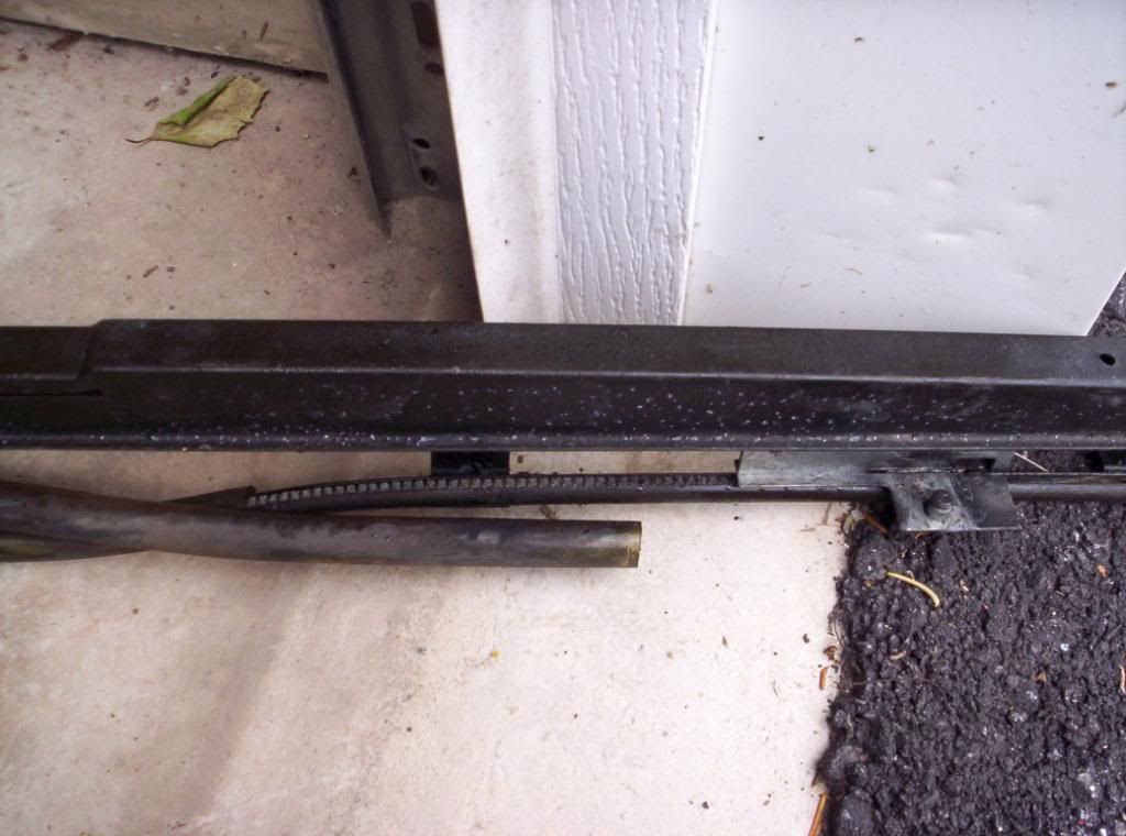

I seem to remember an inquiry as to the unique headlamp wiper system. Today I finally had some time to check it out and make some minor repairs to that system. It works perfectly now after replacing a bad section of wiring and the fuse.
Here are the photos:
Directly behind the grille is the support rail.
Inside the rail is the chain and chain rail which moves the wipers at either end.
The motor and pivot arm which attaches to the chain rail.
The entire working unit. The only time the wipers work is when the washers are used and they now work perfectly, just as designed.
