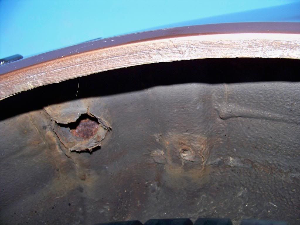

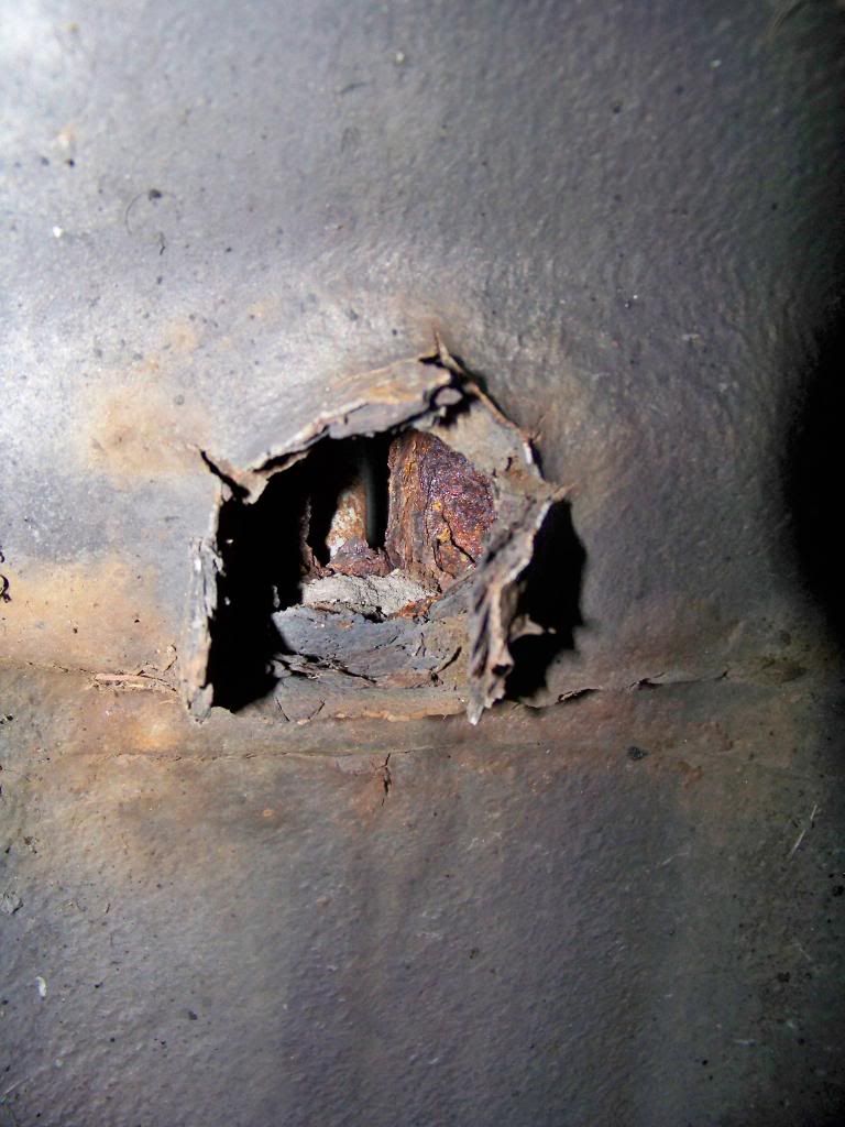

A few pics of the rust, the wheelarch. There was a rubber grommet/bung in here by the look of it.

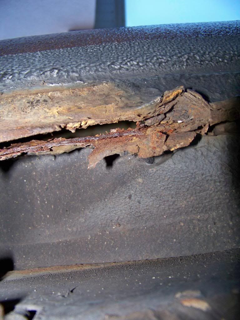

And the sill.

The sill looks fairly localised, but am I right in saying the jacking point is not there? You are going to need to remove most of the sill in the area and build it back out 1 layer at a time, aswell as build a new jacking point.
The inner wheel arch looks like the rear. That is also a difficult repair, I've done one of mine (missing bung caused it I think). The 'box' section will need to be removed (cut and the top part depaneled) and the wheel arch exposed inside the car (remove all trim), I think you are looking at a dinner plate sized repair in the shape of a dome, a bit of a 2D curve.

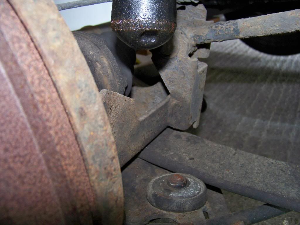

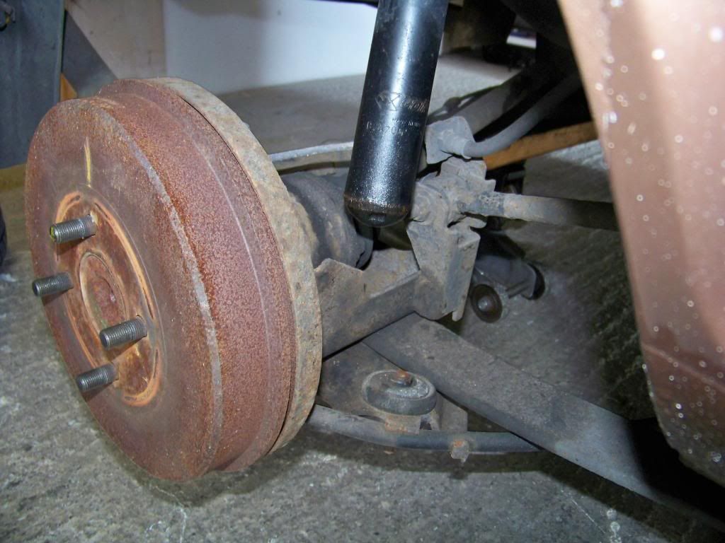

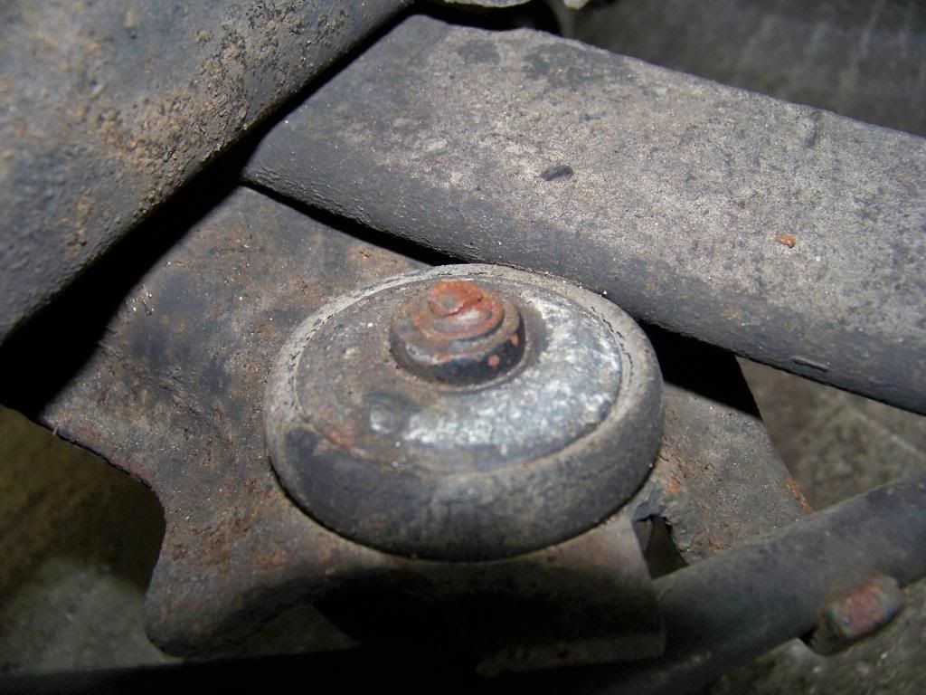

Thanks for the advice, the jacking point is fine, that split sill starts about 50mm forward of the rear jacking point, the jack point is fine. I used it tonight to raise that rear end up. The wheel is sitting at a bad angle, wheel bearing seems tight but the camber is around twice that of the other side. I understand this car has some degree of negative camber but this is obviously wrong and my spirit level agrees. Same side as the clunk is coming from.
As for the rust. I've poked and prodded at it a bit and it doesn't seem to extend too far inside. It looks as though someone has jacked the car on the sill causing damage. Possibly due to the jack handle being AWOL. The wheel arch is the rear bung missing. It gives me hope that the rest of the car is in good order. It certainly looks fine with a quick visual.

Its vaguely possible the bearing is damaged/collapsed. Jack it up and see if the bearing is loose. Either that or the axle is bent.

Well, I've found my knocking noise. :o
2 new shocks it is then, it wasn't apparent until I got it up in the air. :roll:
