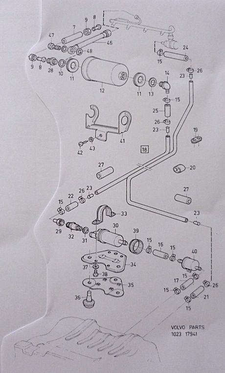

You might find these of help.
Make sure any hose and securing clips you use are suitable for fuel injection.
A carburettor fuel pump will deliver at about 3-4psi - your injection pump delivers at approx 36-40psi.
Mac
zack360
Posts: 227
Joined: 29 Apr 2013 03:27 am
Location: Malaysia - Kedah
Post by zack360 » 28 Jun 2014 08:08 pm
Goooolll..... thanks mac, this diagram should come first..make things easier.
