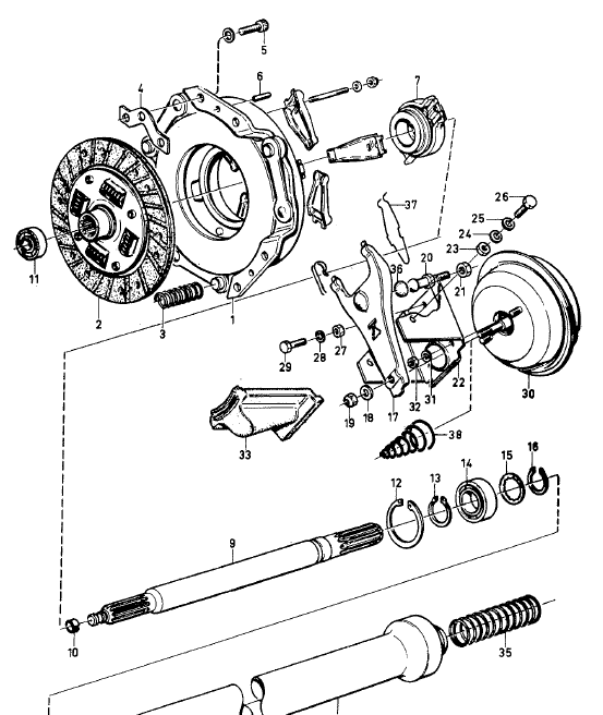

This morning I retreived some service papers from the service manuals which came with the car (The damn manuals are in Swedish Rich....I don't read Swedish. This is the reason I ask so many questions. :) )
The clutch in my 343 is not new, it (and bearing, springs as well as the pressure plate) was installed in 2004 at 73,000 Km (the car now has 77,348 Km on the clock). The CV boots, pads and shoes were also replaced in March,2004 along with the DECLUTCHING SERVO (??) at a "bodger shop" (a non Volvo Dealer) in Paradise, California......Now I am totally confused. :roll: :roll: :roll: :roll:

Indeed there is a "declutching servo" there, no 30 in the illustration.

Have you measured the 'clutch gap' correctly? You should do so here:
As we can't really tell if the clutch was replaced by a knowledgeable mechanic, measure the clutch gap at all three locations. All sets of shims should be of exactly the same thickness.
73kkm is not a lot for a Volvo 300 Series CVT clutch to be honest. With the correct maintenance (I think we've got the answer there) they last considerably longer.
As the bodger garage has tried to circumvent the starter inhibitor shortly after the clutch change, I can only assume that the clutch wasn't installed correctly in the first place. That can mean several things.
1) The clutch gap was set incorrectly, see above.
2) The clutch was refurbished with material that has very quickly come loose - the effect is the same as when the linings on the older Daf clutch shoes 'part ways' ;)
3) Since the bell housing has to come off for a clutch change, along with the pressure plate, the whole assembly may have been reinstalled incorrectly.
4) Other defects.
Everything after point 1) requires the lot to be removed. If that is the case, I'd take it out completely and rebuild it according to the books. You can do so with the engine in situ, but removing the engine alltogether could be a faster and easier process.

Hi John,
Been following this thread with interest.
If I read things correctly, a degree of creative bogerey has taken place to try to overcome
partial or full clutch engagement at idle speed (which is correctly set ). This took place just
after a replacement clutch was fitted.
Question one - is the clutch drag present in all gear positions ?
2. - does the idle speed remain at 700-800 rpm in all gear positions ?
Obvious suspicion is that "incorrect" fitting of the new clutch is root cause - this would generally
be an adjustment fault, incorrect centre plate, failure to ensure the disengage fingers are
correctly aligned or failure to ensure the friction plate is a free sliding fit on the clutch shaft
splines. Most non Volvo/Daf mechanics measure and adjust clutch clearance between cover plate
and flywheel (not between friction lining and f/wheel) leading to just the situation you have.
Possibles - damage to c/shaft, seized spigot bearing, gear selection (operates de-clutch servo)
causing an air leak into inlet manifold with an unnoticed rise in idle speed, foreign object between
friction plate and flywheel (shim perhaps). Whatever the cause I suspect it will be simple and mechanical
(all the extra de-clutch gubbins is designed to allow engagement at high idle (1100+) during cold start
(by delaying the point at which the centrifugal cover plate engages).
Chances are it will mean a "take apart and put together properly job"

Thanks for the insight MAC...I was hoping it would not come to a "take out" but, as you said; "a non DAF/Volvo mechanic". I am beginning to beleive this is the case here considering all the BODGING which I have removed so far. :(
To answer your questions;
1. only in the Park position.
2. Engine revs remains the same in all "gears" with normal fluxuation when brake and hill brake are applied.
