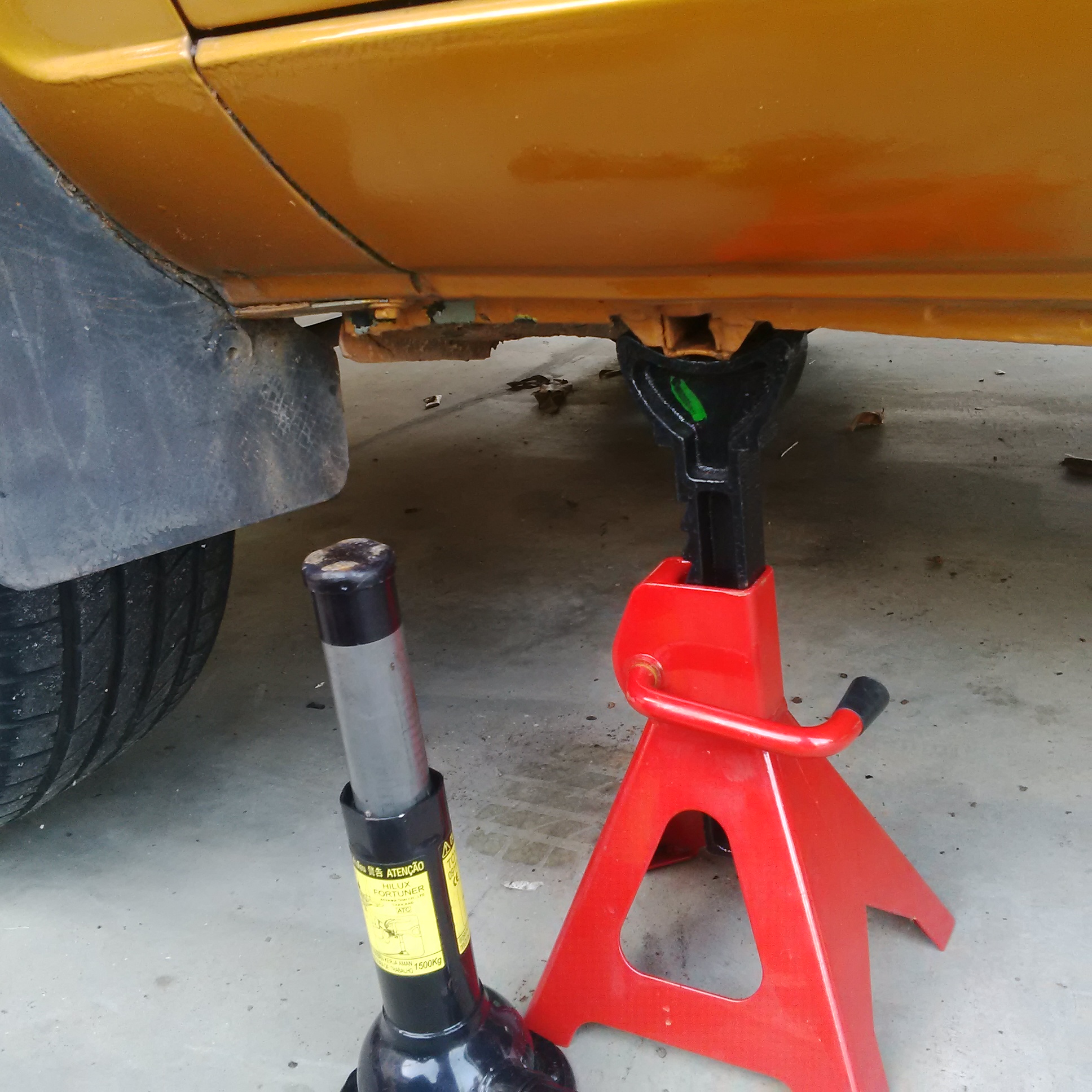

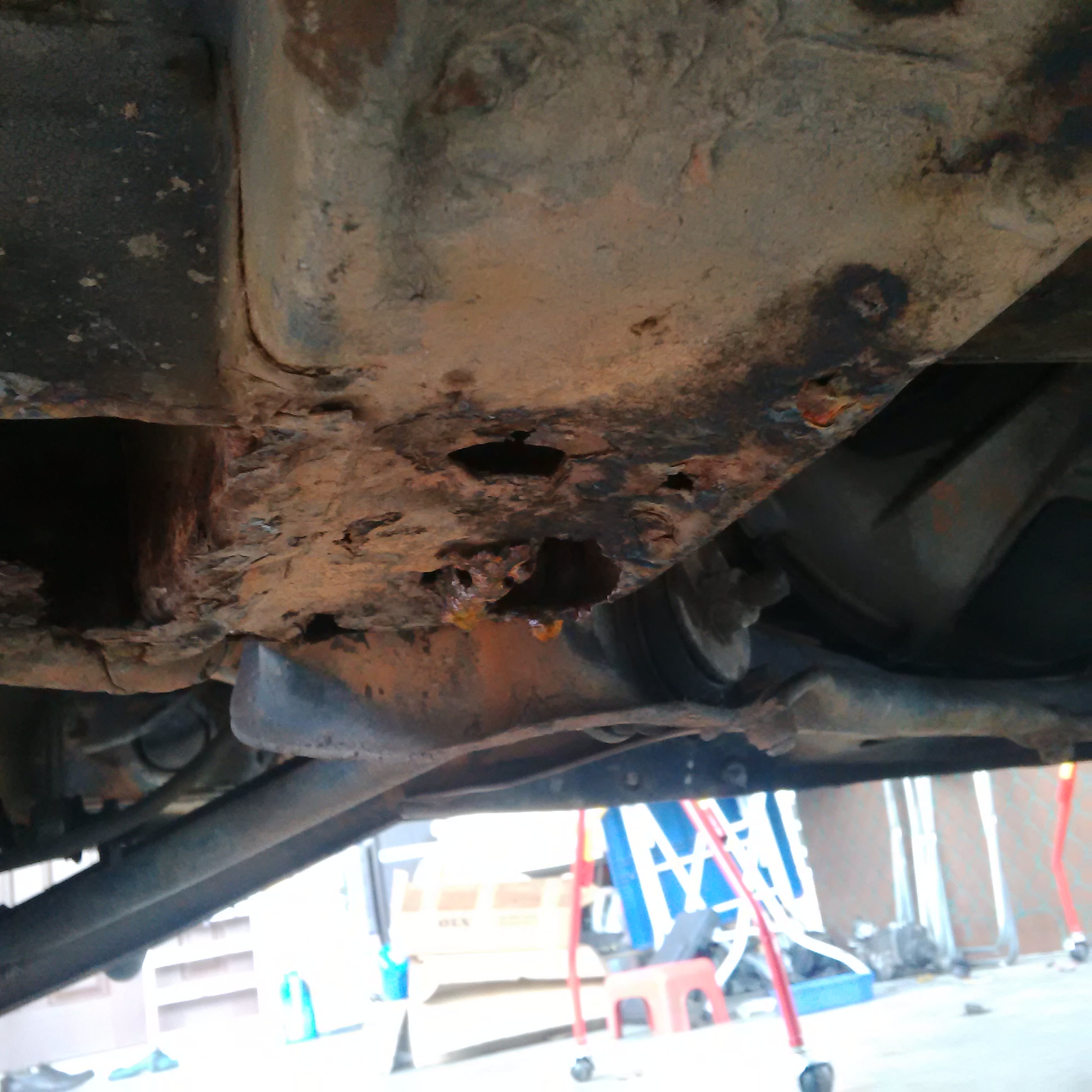

Hello Mac, the parcel still not reach me yet. I think by next week i'll received it. Finally i talked to the guy that sold me the PAS, interesting he said it was taken out from 360. I need to jack the car up and uninstall the stock rack. need to remove the tyre first right? But i have problem to jack the car is other jacking point because, i'm afraid the body cannot sustain the weight of the car. The car had been infected by rust..on some area.

I find it hard to believe the rack came off a 360 - the mountings are all wrong and I don't think there is room for the external servo that acts on the track rod. But I'm happy to be proved wrong - could be some sort of aftermarket conversion I suppose - definitely not Volvo though - I still go for a Citroen Xantia!.
You can jack up on the front axle beam and use stands to support the car on the main chassis rails (box sections) that run inboard of the sills. If the OE jacking points are rusted the sill may collapse if you lift there.

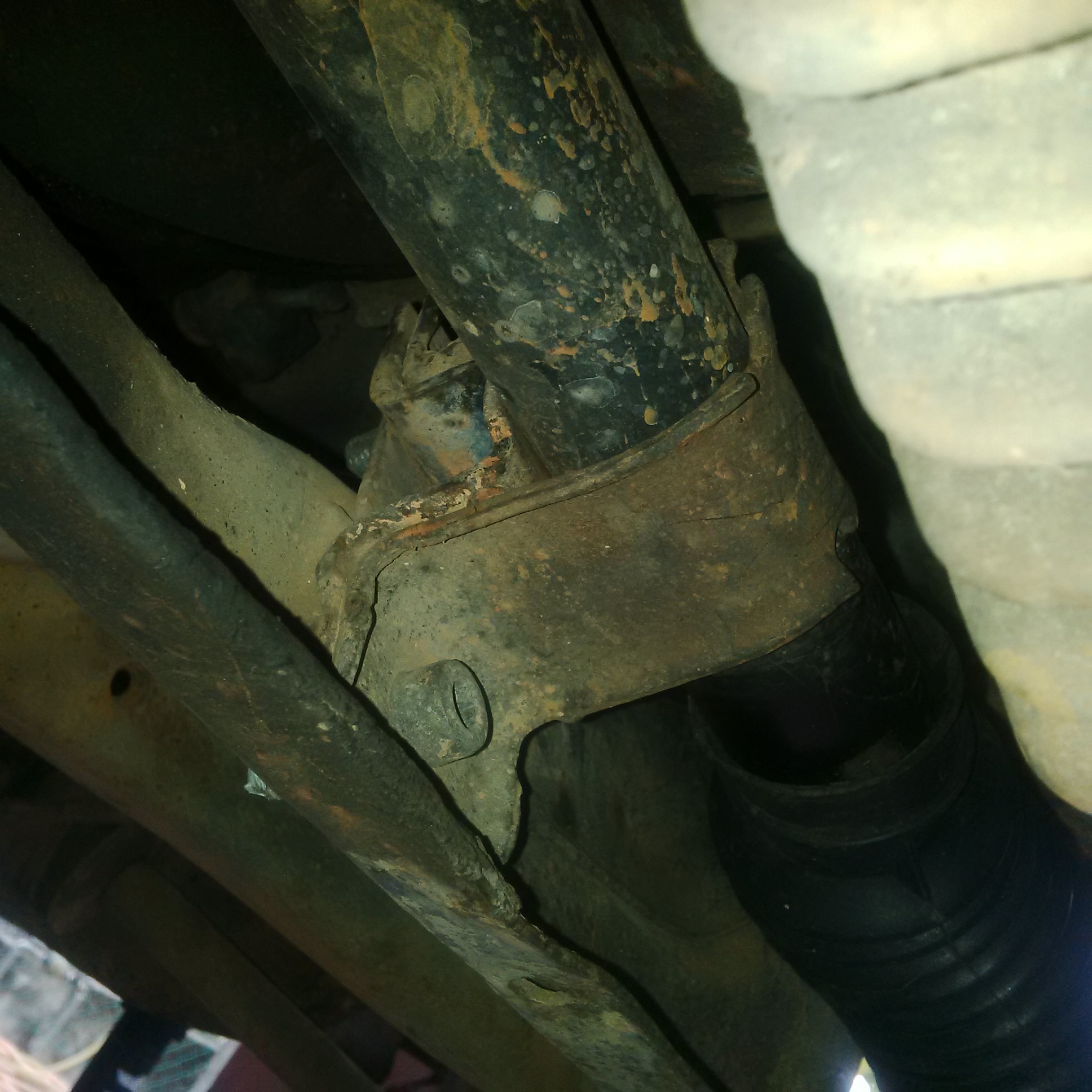

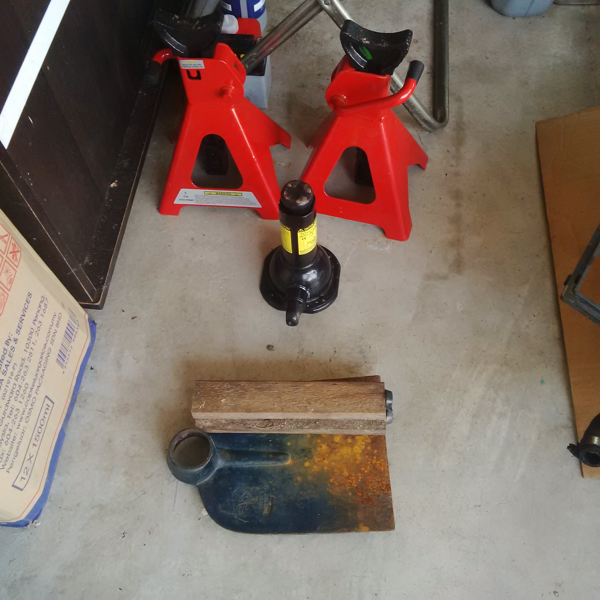

Ok mac, today, I manage to jack the car, and remove the front tyre, but, there is only one bolt on Right Tyre that is so stubborn that, my wrench bend a bit. As of the rack, looks like a lot nuts need to be removed, need advice guys. Hey mchudd, did you send me the bumper bracket? The grill came without badge sm2 .. do you have extra? I have the old one but, it's word badly.
The screw on the upper side is very difficult to remove
Rust pretty bad
Jack on the left next on the right of body
Tools of trade
