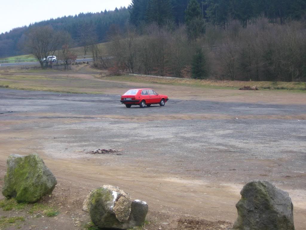

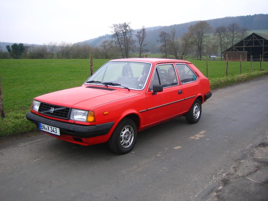

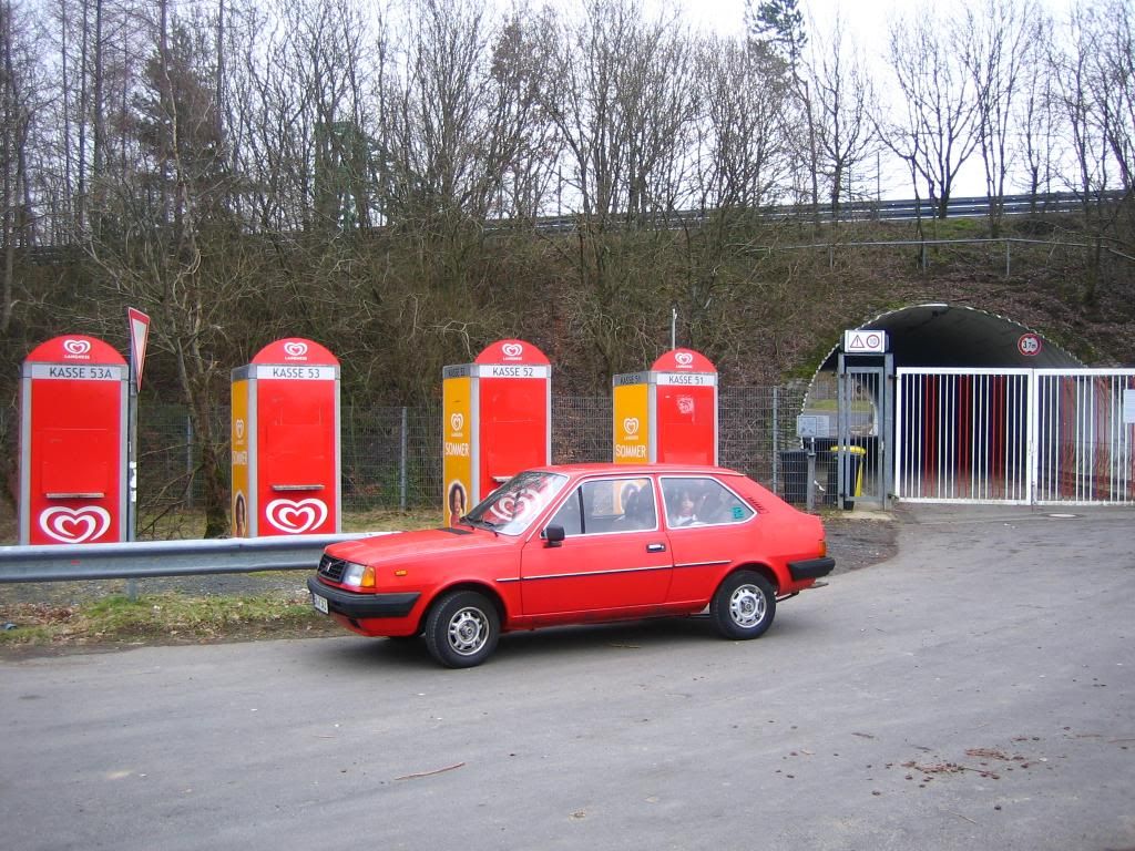

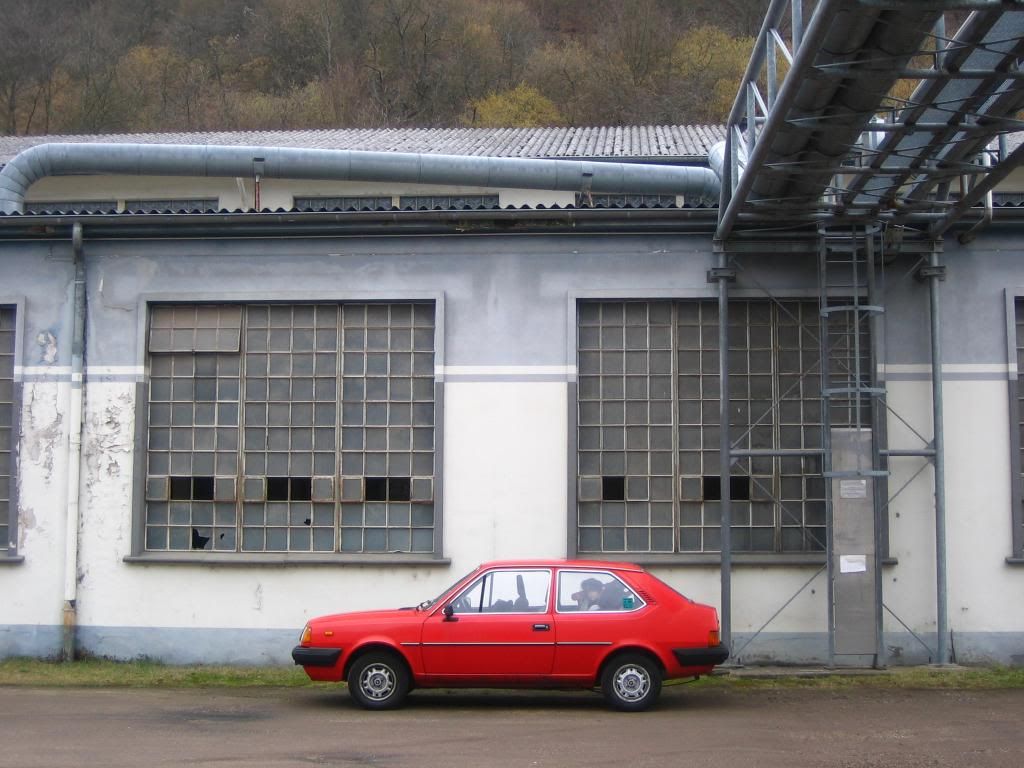

That was fun :-)
Did about 120kms today, the first real run the car's had in a year and a half ... It goes really well, torquey pull at low revs, great exhaust noise, and all feels nice and tight - not like my daily 360 with over double the mileage.

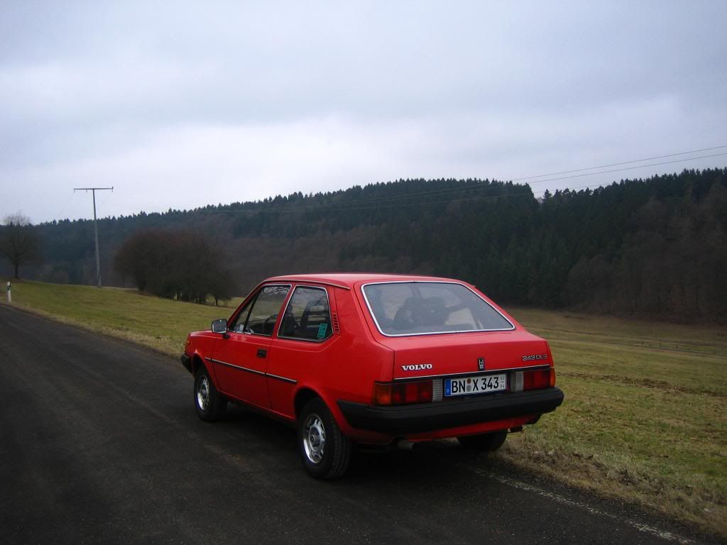

Post by SteveP » 20 Feb 2011 12:53 am
Great news and great pics, especially the last one! Nice trim rings ;)

Post by nvdw » 20 Feb 2011 01:03 am
GR8 NUMBERPL8.
There's a surprising amount of chrome on this car; it's just the front that's purely pov spec!

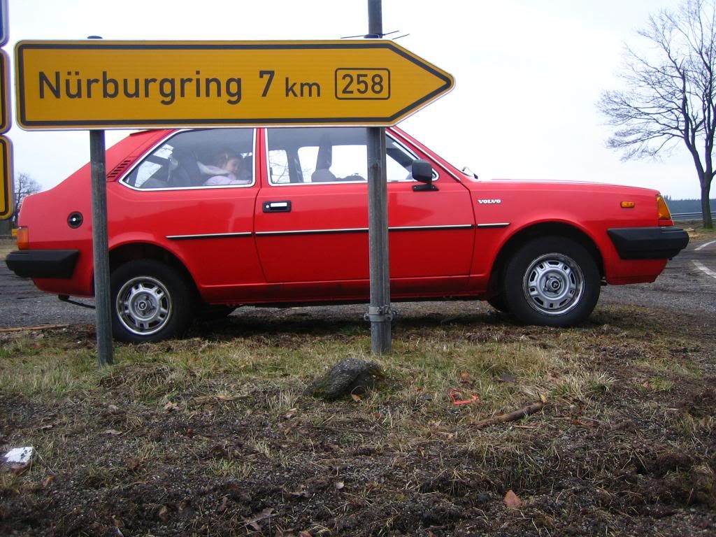

Post by volvosneverdie » 20 Feb 2011 10:40 am
Baby seats, in a 3 door, at the Nerburgring.
Tom is hardcore. 8)

Post by V6 Man » 20 Feb 2011 11:31 am
trabitom99 wrote:Image
Some say she has no fear of cupboards, and that she once wrestled a duvet and won - all we know she's called Baby Stig!
