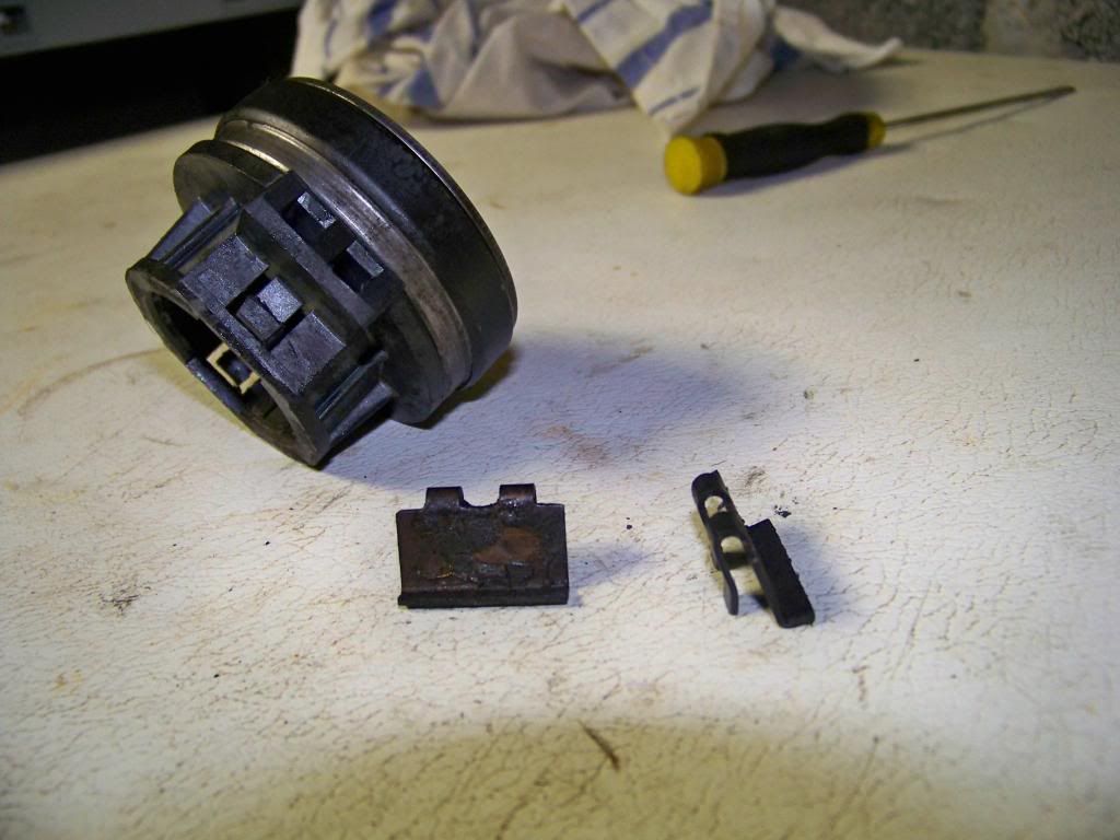

OK, I have to admit partial defeat. On reassembly I cannot work out if I have done this right. Haynes says to press the old bush off the guide sleeve in the clutch housing if it is worn. I see no bush. The thrust bearing is not the same as the one I took out. Well, it is but the old one had two metal springs/plates. This bearing won't fit in the release arm with them swapped over but when not fitted I can pull the release bearing off the release arm with little force. Can't for the life of me work out which way the spring goes back on the pivot pin.. Any advice guys?
Many thanks.
Pics of the plates/springs I removed from the old bearing, should they be transferred onto this one?
Many thanks.

Go to the V3M TECHNICAL forum ‹ Technical resources & information ‹ Green books
http://www.volvo300mania.com/forum-uk/v ... =36&t=7262
and download the manual transmission PDF. Jump to P28.
Those clips in the foreground look like they go on that bearing.

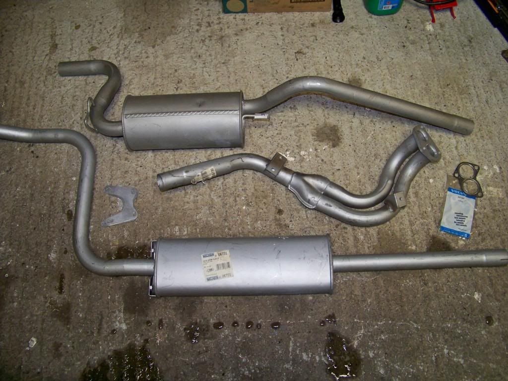

Now, time to crack on. Have finally got delivery of my new exhaust. €72 for the lot including gasket. Very happy with this.
Now I am back in business. Have a slow puncture to deal with but she'll be getting 4 new tyres soon enough. I am not getting the engine out yet. Have to get her on the road and doing the clutch nearly killed me. Feeling old. Just want to get this exhaust dry fitted to get her started so I can investigate if the rumble is gone. Would never have heard it without it. Ordered a new carb diaphragm which should be here in the next few days and will hopefully sort the chugging.

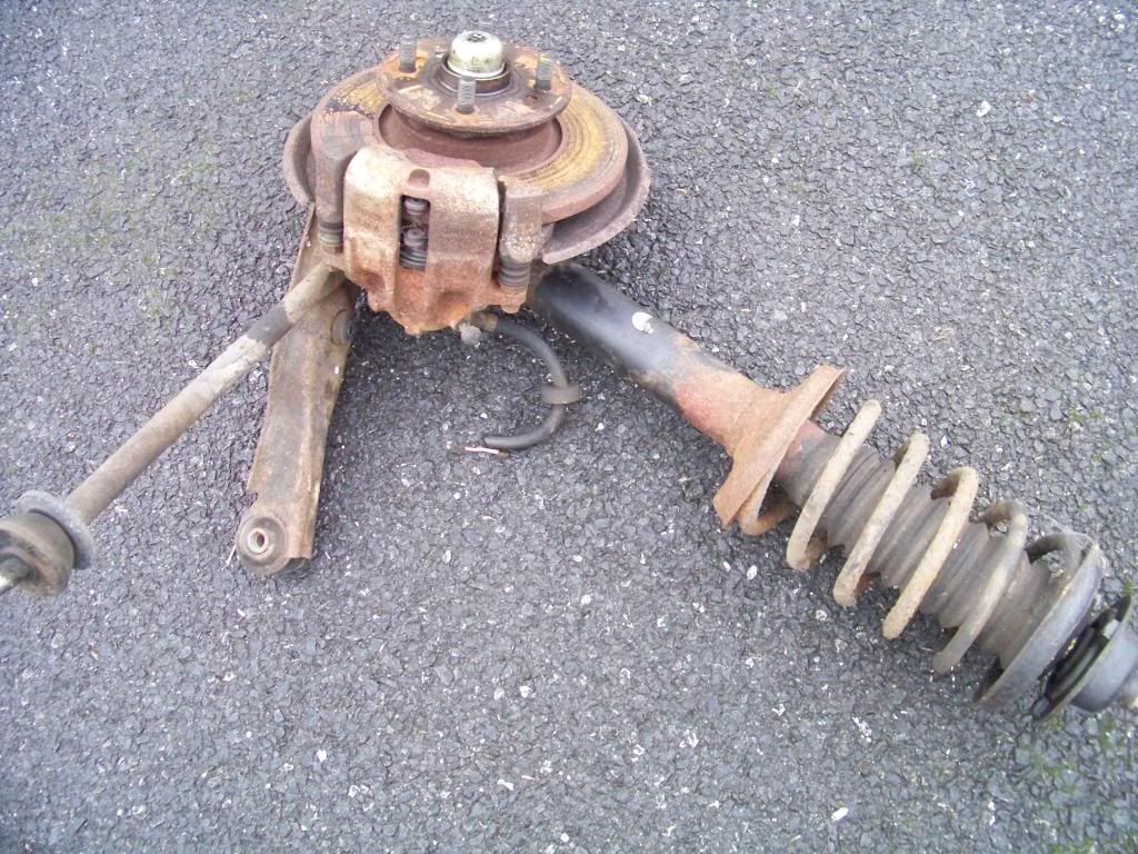

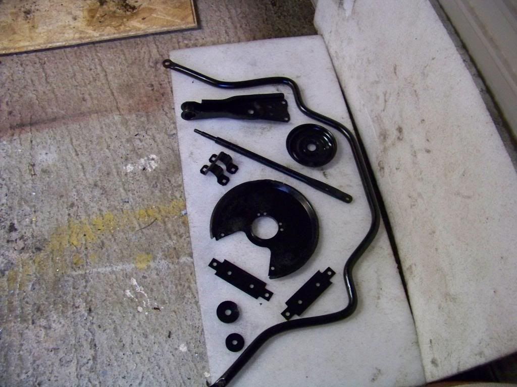

Not much fun at the moment. Waiting on a few bits and bobs. Caliper seals, bearings for the struts, balljoints and a bolt kit and wheel bearings. In the meantime, a bit of housekeeping.
The rear disc plates are shot really but they'll do for now until I find replacements, top mounts are good but the bearings need replaced. Calipers in good order but need a new set of dust covers and a new seal won't hurt. New poly bushes going on and Dai's lowering springs will finish the job. Doing the wheel bearings just as a precaution. Don't want to have to touch this for a few years.

Re: Hello. (New member) I brought pics!

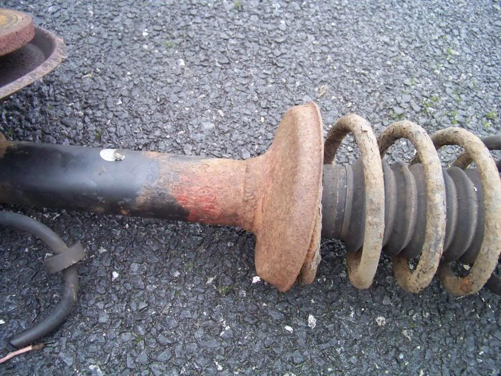

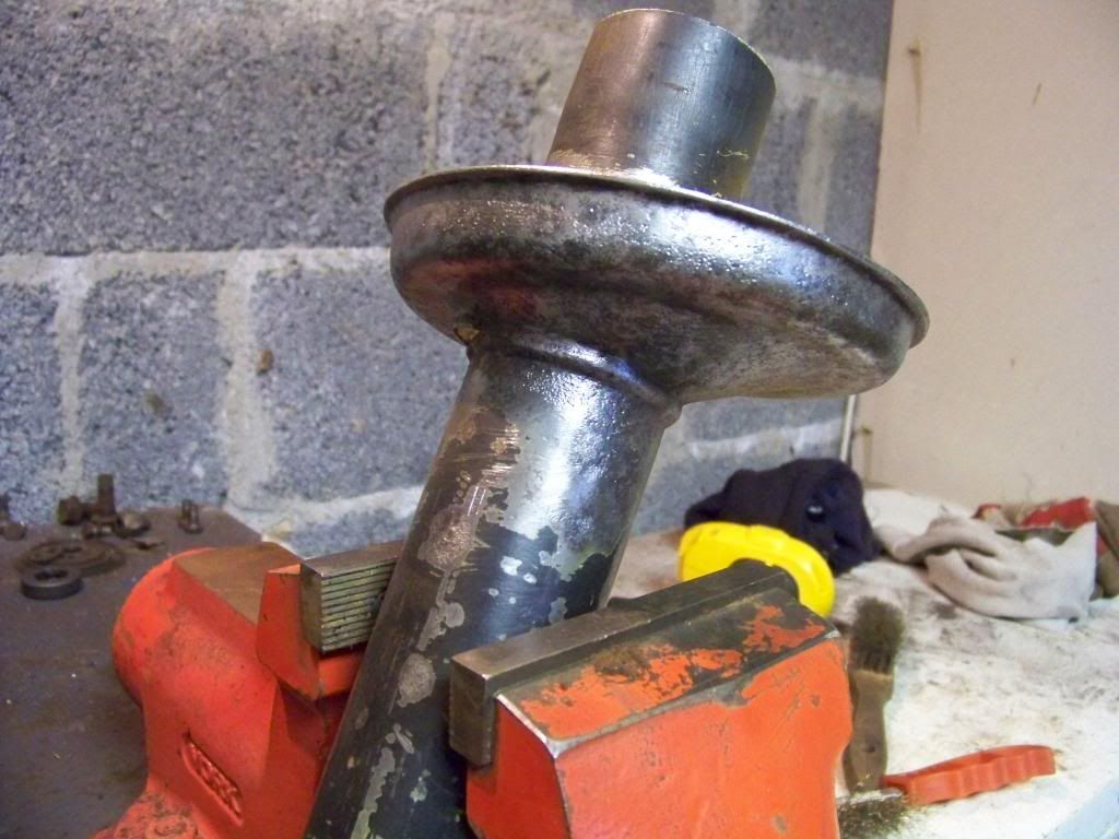

The weather is awful here, we have lost two trees in the garden. Roads are deathtraps with debris everywhere and the power is coming on and off all day. Still, nobody hurt and only superficial damage. As you say, others have it much worse. Last night we were trying to watch argo but the howling from the wind in the chimney made it impossible. Plus the power kept going off, resetting my home theater pc.
Managed to get the strut primed last night though. Off to give it a coat of black now. No rush on the torque tube. As you can see I have plenty to keep me busy at the moment.

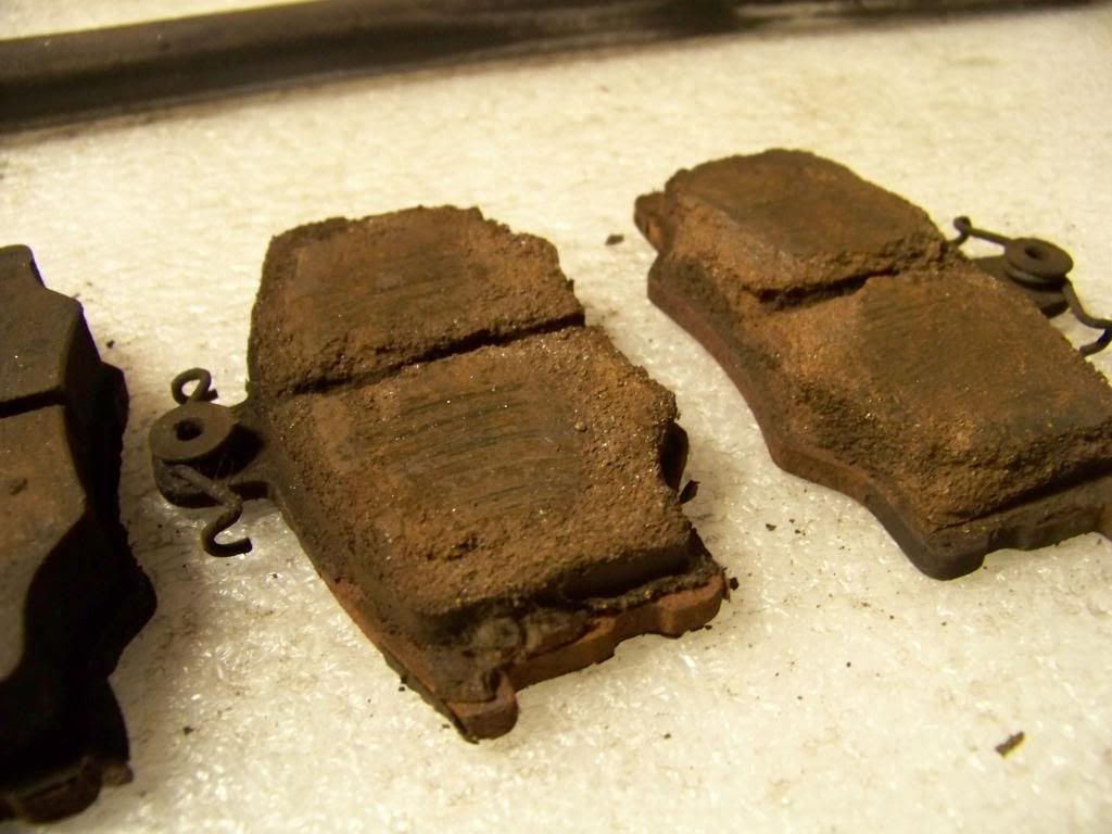

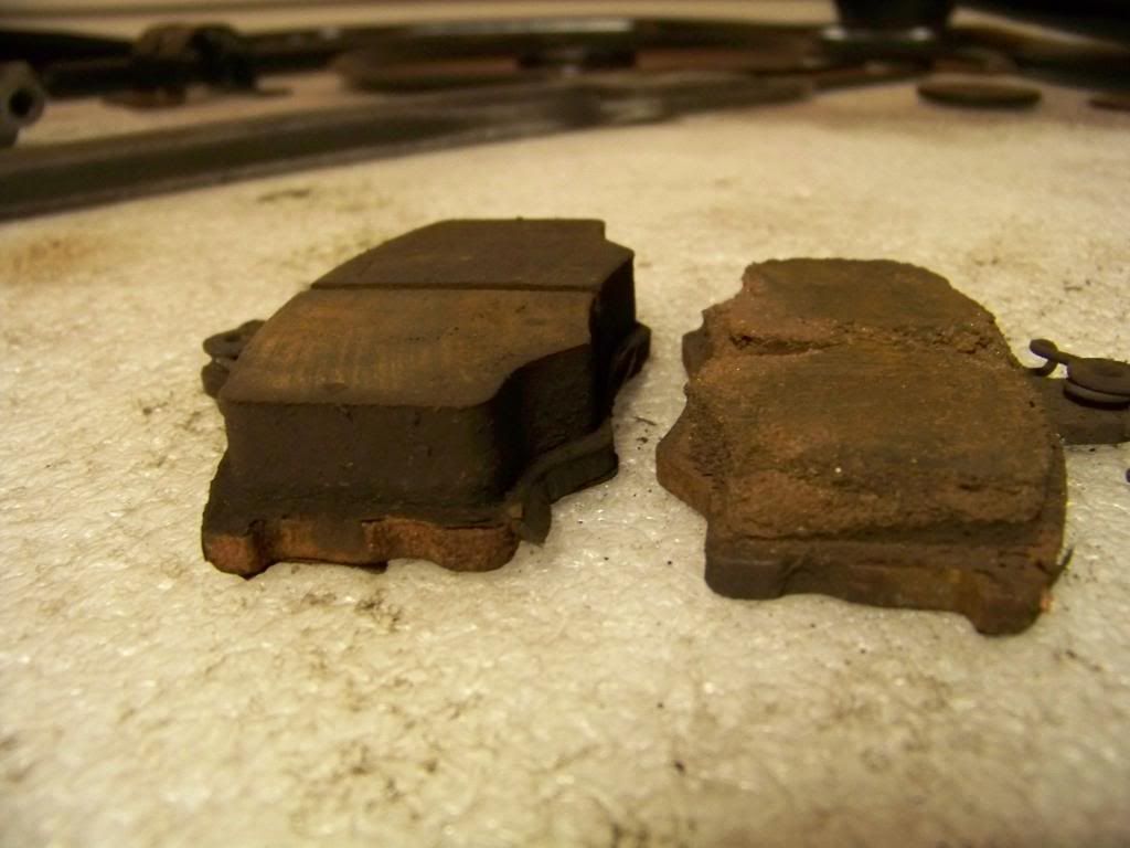

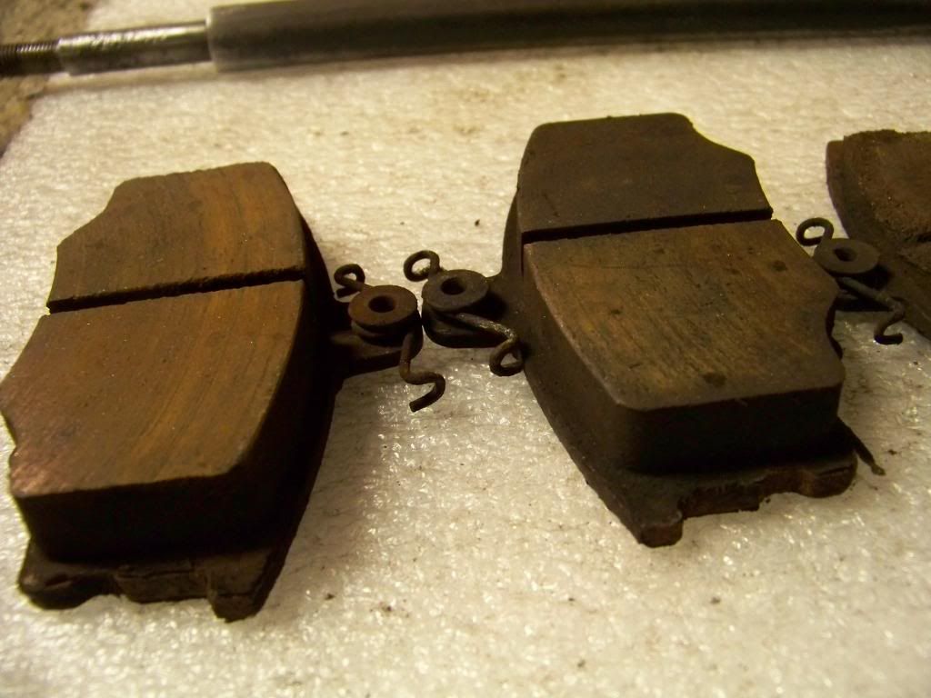

Hahaha, stunning!
I've bought similar, I've no idea how people think replacing half a cars brakes is sensible.
