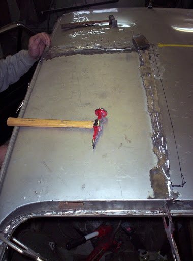

I'm back....with a quick update on "MARILYN"
Last week the Type 1 V343 was driven to the body shop along with the replacement roof bit.
It was not long before a rather large chunk was surgically removed in preparation for the re-build.
Once the damaged bit was removed most of the metal stress was relieved and everything went back into alignment quickly.
Today the new panel is being prepared so that there will be plenty of overlap on all skins before welding.
John

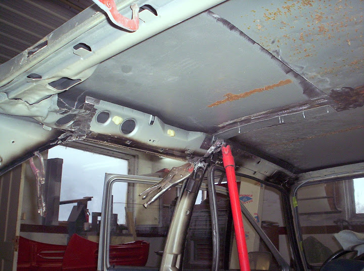

Re: Hello All...
Progress is a wonderful thing.
After many hours of fitting, cutting, measuring and cutting some more I was called to the body shop with a few bits to give my final approval on the fit...
We had to make sure there was at least a 5 cm to 10 cm overlap on all interior as well as exterior panels before anything was permanently secured in order to maintain the integrity.
Within the next few days everything will be spot welded in before the final seam welding.

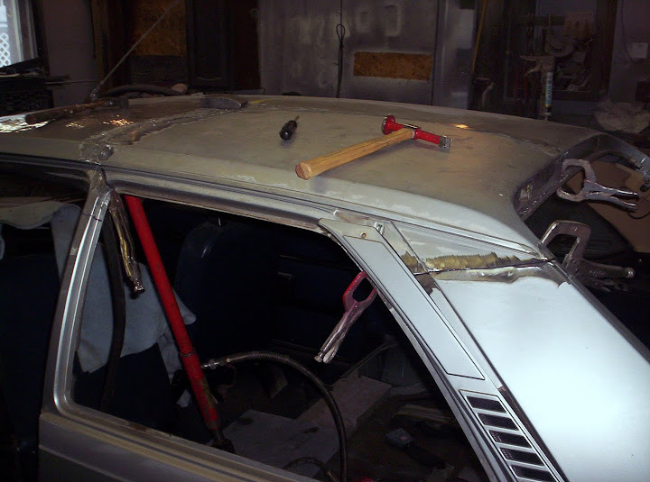

Re: Hello All...
Yesterday all the welding was completed so this morning all seams were sealed, interior roof support was glued and bolted back in as well as a first skim coat of filler to the roof.
We are just waiting until the urethane sets up on the inside support before going any further.
Hopefully by the beginning of next week we can replace the hatch and side window.
John
