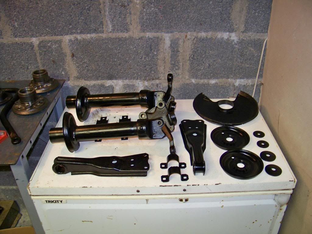

No updates for a while, have been busy though. If I ever see another wire brush, bit of sandpaper, scotch pad or dust mask it will be too soon! Still a long way to go but I think I am ready to rebuild the front suspension. YAY. sm23
Just the rest of the car to go, sm25

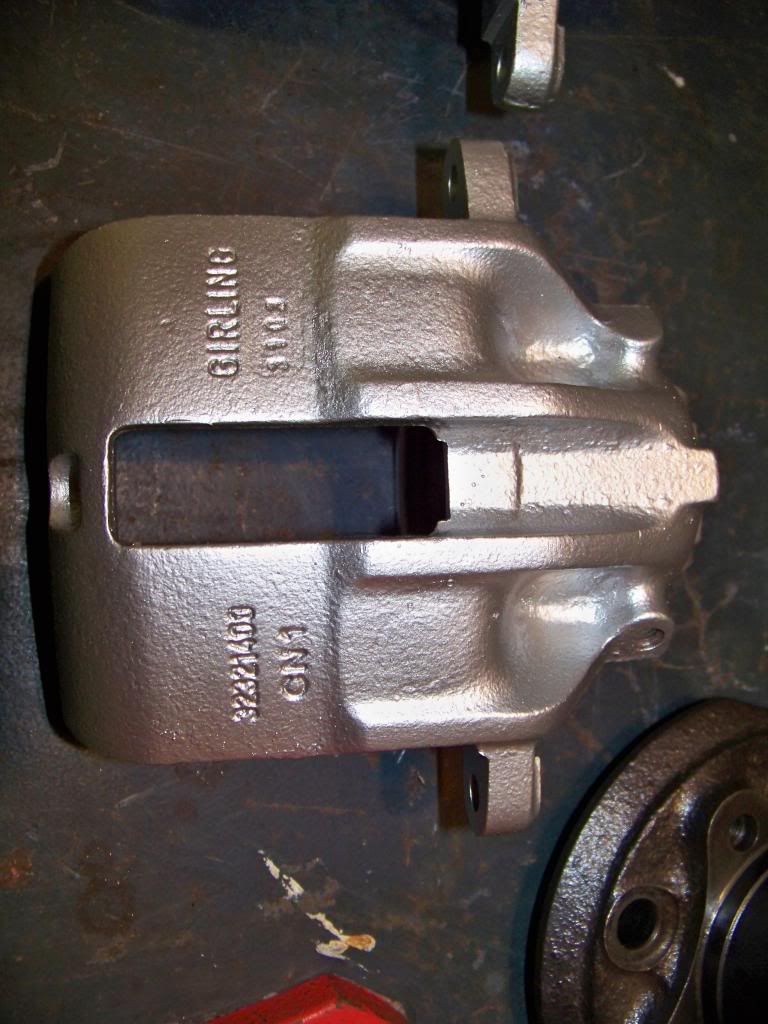

Mighty fed up of rust, time for the good stuff. Better go and get the calipers out of the oven before the other half comes home from the shops. sm7

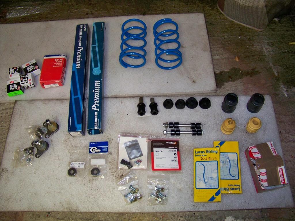

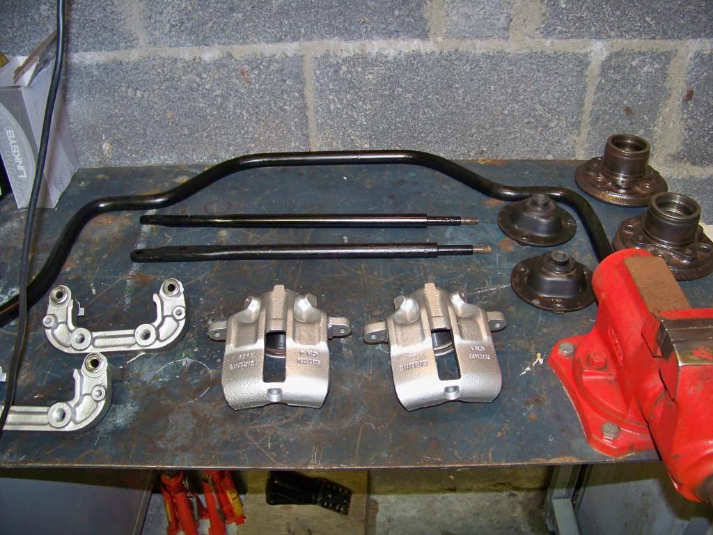

This is the bit I enjoy, everything laid out ready for re-assembly, well, almost everything. Need to change two ARB bushes as I bought the wrong size. Waiting for new discs and two tie rods as I can't free the old track rod ends. I'm going cheap and cheerful on this, most of the new stuff is old stock, the brake pads cost the princely sum of £1.99. :D
New shocks, cheap ones, new top bearings but the rubber mounts are ok to re-use. New ball joints, lowering springs, brake hoses, new caliper pistons and new seals and dust covers, front bearings, bump stops and a complete set of Dai's polyurethane bushes and a set of Macs bolts.
Did my best with the old components. Sick of looking at them, not too happy with the rust removal and I know it will be back through the new paint soon enough but I just can't put dirty rusty stuff back on the car.
Very happy with the calipers though, these were filthy rusty and a real pain in the hole, days of wire brushing later and lots of faffing and a tin of caliper paint (plus 30 minutes at gas mark 4) to get them to this state.

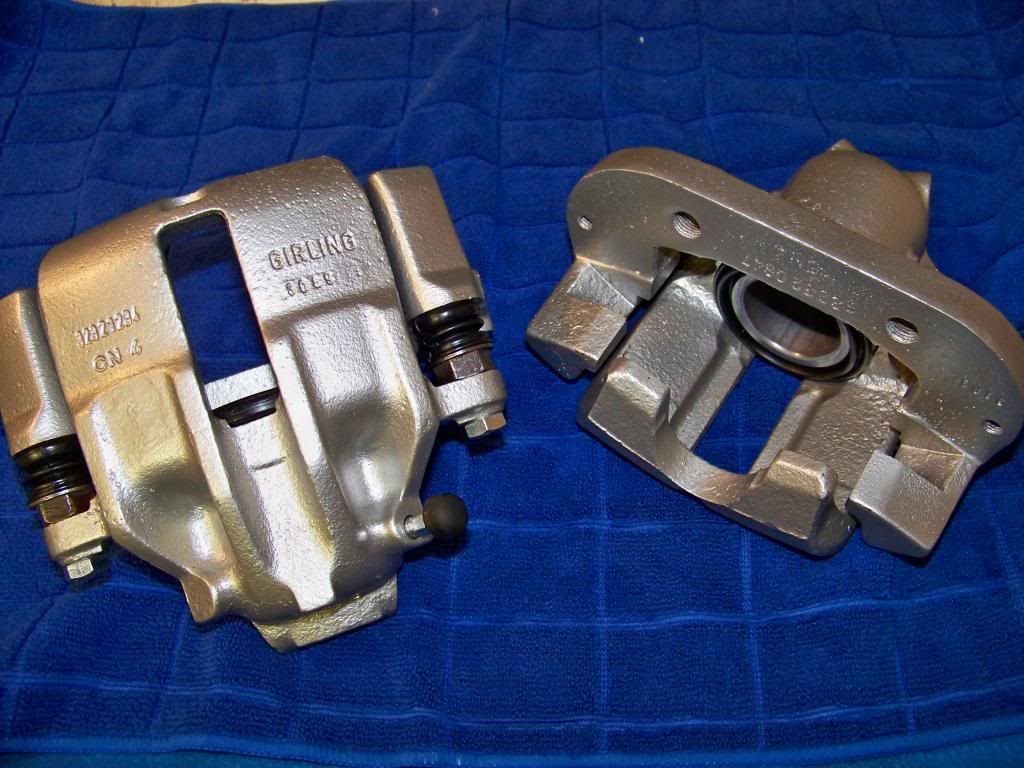

Very happy with these, first time I've messed with calipers. I want to frame these, it will be a shame to have to put them under the car to get dirty again. :D

They look brand spanking new, good job. I too am loving the cheap 'new old stock' stuff on ebay. 99p ferodo pads and 3.50 for a pair of rear cylinders :)
Under the bench grinders wire wheel at work it took about 15 mins to take off the rust etc off my calipers ... I dont know that id have the patience to give them 'days of wire brushing', youre a better man than I 8)

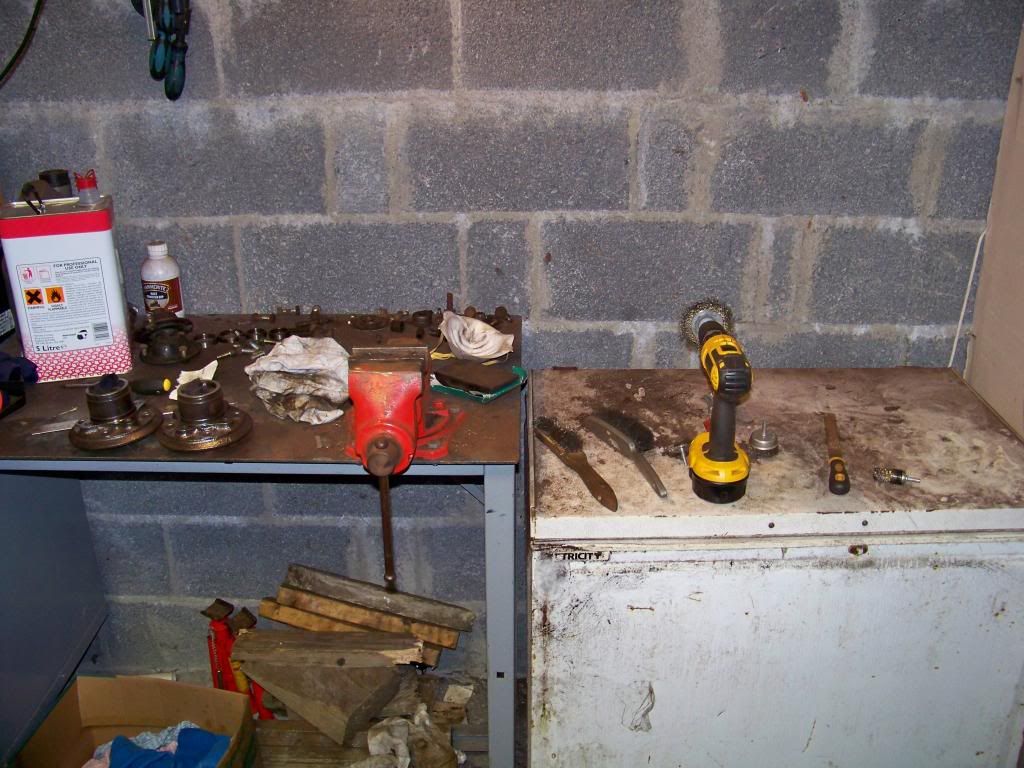

P.S. What are the two top row middle pieces and the bottom piece in the second picture? I'm assuming this is a different engine?

Top two = rear engine mount brackets, bottom is front engine mount upper support bar for post 85 B14s.
