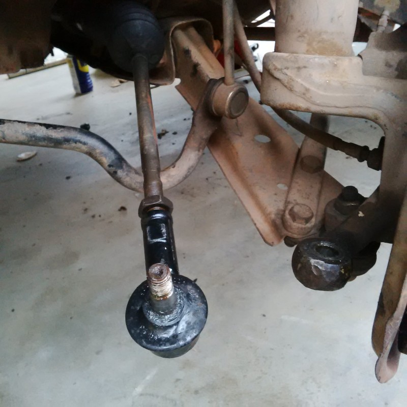

Post by zack360 » 17 Jul 2014 02:01 pm

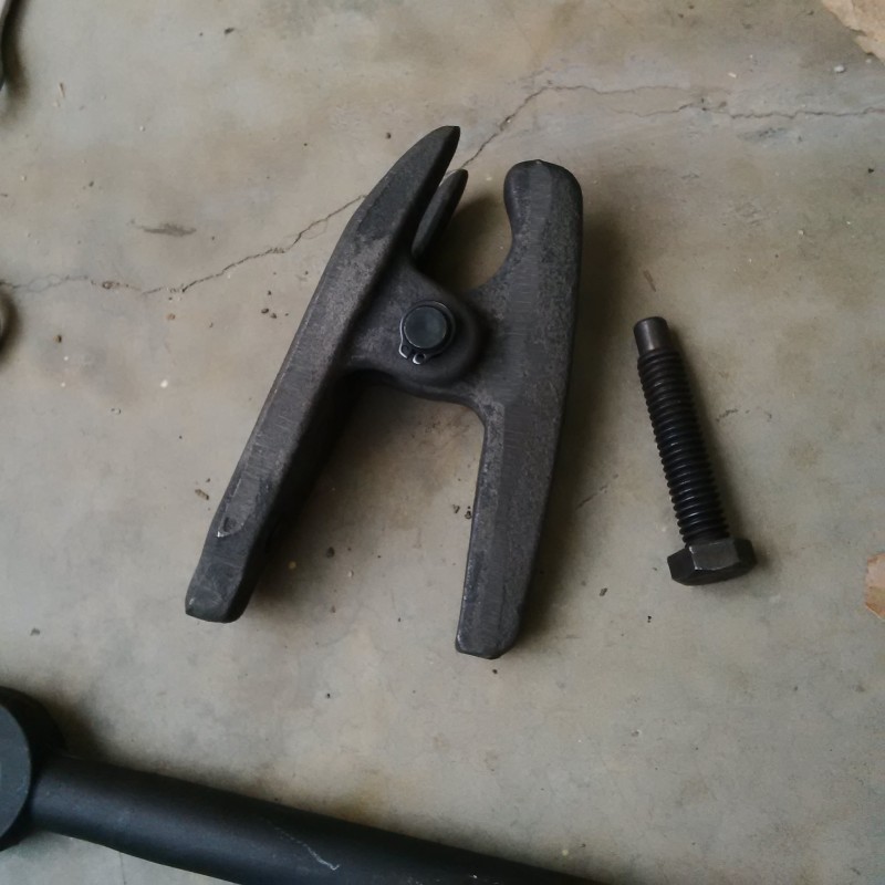

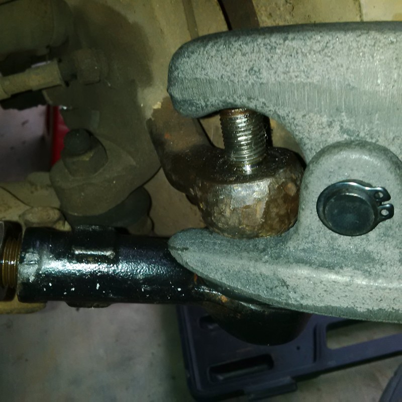

Hi guys, today, I finally at last able to pop out the tie rod end using special tool, that I bought, not so long ago.. the fork will have to wait another day..a bit tricky when loosen it counterclock wise. Only left is the screw that hold the rack and the pinion. Do I have to loose the one coupling inside the car or from out side..
Thanks guys
Zack
Fork meet your cousin..
£5 only.. made in china.
This is how I put it
Right Hand Side
Left hand side poped out

Joris
Posts: 147
Joined: 13 Nov 2013 02:43 pm

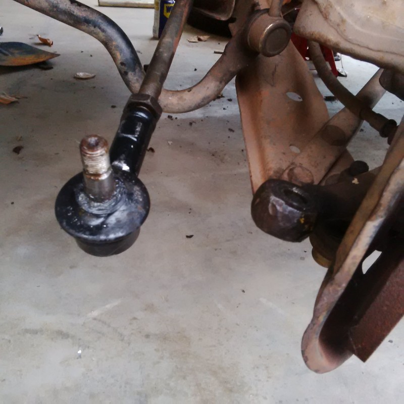

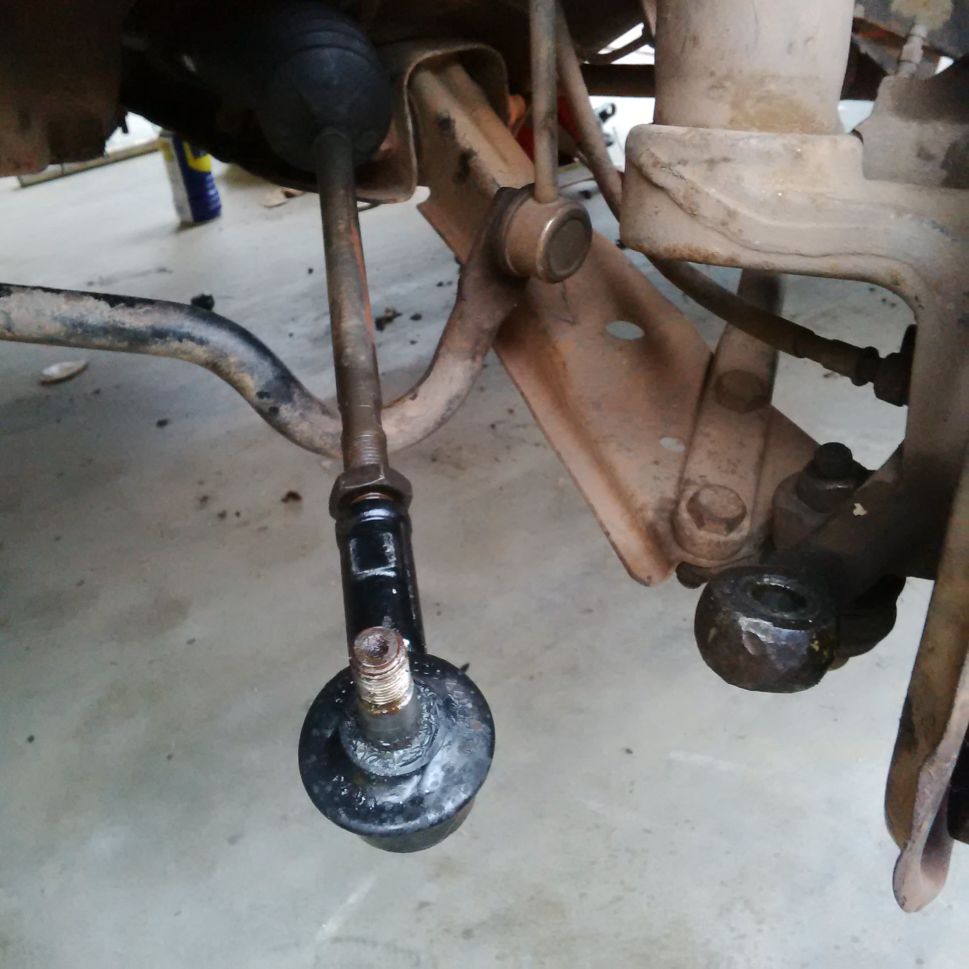

Post by Joris » 17 Jul 2014 04:15 pm
I could be mistaking but isn't your sway bar the wrong way up?
zack360
Posts: 227
Joined: 29 Apr 2013 03:27 am
Location: Malaysia - Kedah
Post by zack360 » 17 Jul 2014 05:10 pm
I'm not sure, looks fine to me. What should I do?

zack360
Posts: 227
Post by zack360 » 17 Jul 2014 06:05 pm
Confirm by my mate.. it's wrongly installed. Thanks.

Posts: 1863
Post by bogbasic » 17 Jul 2014 06:35 pm
There's a nice nipple on that calliper.
Logan360
Posts: 848
Joined: 23 Jun 2012 08:51 am
Post by Logan360 » 17 Jul 2014 08:17 pm
it is downside up. how odd.

zack360
Posts: 227
Post by zack360 » 18 Jul 2014 03:33 am
I think this the main reason why my steering feels so heavy.. :?:

zack360
Posts: 227
Post by zack360 » 18 Jul 2014 12:54 pm
Thanks for the info joris

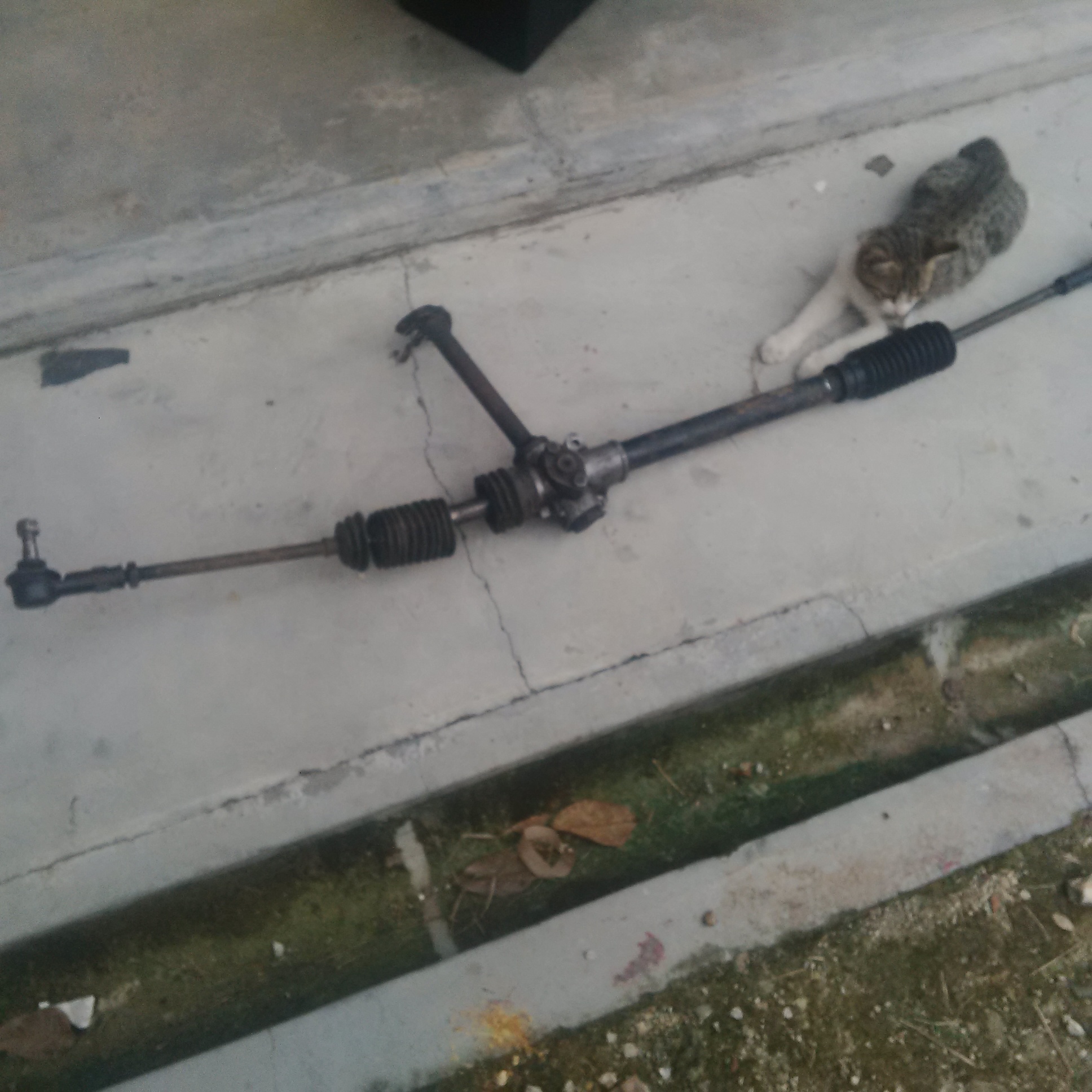

zack360
Posts: 227

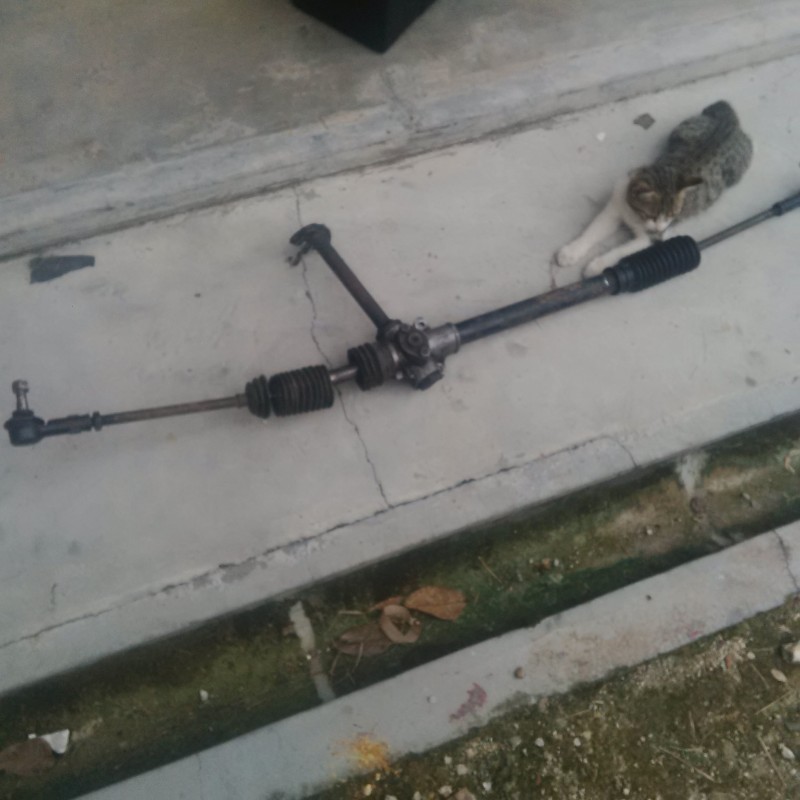

Post by zack360 » 21 Jul 2014 08:55 pm
Finally, got it removed. Now, need to find a power steering set, the one I got is not compatible. I use a box socket with Allen key number six to remove it. Before that I need to remove the coupling above the joint, it have 4 number 13 screws and nuts. The rubber was torn and beat up badly. Need to replace this as well.

mac
Posts: 1403
Joined: 19 Apr 2006 11:02 am
Location: Needham Market U.K.
Post by mac » 21 Jul 2014 09:07 pm
Zack, you'll be pleased to learn that the power rack does not use the the composite rubber disc/flexible joint (it uses a UJ)
If you look at the parts listings and diagrams I sent you they will show the differences between the manual (excl.p.s.) and power (p.s.) systems.
When you find a car to "rob" get the lower column with all the joints as well.
The parts diagrams will also show you what things should look like and the lists show the quantity of bolts etc.
Mac.

mac
Posts: 1403
Post by mac » 21 Jul 2014 10:14 pm
Anti sway bar is specific to 360 - 240 will definitely not fit.
Bushes can still be found in the UK however.
If you can find a donor 360 for the rack it may still have it's sway bar.
Mac.
Posts: 1863
Post by bogbasic » 21 Jul 2014 11:26 pm
The cat is an absolute darling.
