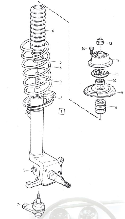

+1foggyjames wrote:Around 1986 the ARB mounting (on 360s) moved to being on the strut. So...make sure you get struts for a ~1986+ 360 (doesn't have to be a GLT) with the ARB link arm brackets fitted.
Here're are the pics from the parts catalogue (CH 121000- is MY 1986 on):
AUS = Australia
MAL = Malaysia
RI = ??
I've never quite understood why there is no Volvo part no. for a GLT spring - someone once said they might have been cut at the factory

Strut legs were sold "in one piece" from the factory, but a spring pan may have been welded in later (just as in the pic I posted on the previous page, that's the welded strut on my daily 360).
