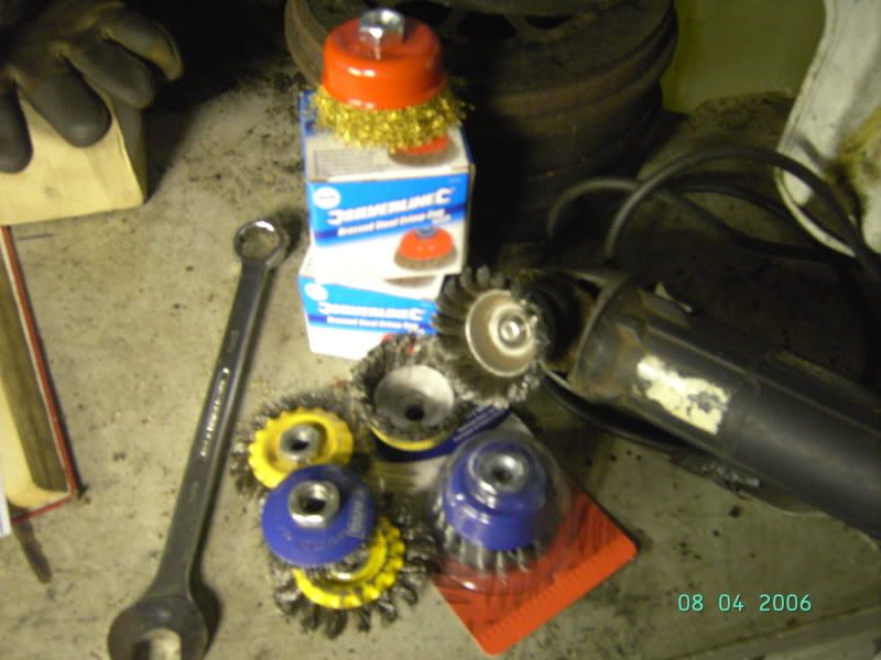

Fuse wrote:Very good results for mechanical cleaning! May I ask what did you use? Wire brush disc on an angle grinder or what? I'll have some similiar stuff to do on some sections on the floor and the compressor isn't large enough for sandblasting so I'll have to do with mechanical cleaning for now.
Cheers! Yeah, wire brushes in the angle grinder so far. (Pics below) For the harder to reach areas I will use a drill wire brush and something like Krust or De-ox gel. This is a time consuming way, but superior to (a hobby) sandblaster IMO. On other cars in the past I have used a heat gun/blow torch and scraper, but I hate the smell and smoke, plus you still need to go over the area with the drill/grinder afterwards.

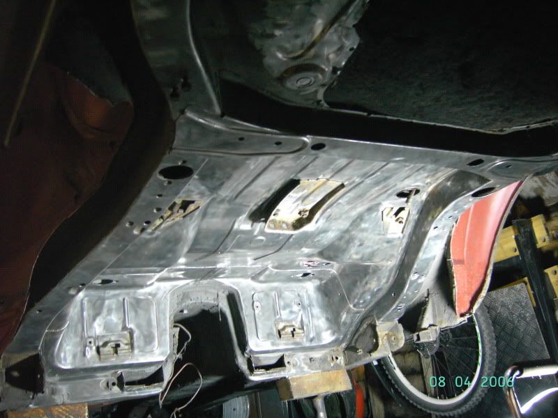

OK, I've had a few days off. Been helping a mate move, sore for a few days... and just generally getting on with life, but here's the latest 8 or so hours work.
It doesn't look much in those pics, but that is a large area. Save for a few harder to access areas and around the rear spring hangers, that is the back of the car done.
Obviously I need to address the hole in the boot floor. :lol:
Fuse, these are the wire brushes I have been using. Quite effective, but still wear down faster than I would like.
The golden ones at the top of the picture I am yet to try. I only bought them out of desperation. (I also asked for one and was supplied two lol). I have a feeling underseal may clog them up, but they should be good for primer/rust etc.

Jokes aside, nice work mate. I've been using the silverline stuff too. Just on componenets but it does wear them down. I bought a bench grinder brush attachment but it just gets caught in the safety guard and at 6krpm was lethal without that so I returned it. The finer (gold) wire brush attachments are good. They are useless with ANY dirt/ think paint etc as they clog up so much more easily. But I have noticed that they pull off some of the more stubborn rust areas compared to the twisted knot brushes. I am reluctant to try a 'branded' wire brush attachment at £20 a time. TBH my first twisted knot one has lasted all the running gear apart from the rear beam (dont have it here). I think that will kill it off.
What are the yellow ones mate? I've just got red and blue based ones...
I know it's a fiesta but this has only cost me about £22 including drill/grinder attachments I havent even used and the primer which goes far. It should see out the rest of the running gear/components tbh:
Used, New and Used (cleaned):
I feel the red oxide aerosol on the nuts and bolts is overkill but its going to protect them a tad. Atleast I know what I've prepped this way. Keeps the surface rust off them until I paint anyway to some extent.

The yellow brushes are something I forget the name of, Powercraft? They come in packs with flap wheels too. From Aldi. Great value - when they have them.
The better yellow one I got from John the other night when it was brand new, as Toolstation is all sold out.
Like I said when you started the restoration on your parts, all I have experience of are the Powercraft and Toolstation jobs. I can't see a £16+ quid Bosch wire wheel lasting anywhere near long enough to justify the extra £12. :lol: I just hope Toolstation get their act together and order more in. I'm off to the bay now to look around for more unbranded deals.
BTW, 6K RPM you say? I'm sure an angle grinder is more like 10K plus - and guards just get in the way. it keeps you on your toes, and a nip from it every now and then just makes you greatful for wearing thick gloves! :lol:

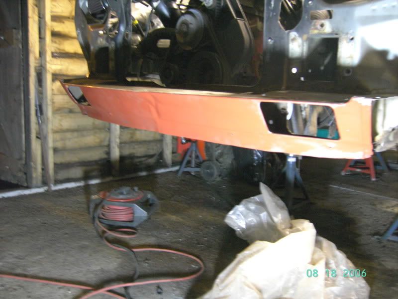

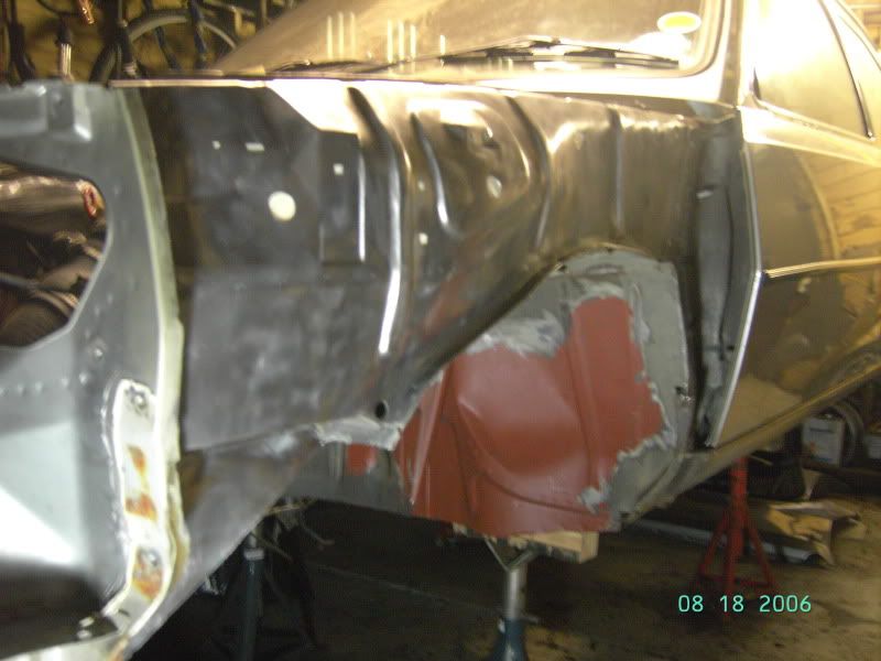

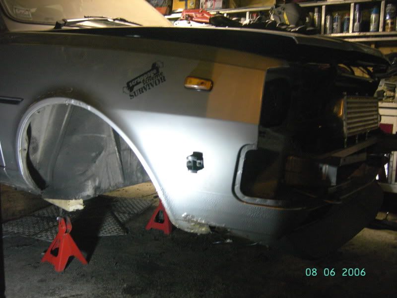

Been faffing on again. John was over this afternoon and we raised the car up higher and moved the front stands. Cheers mate,

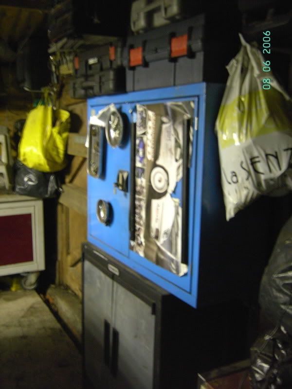

Then tonight I created some room so I can work on the O/S/F
Cabinets were previously about a foot away from the O/S/F.

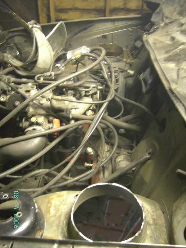

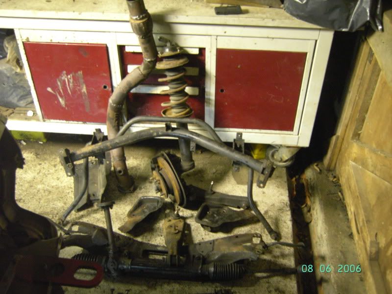

I removed everything else (running gear wise) that needs to come off. Sorted now. Just the engine left, and that is staying in.
Can see the damage where it fell off the jack in all it's glory now. lol
Damn straight! Although when I stuck that on I never envisaged going this far lol.
Crossmember, subframe thing, steering rack, tie bar, bottom arm, front leg etc.
It may not look like much, but it put up a decent fight in places - espsecially the steering rack. Could have done with hands that don't have crippling pains running through them whenever I am in an awkward position tbh.
More underseal removal next time. Joy(!)

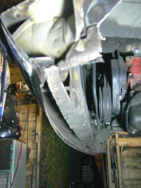

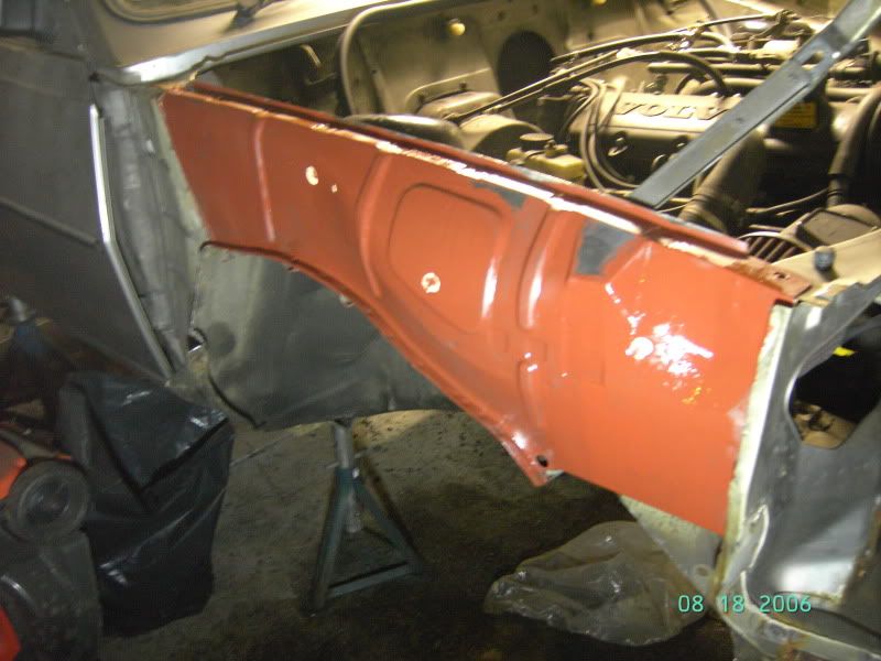

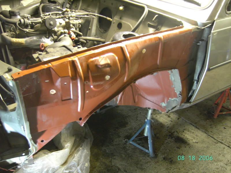

Another belated update. Had other things on lately, but still been getting some stuff done on the car. Here's what's been happening over the last week or so.

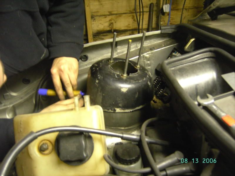

I am wanting to raise the front turrets to allow for more suspension travel.
Thanks to one of Johns scrapper GLT's I have another pair of turrets, perfect to extend mine the 2" I require. Ala Nikidev. Just not as fancy! :lol:
Ronnies ideas and keen eye came in very handy once again. I wouldn't have thought of going about it this way. Makes perfect sense though. Thanks again mate!
Stud bar allignment FTW.
N/S looking a little worse for wear!
These seem to be the only pics I have. Steady hands in action. lol
One side fits, just needs a little more tweeking and the turrets cleaned up (underseal) before it's welded to the car. The other side isn't as far on.
I have modified the front valance so that it is now open, instead of being a trap for water and horrible sludgy crap. De-lipped it too, so this one will never rot out. It had a bit of surface corrosion in places, but nothing serious.
I will weld some brackets to the rear of the valance and the underside of the crossmember to regain the panels strength, but leave enough room to keep the inside free from unwanted nasties.

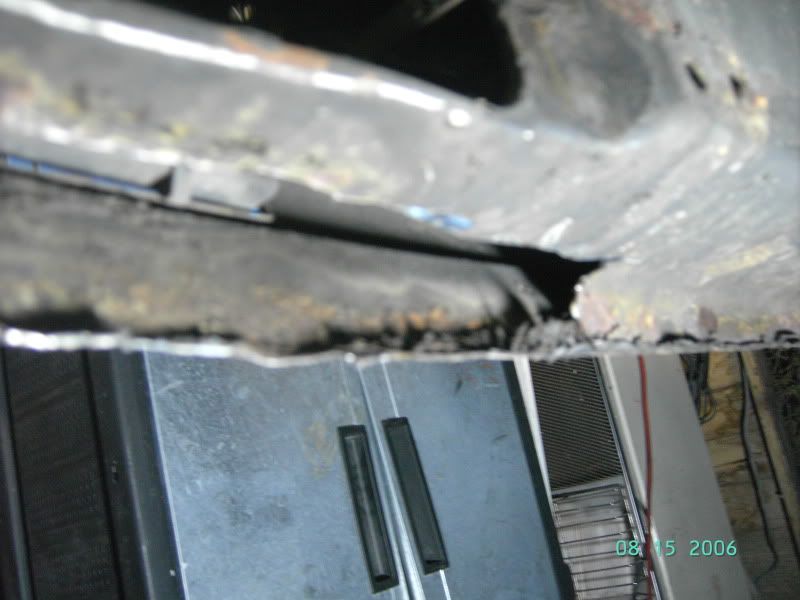

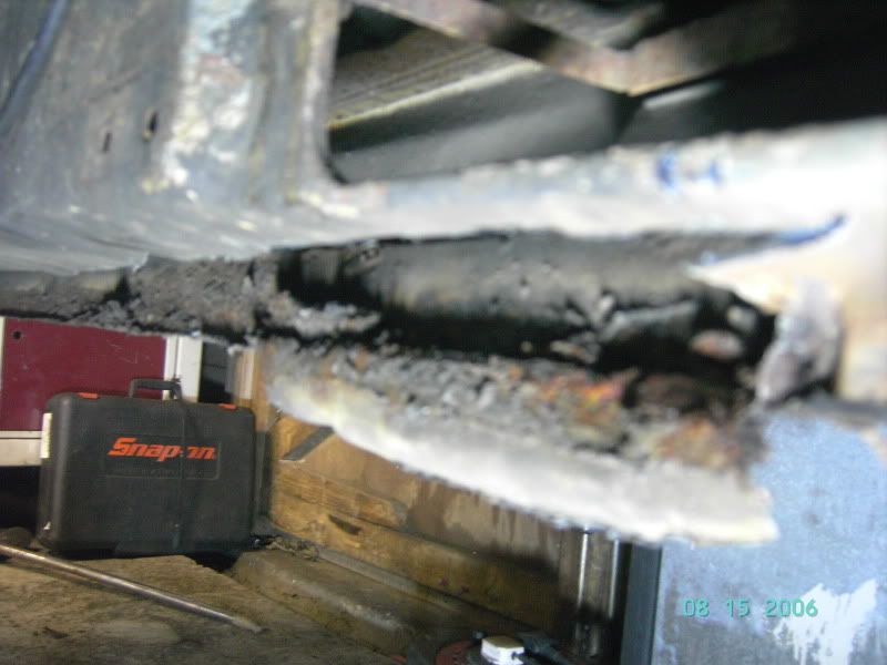

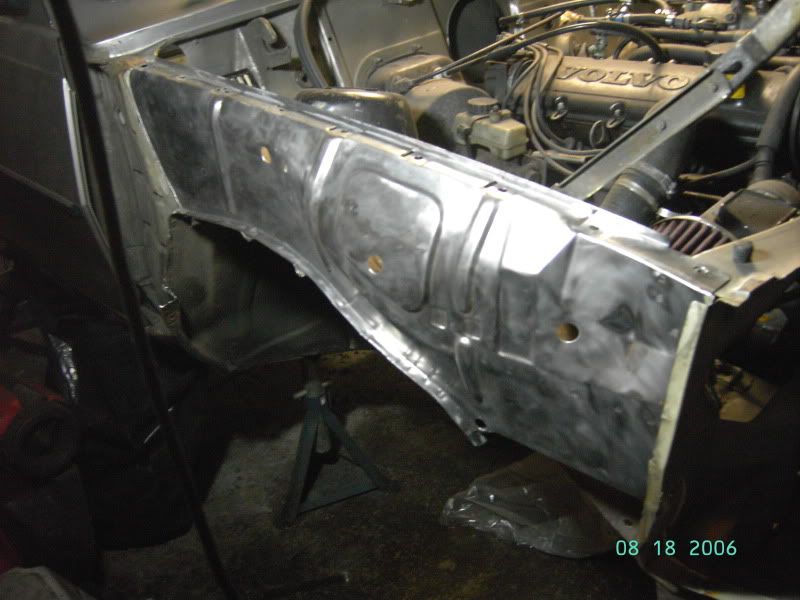

Here's what was hiding and happily eating it away from the inside.

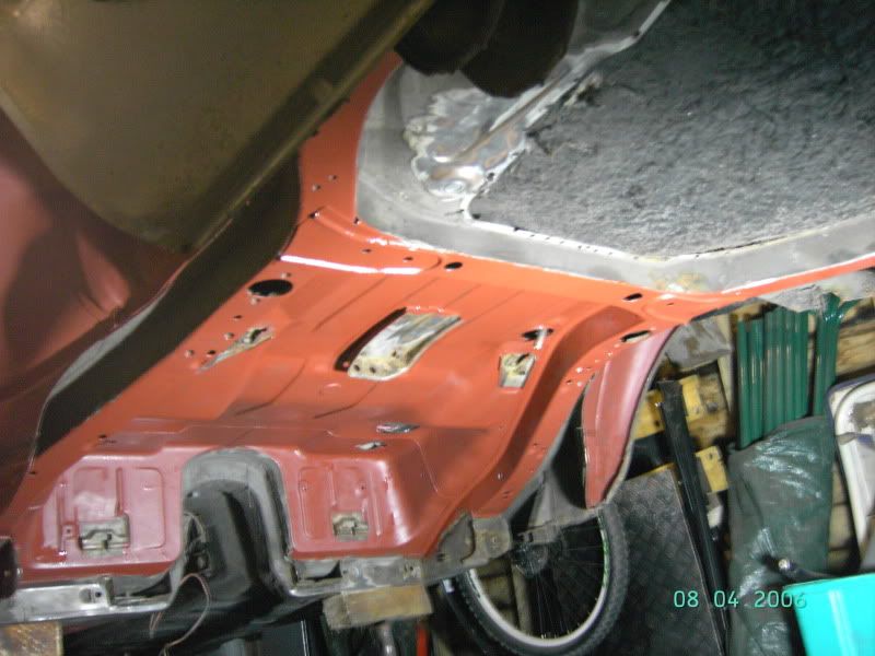

Inner arches bare metalled and painted. No nasty surprises hiding there.
Lips also trimmed right back for wheel clearance.

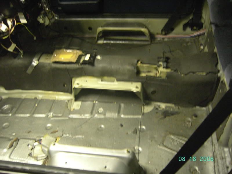

The seats and carpet etc are out to allow interior access. This was surprisingly complicated.
One side of sound deadening removed. The reasons for taking this off are twofold. To see what if anything lurks beneath, and when I do fit a couple of buckets and strip the car out all I will need to do is give the floor a quick rattle can.
Will weld the bungs up. As can be seen, one of them has diseased the floor pan.

I have done my favourite trick of bare metalling further sections of the underside and then not being arsed to paint them, no doubt they will need another quick pass with the wire wheel to bring them back up to spec for painting. I was planning to have the underside as good as finished this past weekend, but my hands have been really sore, I couldn't be bothered to crawl about on the floor and it's been freezing. lol
