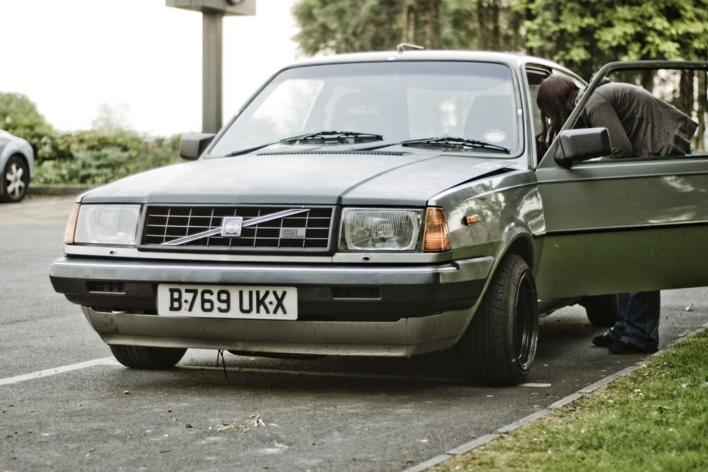

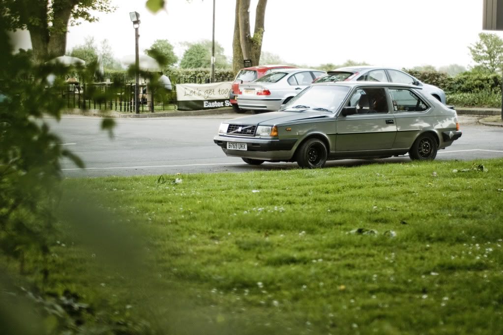

So yeah, drove all the way up the A38 to b'ham, not a problem, apart from the gaf nearly dying from hay fever. Was a good chance to check things over and get some more pics :wink: (she was fine, by the way). Definitely driving the A38 from now on to get to and from bristol, its waaayy more interesting than the motorway, and with the short ratio 1.4 box, easier on the fuel and ears too.
Pics from the stop

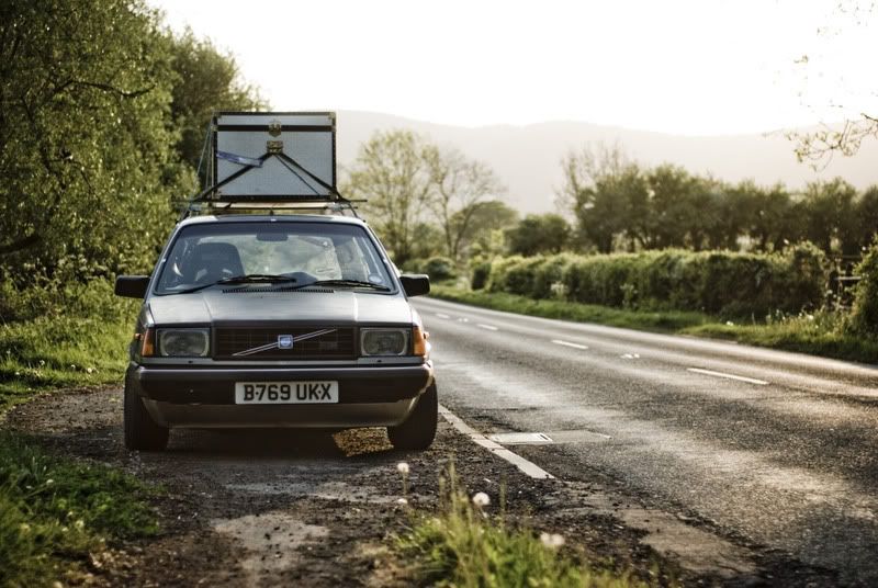

Just a few more pics. drove part way home to malvern without a hitch, saw the family, grabbed a trunk from the local jumble, and got a free roof rack! Wahey!
YEAH SCENESTER ROOF RACK! :lol:
does the job though. on the way back to brizzle however, every now and then he would hesitate, like he was carbed still. The idle would go lumpy every now and then too. Fuel pump is sound, no crap in the filter, timing was done right. job for tomorrow is check every connection. Seems to be some how related to the heater fan, as when I turned it on, he hesitated, turned the fan off, back to normal. Though it could be complete coincidence. Didnt do it for the rest of the journey though. Check over everything when I have time is the plan.
