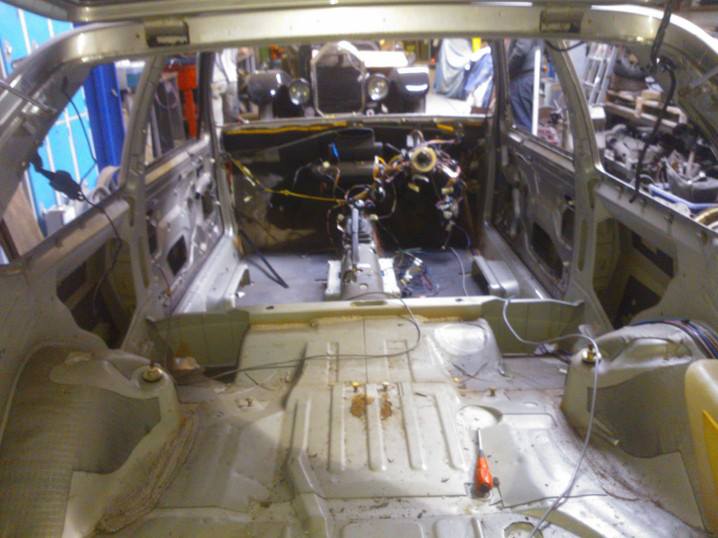

interior all out now for sound dedening and wires

This is a brake down of the rear beam diff and gearbox all being reconditioned every nut and bolt
Rear Mounts
Primed re beam after it was sandblasted and etched
rear back plates ready for etch prime paint
The massive whole plated both sides
New Rear bearings
Every nut and bolt getting replaced or cleaned
Drums blasted but getting heatproof paint
The rear bit ect put it back together tomorrow new lines slaves and shoes
Rear Mounts
New Rear bearings
