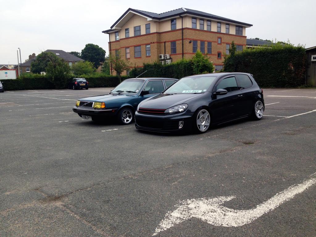

Haven't done anything else much just a few pics of the car…
