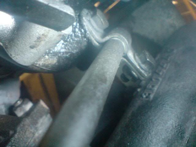

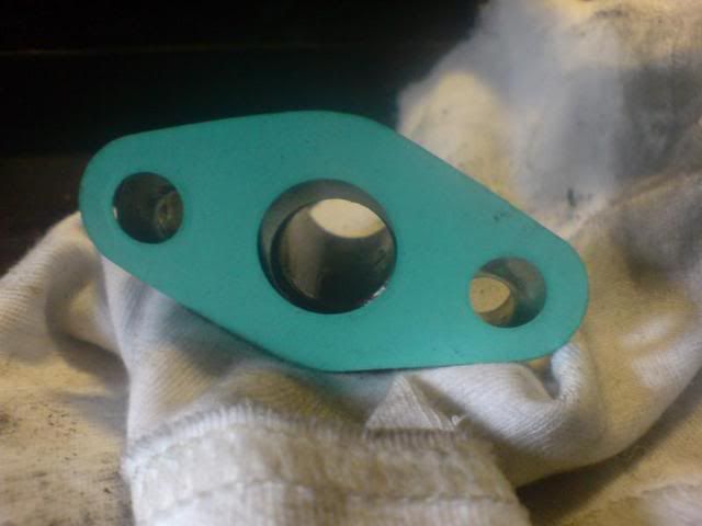

As previously mentioned, it was spraying oil out of the return for the turbo, so I whipped it off and replaced the gasket and O ring with OEM Volvo parts, expecting this to solve the issue.
The gasket isn't correct. Despite Volvo using the 940's chassis number to order it:
See how much of the old one was left lol.

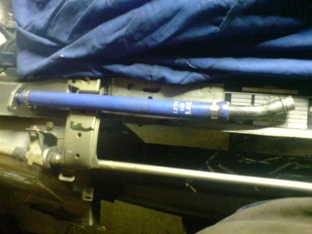

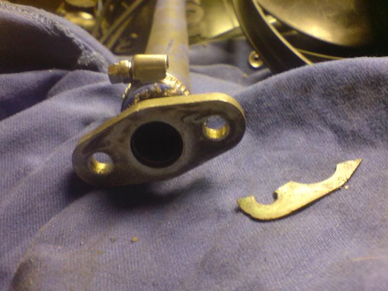

The DIY return
Here's the less than adequate space/view you have to work with if you don't remove the mount. I managed to remove the return, but fitting it again this way was impossible.
Despite the incorrect fitment, I stuck it on anyway. Removal/fitting required the radiator out, alternator off and O/S engine mount.
It seemed to have worked initially, no drips when running. It has now started dripping (Noticed on Saturday night. First offcial run out) although nowhere near the previous extent.

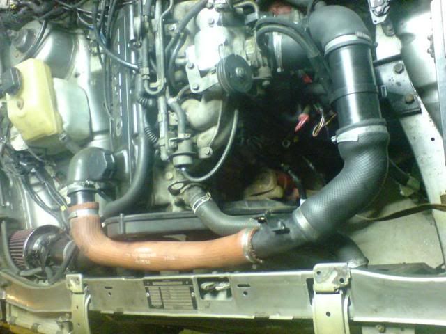

As can be seen, I have no FMIC atm. Just a cheeky scrapyard bypass until my eBay core arrives.
I still have a few gauges to connect, exhaust brackets to make, the damn oil return again and the FMIC to sort and the water cooling to the turbo housing to reconnect. Did the flow hose come from the 940 header tank? Also I am still running a GLT injection pump. It doesn't seem to cut until fairly high up the rev range in 5th. So it's more than adequate to get someone going. I CBA to fit my uprated pump ATM as it needs a fancy connector.
Despite the superheated air and limited boost/power. It still pulls very well. I have whooped a couple of modern diesels a new Saab Turbo and was level pegging with some form of BMW X5. (before i slowed so I didn't lose the louvre lol) Mostly just to see where I'm at more than anything. It will be good to see what's to come when I have a FMIC and bleed valve with the engine running around 11 psi.
The DIY return
