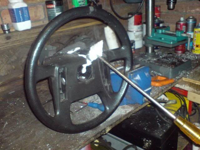

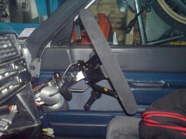

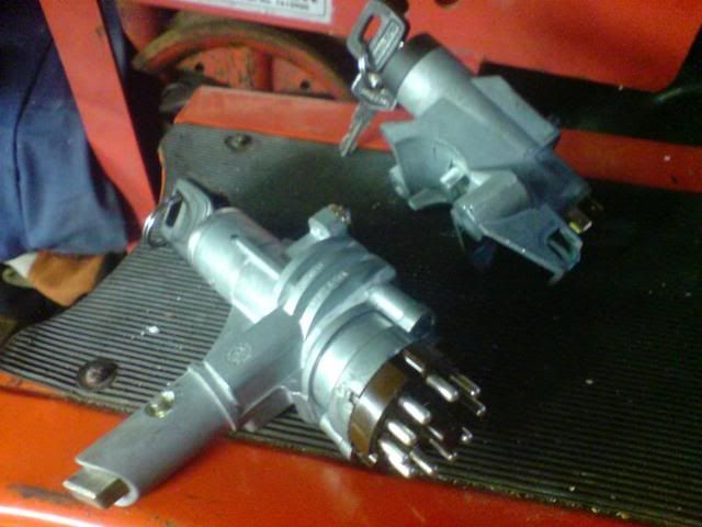

I decided I was sick of needing two barrels to operate the car.
The 360 one had already had it's electrics moved over to the 940 barrel, it just served as a steering lock.
I hacksawed/chiseled the OE barrel off the colum - fun. If I could have gotten a drill in I would drilled out the bolts. If I had no windows to protect I would have used a grinder. Hand tools it had to be lol.
Wit the intention (although I knew it wasn't very likely) of it looking quite similar to the 940 barrel when removed.
This was not the case lol

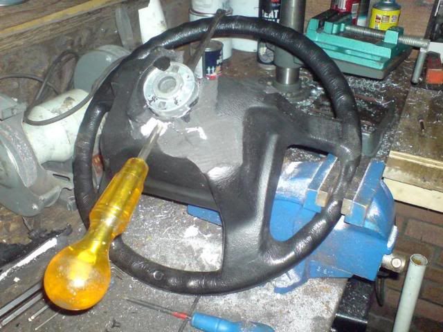

I had utilised a mk1 Fiesta steering boss I had lying around to allow me to fit the deep dish wheel I have, as it turns out me £3 Halford boss wasn't for a Pug 205 but we won't let that stop us lol. Plus, it looked the same as my mates, so that's my excuse. I never intended using it on this car, but then I never intended fitting a turbo motor or having quite as much fun as it can provide on occasion lol.

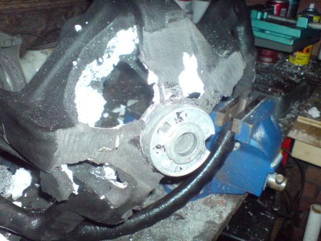

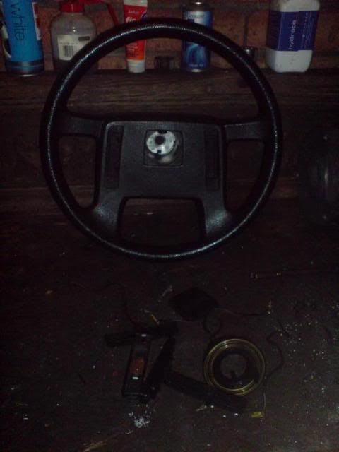

A trip to Ronnies was in order, and the OE wheel from my 360 was in for a shock.

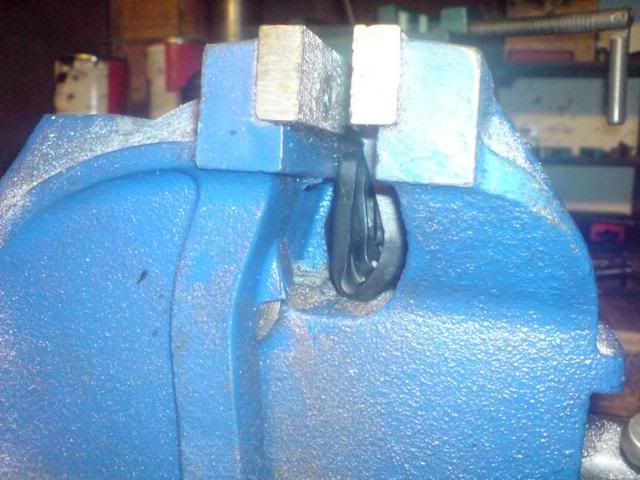

50% of required parts removed.

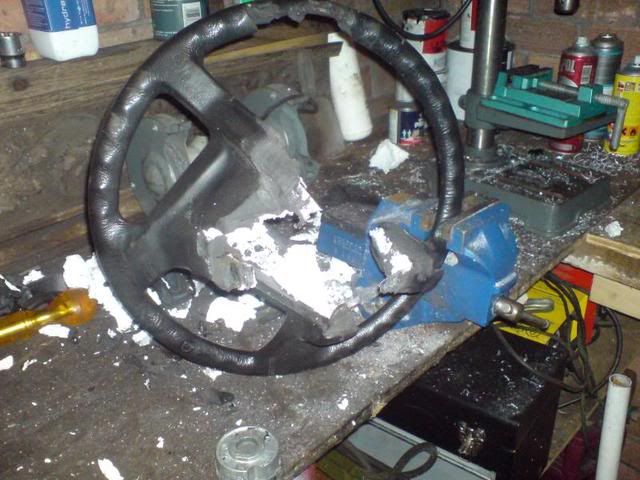

Nearly there. The polystyrene centre was a surprise to both of us.
Thanks for the boss Mr OE wheel. You have been good to me - except for when I occasionaly catch the horn after straightening up after a skid. Infact. fcuk you lol.
My harsh words to the steering wheel must have hurt it's feelings, either that or Ronnies dog has been watching Firestarter. [insert shocked face emoticon here]
As whilst the boss was being turned down in Rons lathe the wheel suddenly became more interesting.
OMG
Then the horn buttons tuned on us so needed to be restrained.
Ok maybe not. It's just fun to smash and burn things sometimes. You know the score lol.
I hacksawed off the steering lock from the 940 barrel at the same time as Ronnie lathing up some magic.
The finished win.
I have also rehomed the barrel and fitted my titanium Nismo gearknob for m0ar longa driftz y0
Another crap update from yorus truly lol. Thanks again R0nald. (Y)

Why was it necessary to use the 940 ignition switch? My 95 daily 940 doesn't have anything special I was aware of, is the 96 one different? I'm also using a 96 donor for the 360.
Re: Turbo 360 update 28/10
I wouldn't know of any differences between the 95-96 940 mate. Surely both have transponder chips?
The 940 ign switch is far superior to the 360 job IMO.
I dislike the spade connections for the electrics and the fact it only has one accessory position.Must be a mk2 thing? Not to mention it was easier to switch the 2/3 wires over from the 360 switch than the 8 or so (guess) from the 940.
Plus I would rather have just the one key to start the car. I originally intended to run the pick up ring on the 360 barrel or in the vicinity and have the 940 key (or at least it's chip) on my keyring.
No point IMO. This is a better solution all round.
