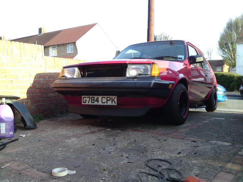

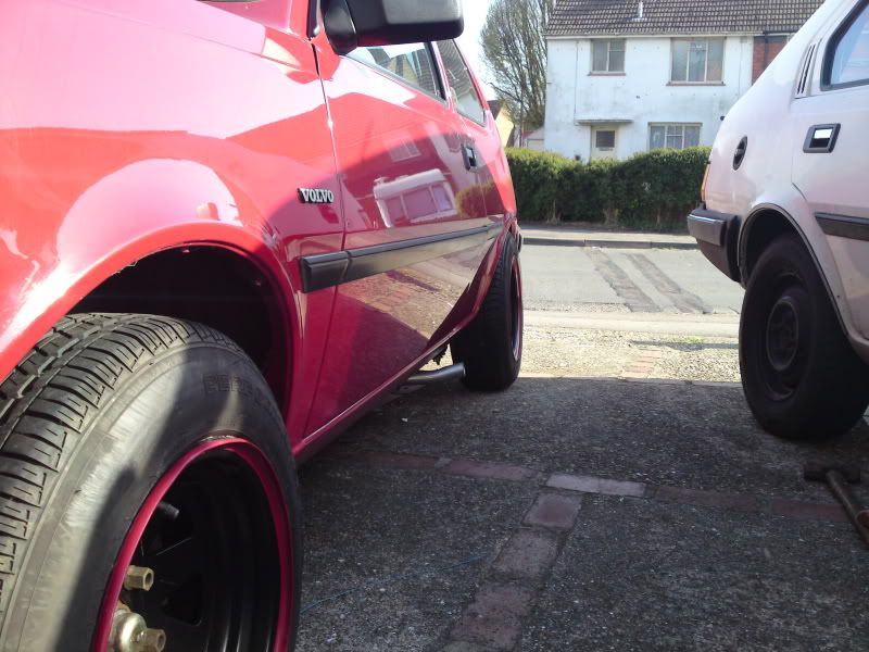

I've not had a chance to work on the car recently until the weekend just gone so apologies for slow progress :( . I had really hoped that I'd be able to fire it up this weekend but as per usual the job that was to take a couple of hours took most of the weekend!!!
I've modified the inlet manifold so the TB is at the other end and capped of the gaping hole that was left. No pictures of this because it needs a bit of a tidy up first!! Oh I also replaced the 1.4 rad for a thicker, non leaky 1.7 rad.

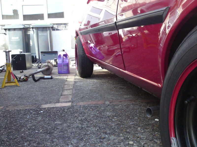

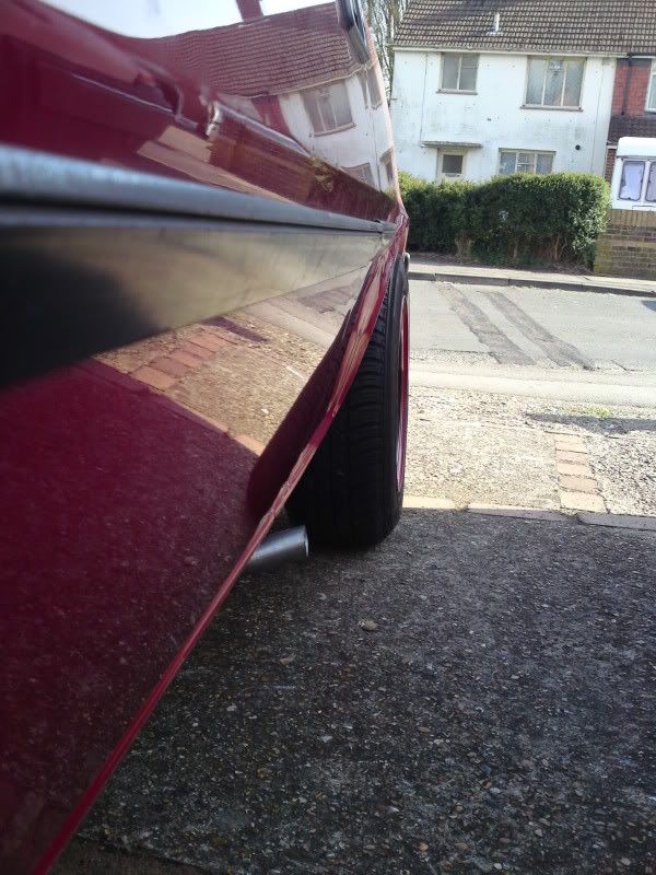

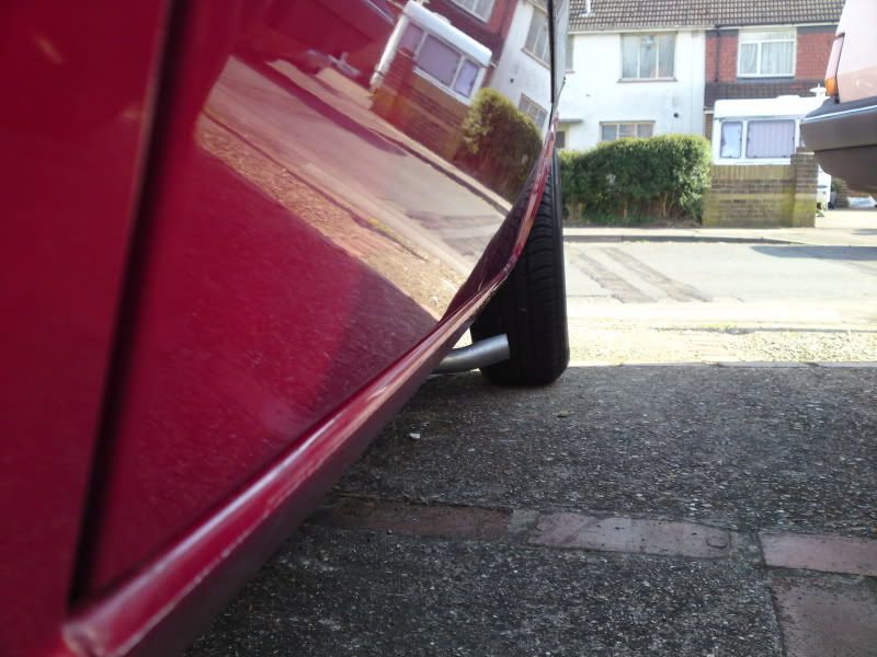

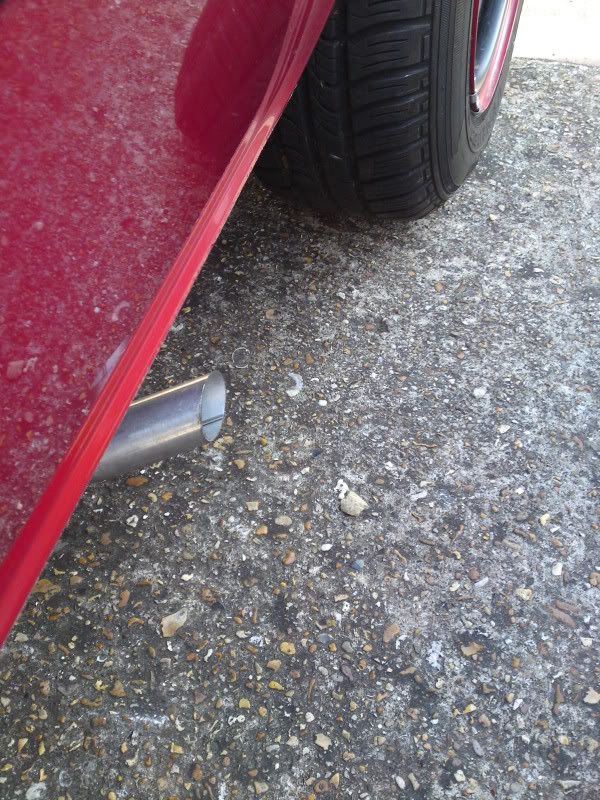

I've also modified the downpipe and finished the exhaust!! Pics of the finished product below :D
And how it sits at the moment...

Side exits = win, im going to "try" and do side exits on mine over the summer, as the over axel part is such a pita.
Looking good man, Cant wait to see it in action.

I got a side exit on mine, but it's pointing at the back wheel if you get me. It's not as exposed as that. I wish it was. Lovely car son!

gets better every update Andy.
Even when you say you havnt done much!
Your side exit manages to look understated AND spectacular.
superior work fella.

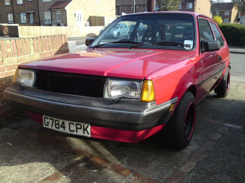

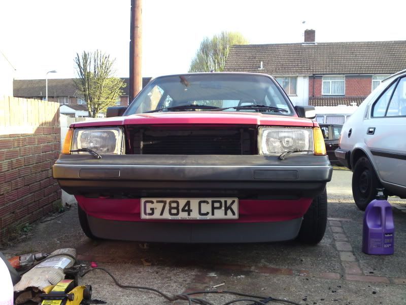

Please excuse the enormous number of pictures of the same thing below :oops: I couldn't really see it too well on the camera screen in the bright sun so I took a few more than normal!

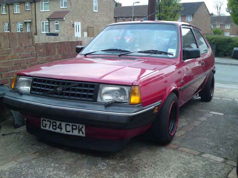

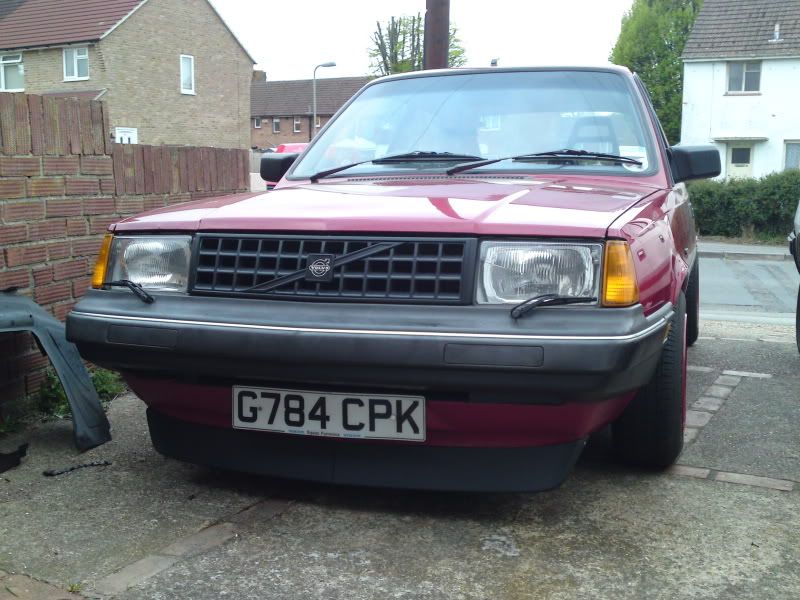

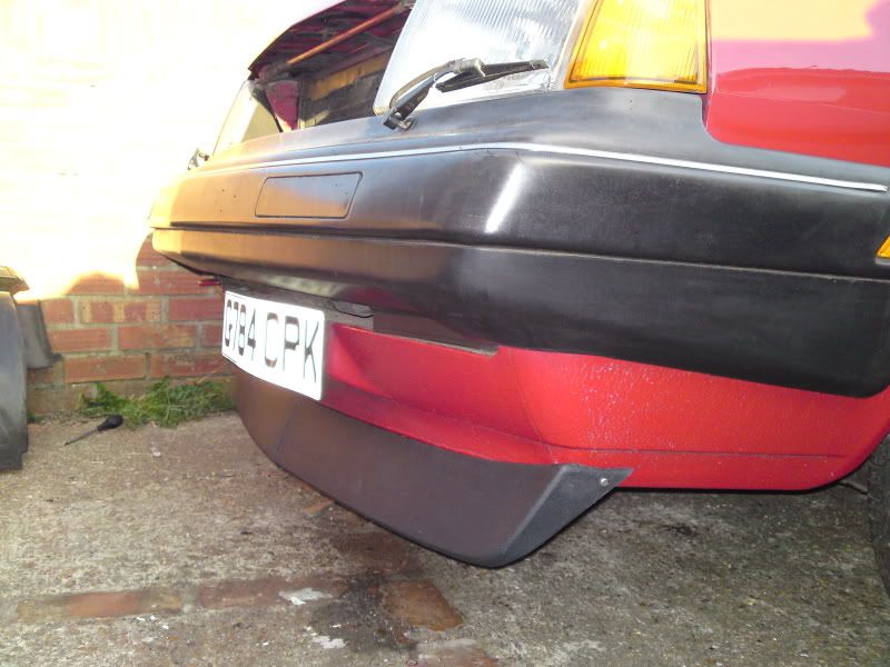

Yes I know its been done but I had been planning on doing this before I saw xtrmjks' car! I've also mounted it slightly differently - to the underside rather than the front face. Didn't require trimming to its width however the angle grinder did come out :wink:
Hope you all likes! :D
Re: Andy P's Project (update 08/04/09)
Post by volvosneverdie » 08 Apr 2009 09:02 am
looks cool man.
Whats it from?

Mk1 Golf. Available on ebay for about £25 delivered :)
Post by volvosneverdie » 08 Apr 2009 09:15 am
Good shot man.
It does look a lot different to Jonni's so i thought it might be something completley different.
Looks cool though andy. And bespoke.

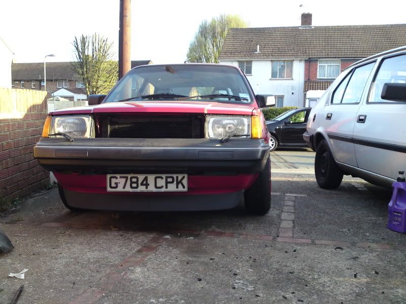

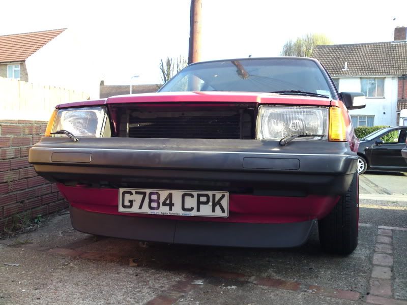

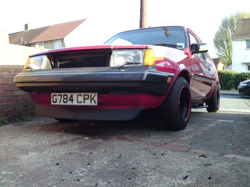

Well, had a week off work to get the car finished, running and MOT'd. Those that may have read my other thread will already know this was not the case!

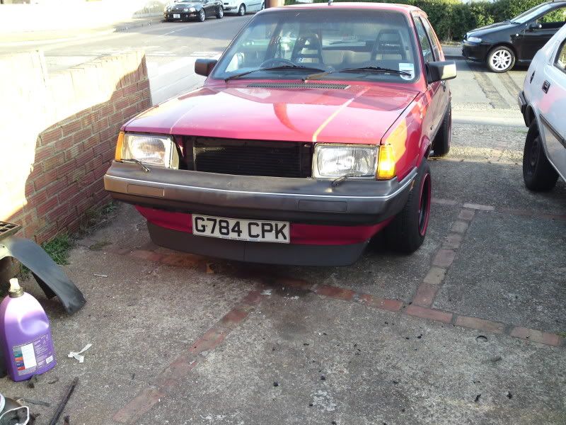

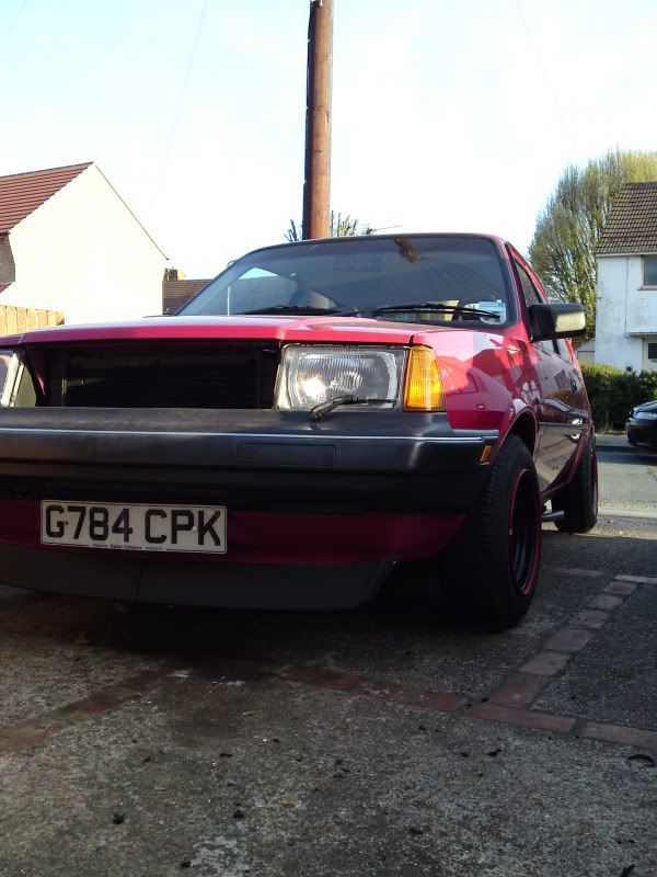

I have put in a lot of work over the week (although it dosent feel like I've got much done :( ) but theres not too much to show for it unfortunately. I did however drop the front a bit more (quite a bit!) to level the car out and now it just looks awesome!
I've only got some frontal shots of it at the moment but I'll try and get a side view so you can see how it sits. The front valance will sit a bit lower when the car is on level ground (the rear wheels are on a slope).
Enjoy -
Andy
