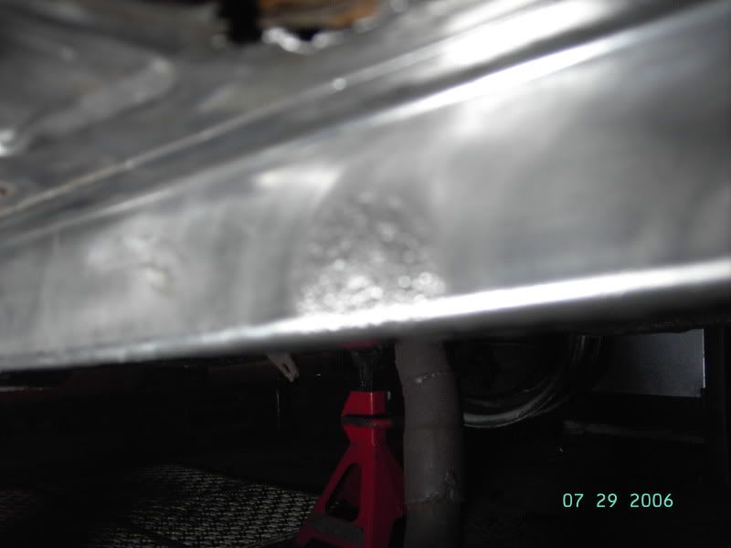

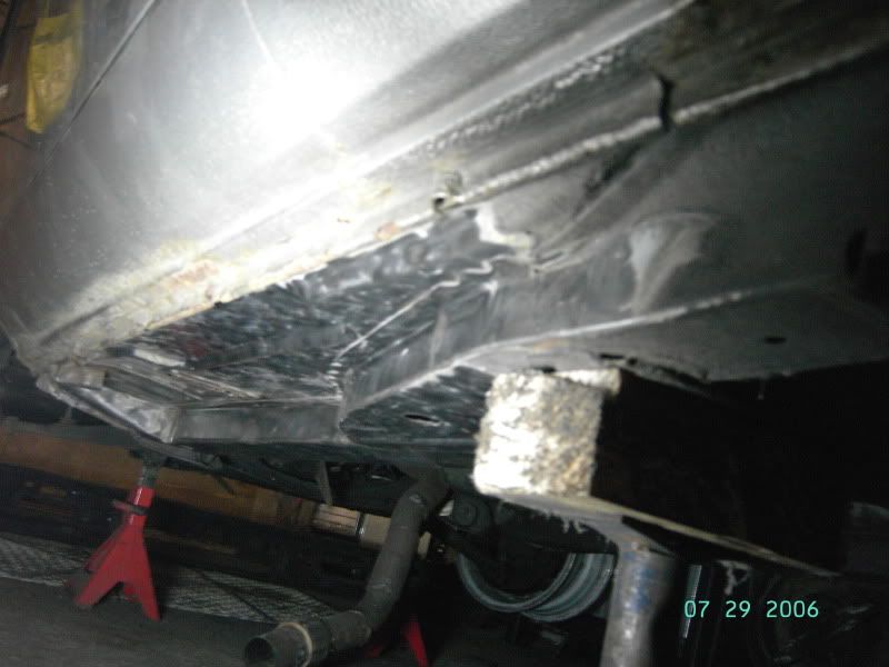

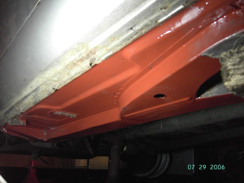

Got in 3 hours on this tonight. I can think of better things to do when lying on your back lol. Actually, the car isn't very high off the ground atm so I was mostly on my side. Meh. 3 hours is all my old-ass arthritic hands can handle. As you know, this is a sh!tty job. It's morale boosting to see it change to shiny steel - in most cases - then red oxide primer though. :D I managed to get most of one side of the floorpans done.
Underseal on the floor/on my chest. Clean steel FTW.

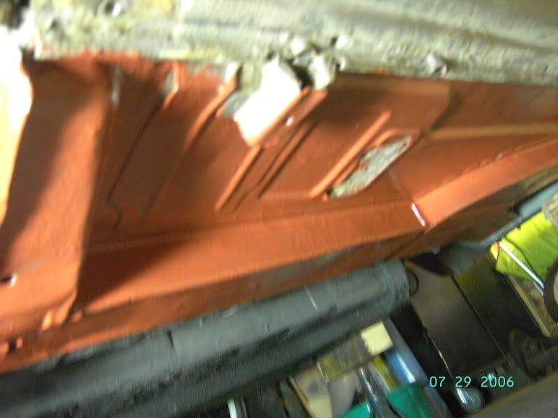

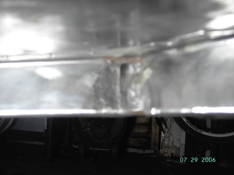

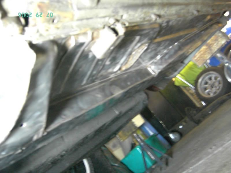

The only areas of 'concern' Now look like this:
No doubt they wanted to grow up and become structural holes. Sorry guys! The kind of thing above is my reason for taking it back to bare metal. You think some areas are fine, but the steel is nearly always corroded beneath it. Those were showing as blisters through the underseal anyway, but you know what I mean lol.
Jacking points like to rust away on these cars. I'm fine thankfully. I knew they were good anyway as I often jack the car from them.

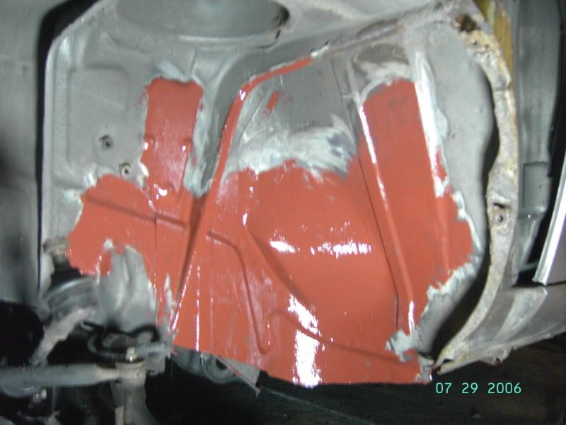

Marine spec red 'lead' FTW.
Anyone happen to have a pair of mk1/early mk2 front doors for sale? I want some. A pair of mk2 wings would be good too, oh and a mk2 GLT rear screen surround. lol
