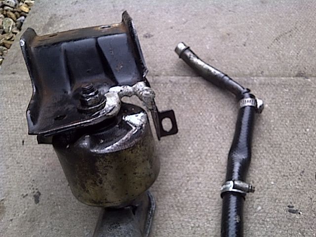

The push-in oil return works well enough in the 940 as long as you have an intact rubber seal. Obviously not much good though though if you use the 360 engine mounts. You just need to hold the pip in place then it will work well, so maybe a bracket bolted to clutch housing, or epoxy?

yea thats the problem on the 360 as you have to mod the oil return so it isnt a solid pipe like on the 940, that could be an idea pal, i will have a look, reason i was thinking of getting it welded is because i would never have to worry about it again but we will see,

need adviseing again lol, on what to do with the oil return? think the reason it poped out was i cut the pipe to long so it wasnt pushed in as tight as it could have been
im thinking just buy some braided hose and redo it like i did at first? but maybe put epoxy putty/quick steel round the bit going into the bloc so it cant come back out again?

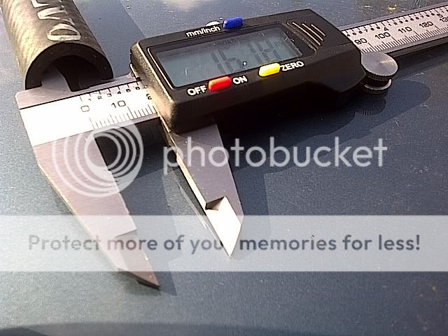

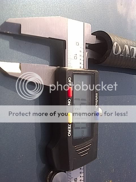

the pipe i was useing:
around 16mm id,

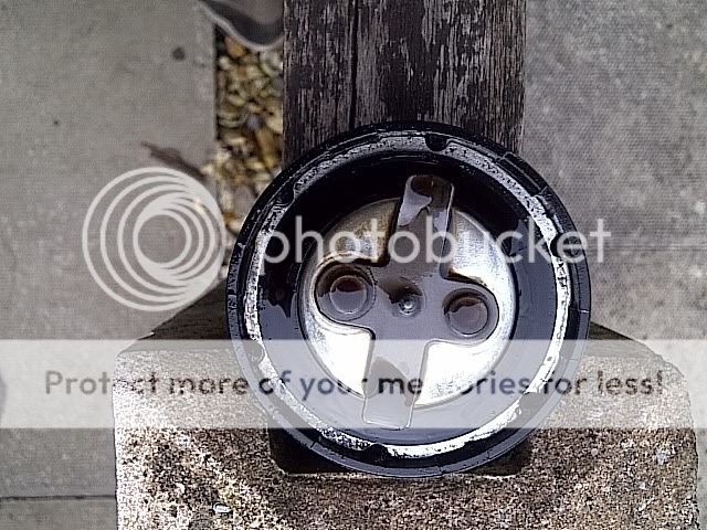

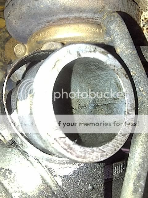

now damage it could have caused? the car is smoking its ring off (technical term for the exhaust pumping more smoke out than before), im hopeing just the oil seals in the turbo? there is abit of oil in the turbo/boost pipes:
oil cap seems clean:
if it is the oil seals in the turbo could i still drive it till the turbo has been rebuilt or replaced? or would it cause more damage? worth doing a compression test on the engine?
around 16mm id,

Oil after the turbo on the inlet side is normal. Have you maybe just blocked the return or something?
Is it smoking on full boost or all the time? If it is the turbo, probably not that bad but may gum up the plugs or damage the o2 sensor.
The hole in the block is different to the pipe to allow space for the rubber seal, do you have the seal?

the pipe had split and i replaced it and it poped out while i was driveing, yea i had the seal in, i havent drove it since i saw the smoke and thats when i noticed the piupe had come out and lost loads of oil, itr was smokeing on tick over i think, need to sort the oil return out and then i can try it proper, what hose should i use for oil? theres this on ebay but it isnt actually rubber http://www.ebay.co.uk/itm/MotorSports-1 ... 2819wt_860

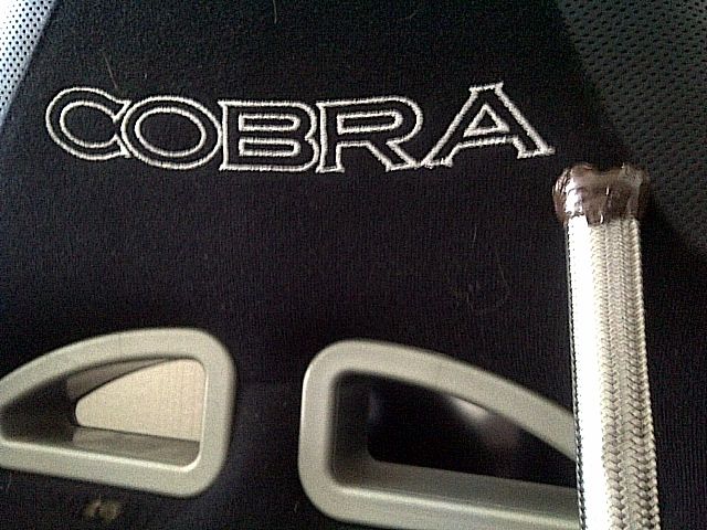

ive got some stainless steel braided hose comeing and im gonna try and modifie/smooth were it was rubbing so hopefully that will be ok? as for the push in bit i think im just going to order another seal for it then quick steel it in place to hopefully stop it popping out again? then time to see what damage has been done

I would drill & tap the oil return hole in the block and fit a suitable brass or AN fitting for the hose.

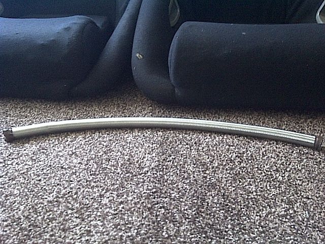

got my braided hose over the weekend so going to have a go at sorting the oil return out tomorrow and then fireing it up and see what damage has been done,

just noticed the actuator arm and the flap is catchig on the engine mount
o and the braided hose i bought was shit!
