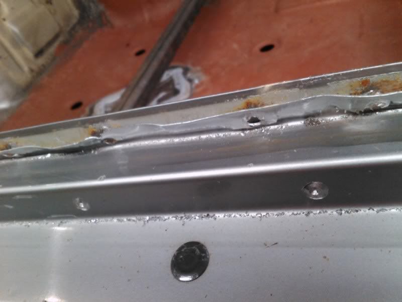

That inner sill looks pretty solid, just been looking closely at the Mk1 tonight for the first time in months. It's had new sills welded on but it's a rough job, looks like they've gone over rather than cut off all the old stuff, messes up the lines in the arch and side panel, you've done the right thing cutting it away. It's a real disaster zone under the Mk1 rust wise in lots of places so a lot of work to do. I think maybe I'll have to get a spit to do the welding properly, or at least get the car on it's side. You're right about the under seal hiding the rust, it's really dry and crusty.

Yeah, both the inner sills are rock solid. Save the three little holes in the middle one (outer in the pics obv). That will repair no probs, and at least I know she's solid there after this! The O/S is mostly the same. The outer sill is in better condition on that, and iirc there are only two holes in the bottom of the inner skin.
Sounds like you need to remove the sills from your mk1 then! Oversills are always bad news imo. It seems feasible to drill out the spots and recover the panel so it can be reused.

I was thinking I could re use the sills as they're solid, better than what they're welded to which is mostly now rust
I'm going to be using a lot of that scrap 360 for body parts, it's going to be more Mk2 360 that Mk1 343. In fact it would be easier to take off the Mk1 inner front panel and weld it to a good later car than what I'm doing......now theres and idea

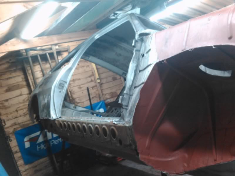

Back on subject Liam, when using the spit do you find that you usually have the car just tilted to one side or the other or do you find that you work on it fully upside down/intermediate positions etc. Just asking cos I was wondering if just tipping the car could be almost as useful if a lot more time consuming and dangerous?

I have had it on both sides at varying angles Andy, It doesn't go fully upside down - never seen the need for that. The shell can rest on the roof gutter either side, but travel no further.Hell Driver wrote: lol @ the random posts above.

As for tipping a car on its side onto tyres or something, that's a risky move imo. Very easy to damage the quarter panel.
If you get a spit you will reap the benefits immediately mate!

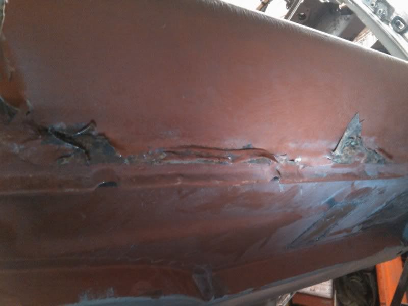

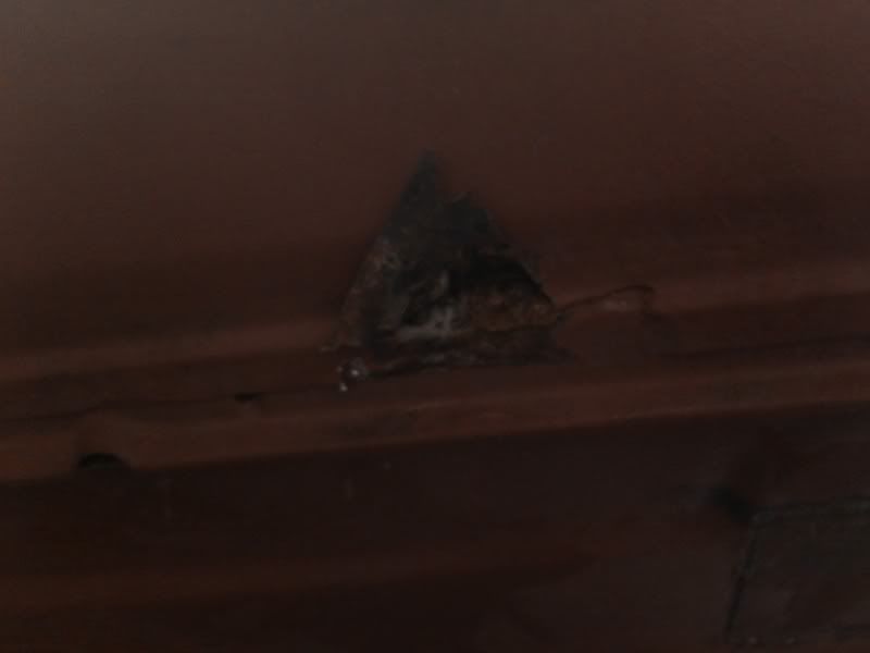

Whipped the O/S sill off tonight;
Nice to see the usual rust between panels :/
Cream crackered, The lower edge of this side was very thin and showing signs of the big C in many places that weren't apparent after a good go over with a knot wheel...

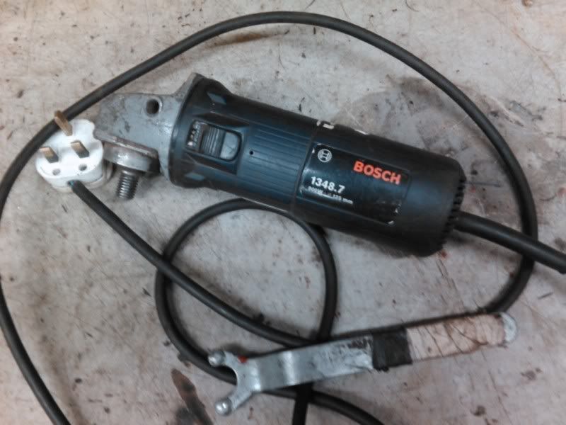

My twenty year old 4" Bosch angle grinder died tonight.
My dad is taking it into work to see if there's anything that can be done. Fingers crossed there is. It's been a fantastic little grinder.
Looking at it now, it's mad to think I never intended to replace the sills initially. I assumed they were OK except for a few holes, wrong! Most cars of this age should have them replaced as a matter of course imo.

RIP Grinder.
Why do they always die so middle aged/old.

Nothing a set of brushes probably wouldn't sort out.L14MNP wrote:My twenty year old 4" Bosch angle grinder died tonight.![]()

Cheers Mac. The grinder made a little pop from the front. Something's terminal I think! Was just thinking that it will need rebrushing soon.macplaxton wrote:Good work coming along there.
What happens when brushes go? Never had it happen.
