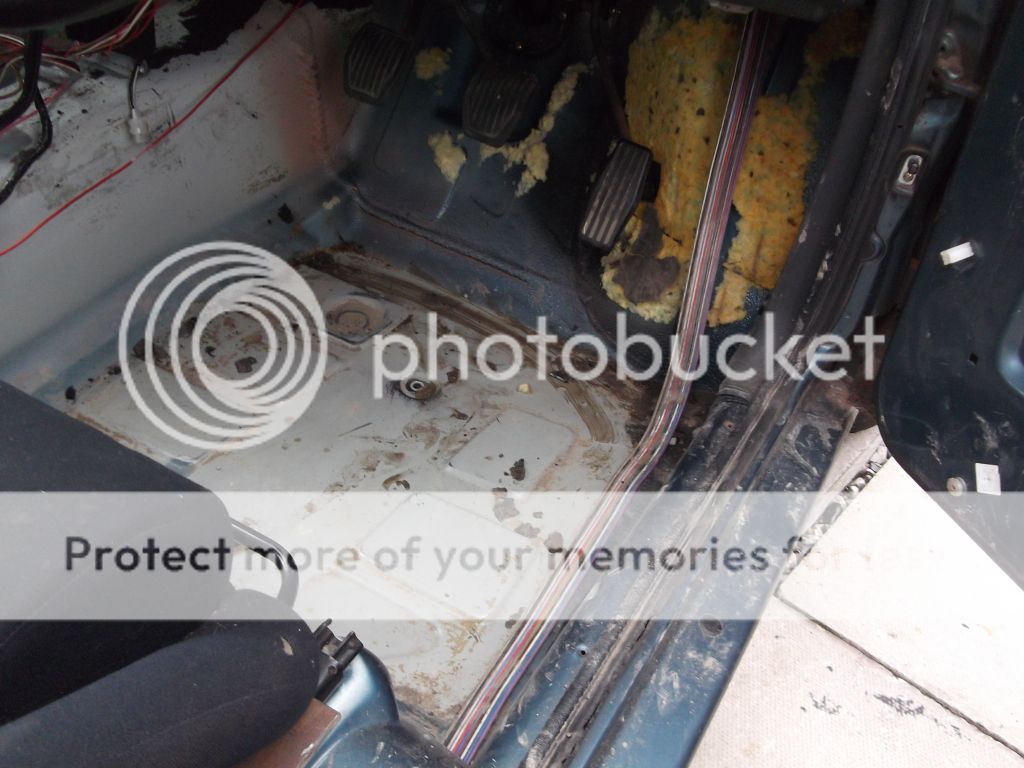

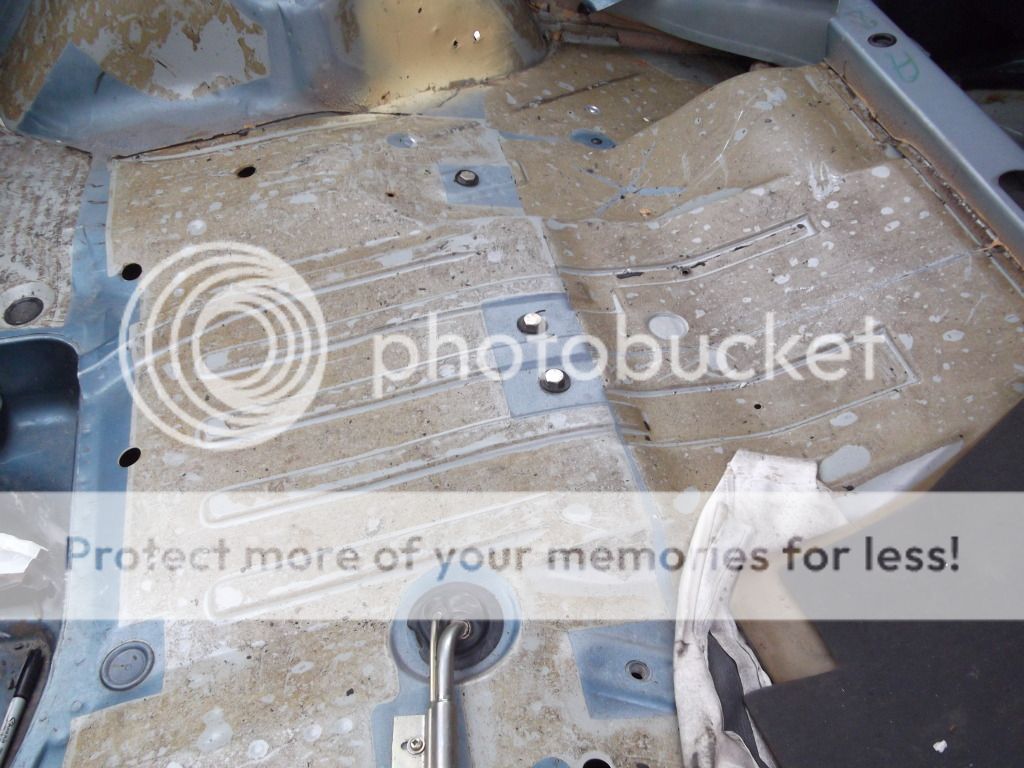

stripped out the sound deading
pretty clean and only found 1 small hole.

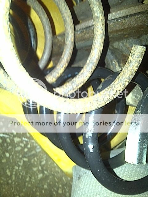

cars still on standard suspension till i can afford some proper adjustbles, and was obvs very soft and bouncy, stumbled across these sierra 4x4 springs and got thinking they seem much thicker and stiffer than the volvo ones, so took one of my springs off to see if they fitted and they did
couple of coils off so they matched the front and it was all good and alot stiffer
volvo ones on left (sure the owner before me had put 340 springs on, so soft and thin),

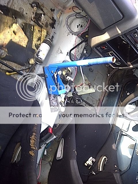

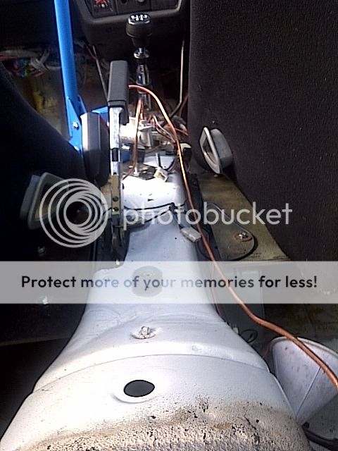

got hydro fitted and should be plumbed in on sat

pis of hydro mounted, cars a mess

got round to getting the hydro plumbed in today, sadly it isnt finished and bleed yet as one of the fittings was wrong
will be finished tomorrow,

hydro is plumbed in and bleed up now
just need to buy some clips for the brake lines and tidy them up abit but shes in! going to hopefully sort out my cooling issue and pat a new drop link tomorrow
