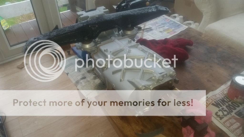

All empty, cleaned and painted. New fuel lines, filter and handbrake cables ordered

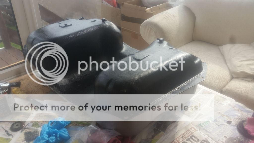

Fuel tank cleaned, derusted and painted. No real rust inside, its been degreased inside to remove any varnish and gunk.
Gearbox and dif all cleaned and painted. New gasket between the 2 and i had to replace an output flange. Just waiting on a dif gasket kit and some fluids.
The halfshafts have also been fully disassembled, degreased, cleaned, painted and built up with new boots and clips. Leaf springs and radius arm have been treated to Dais red polybushes and some por15 coating.
That just leaves the axle to strip and install bew bearings and coat it all up nice and shiny.
So hopefully thats the first installment of many this year
Re: 50 shades of grey - '87 GLT
I do like to see a clean gearbox, and the diff brackets look solid, how did you manage that? You going to paint the bell housing and torque tube?

Offered the tank up to measure it for some new straps. Ill be cutting some strips of zintec tomorrow at work to weld to the recovered box section ends of the old ones. Then i need something rubbery to put between the tank and straps, im thinking old wetsuit

Did you find new diff brackets?

No, theyre the original brackets. I thought they were cracked but it was just the old plates inside that had completely fallen apart. With that and all the shit that was on them i feared the worst but they turned out smart. A good soak in the parts wash, a little scrub, some POR metal prep and a coat of the same POR ali engine enamel the box has and youd think they were new
result!
A few more bits to order and it can start to go back together with a fresh backside, then get a ticket and go straight for a custom 2.5" exhaust to replace the cheapo ebay once thats been blowing since day one.

Nice work Tom, how much were the gaskets if you don't mind me asking? Cause my diff is leaking oil from where it joins up to the gearbox and the diff backplate.
