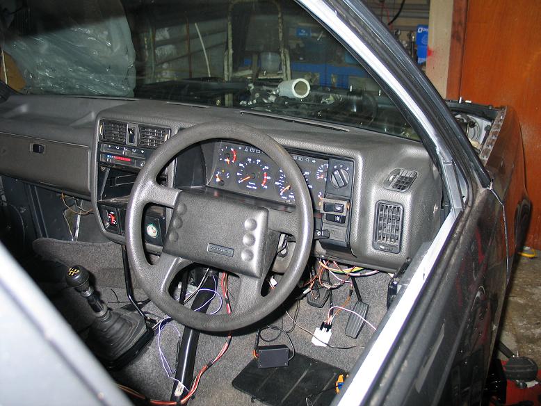

Update for the start of November:
Had a few setbacks after adding fluids. Got radiator recore just to be sure and some nice waterless coolant only to discover the head gasket was leaking. Sorted that with a skim and new bolts (used a multipoint socket instead of a 6 sided and rounded some of the heads), refilled again and found the heater control valve leaking. Added to that most of the new brake union were also leaking, but just needed tightened (alot).
Anyway, while waiting for parts I've got the interior mostly in, carpets and wiring, dashboard, steering wheel, doors built up, adjusted and all the glass in except for the rear window. I plan to MOT it without the proper back window. just some plastic taped on incase it rains, so that I can take it to the trimmers to sort the rear headlining.
Had fun with locks too.
Also just added the uprated anti-roll bar only to find the tubes missing from the link kit.
Mainly waitng for the bonnet and bumpers from the sprayers, they've had them probably a year now.
Waiting for heater valve, and ARB link tubes to start driving it around under its own steam.

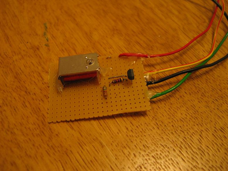

Convert 5V rpm to high voltage input for the rev counter, as there is no amp and coil attached to this.

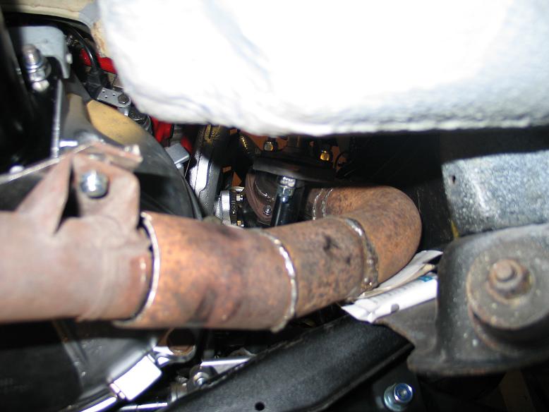

Exhaust downpipe to be welded to 360 exhaust

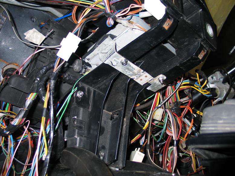

ECU mounting with modified 940 bracket.  Needs V-short bolt and small nut.

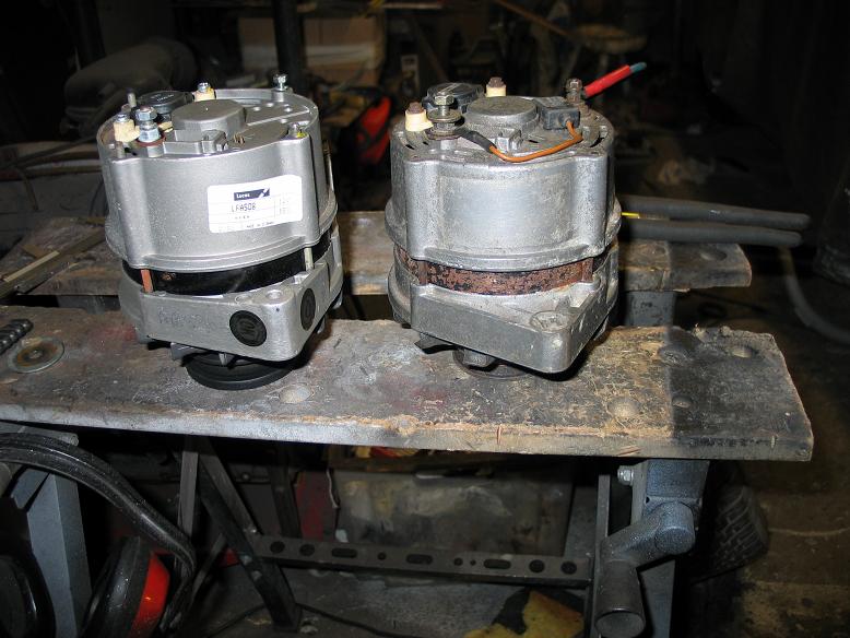

55A alternator has a wider adjustment boss, reduces adjustment range, but ok with the larger belts.

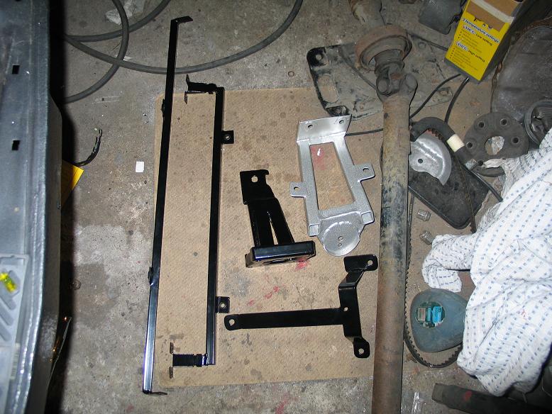

Some brackets powdercoated all nice

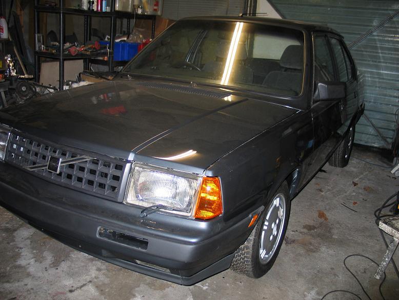

Starting to look like a car again

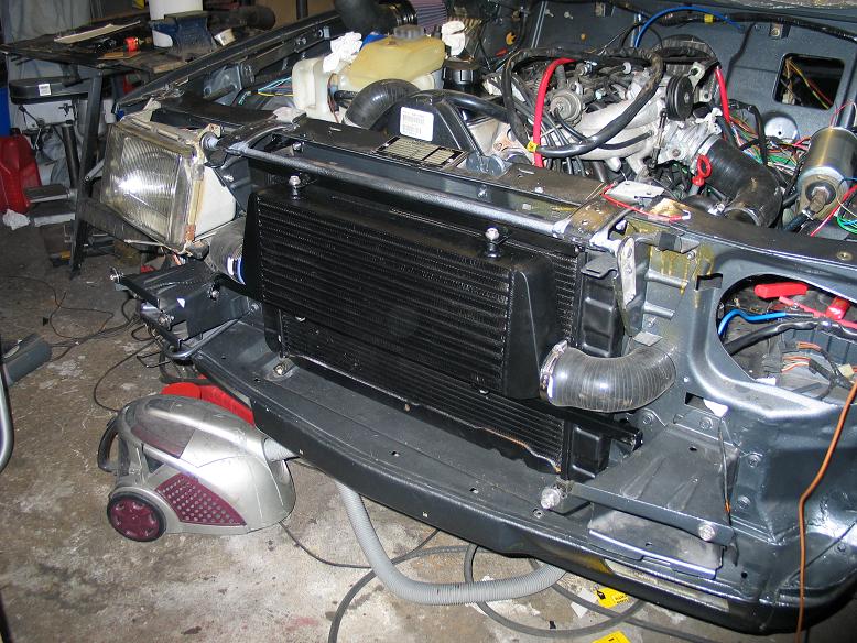

Looking great, that intercooler setup!

Going for the black on black look, although this was mainly for the sleeper concept.
I got black window trim, black grill surround on a dark grey body, thinking of a black head lining too :)

Could you ever get a black headlining on saloons? My old GLT saloon had a white headlining and to be honest it made the interior seem a fair bit more roomy, but the black does look good!

What engine mounts do you use?
Uh already sea you use a costume mounts..
I have the same original.
Ride to Live
Live to Ride
Posts: 2266
Re: 360 turbo saloon tidy up
Post by Ride_on »
I used the 940 bush for the RHS mount and made custom brackets. More details on the first page. They are also in the pictures above powder coated silver and black.
Its possible to use the original brackets if you reroute the oil return but its still tight and I didnt want any rattles.

Are you missing a dash dimmer switch below the fog switch?
sm4 sm4 sm4 sm4 sm4 sm4 sm4
Posts: 7944
[quote="MCHUDD"Are you missing a dash dimmer switch below the fog switch?[/quote]
It's a rotary dial on the later cars - looks like it's in place :)

Post by Ride_on »
Yeah its in there, lost in the compression it seems, damn jpegs.

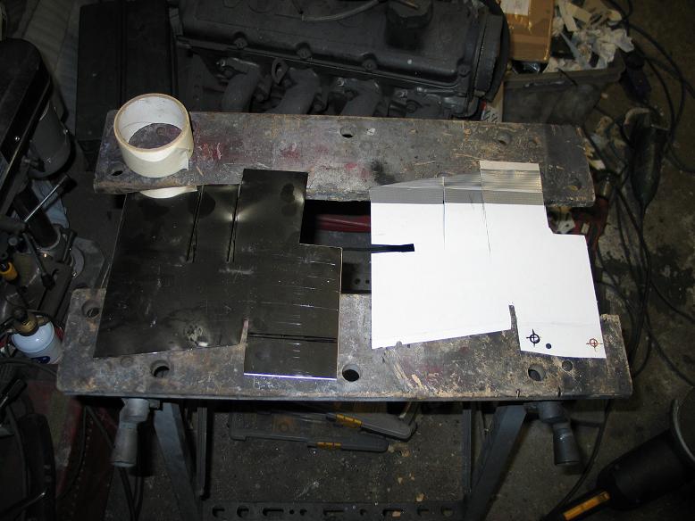

Made a heat shield for the turbo

Template method for heat shield
Shield installed
Shield installed
