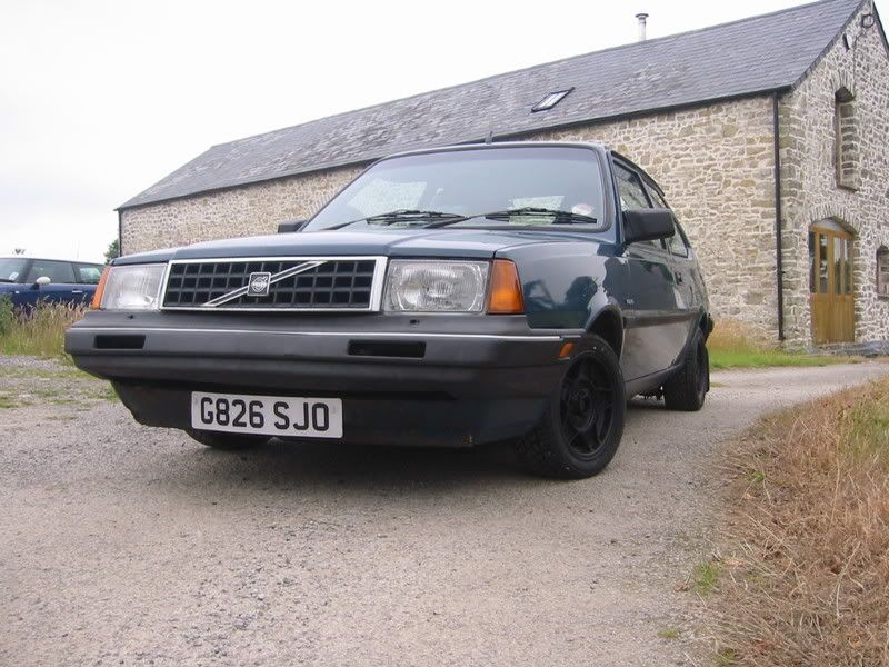

Post by WooDooUK » 14 Jul 2008 07:53 pm
Its totaly transformed the handling of the car.

Post by 340GLT » 15 Jul 2008 12:39 am
Mate that looks awesome!!!

Post by filthyjohn » 15 Jul 2008 09:06 am
KHROME WHEEL NUTS ASAP- will finish the look off a treat, nice wheel choice all the same. 8)
EDIT: and drop it, it's the absolute double of mine, and dropping 2" worked a treat for me.

Post by WooDooUK » 15 Jul 2008 04:26 pm
filthyjohn wrote:KHROME WHEEL NUTS ASAP- will finish the look off a treat, nice wheel choice all the same. 8)
That is with a 2" drop on the rear and 3" drop on the front. Its because they are 175/50/13 tyres.

Post by SteveP » 11 Aug 2008 06:32 pm
Looks nice, but cant help thinking it really needs 14"s minimum, good colour and wheel combo though
