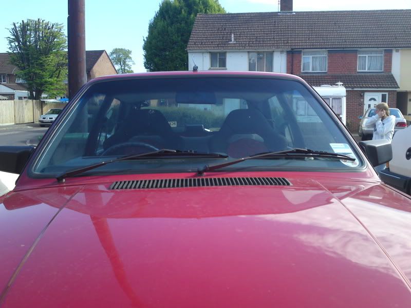

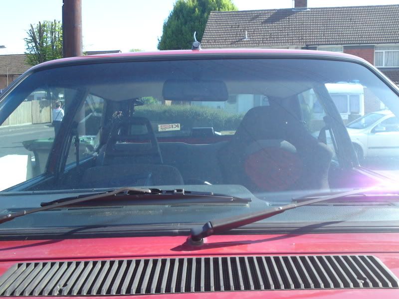

Well I've been having some running issues with the engine - however I think I've diagnosed the problem now - hopefully be sorted soon!
Did a few things on saturday - only minor bits and bobs like fit the new gauge cluster with a set with a rev counter; fixed the indicator stalk bracket.... Oh and did this -
One
Two
DONE!
Incase you've not noticed :? I've fitted some new(ish) seats! They're from a Scoob WRX which I got off ebay for a reasonable £50 - picked up on saturday and they were in a few hours later!
I'm chuffed with them :D
