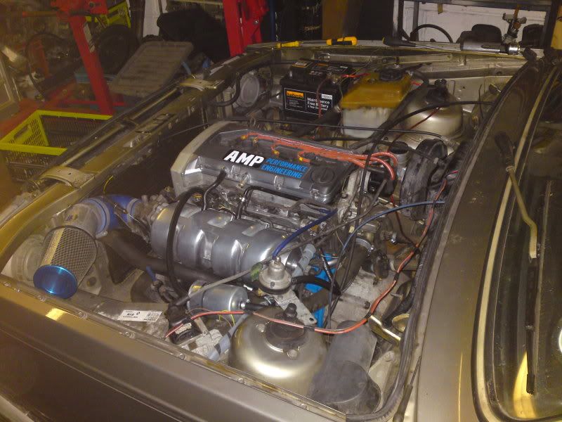

Meanwhile I split my engine to have a nose around
Electrics, fluid and fuel linked up
Major fuel leak on the fuel pump means we have to leave starting until the next day. But, she lives! Ignore the steam.

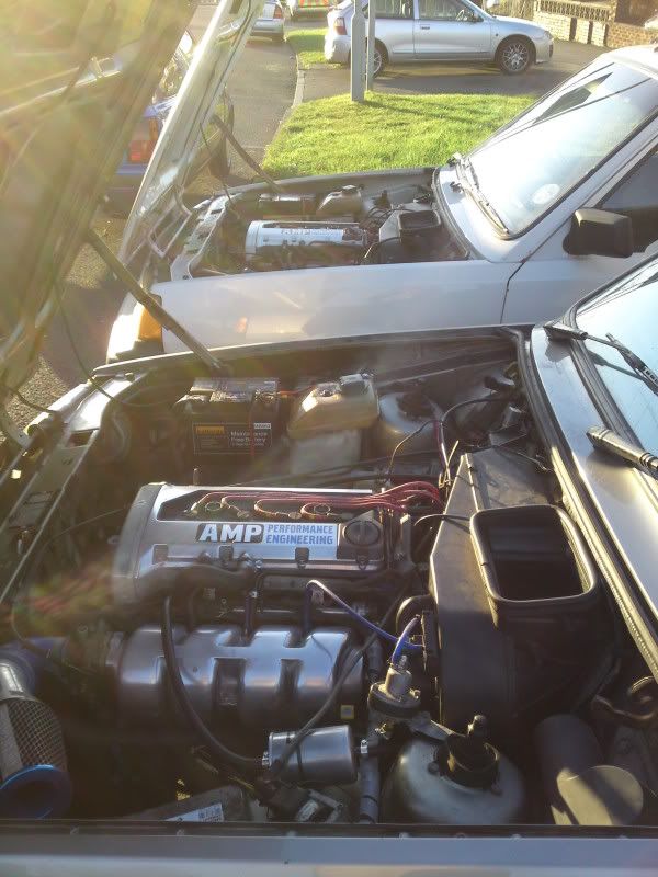

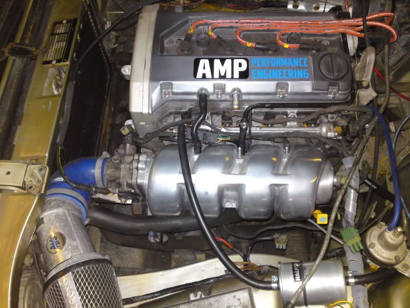

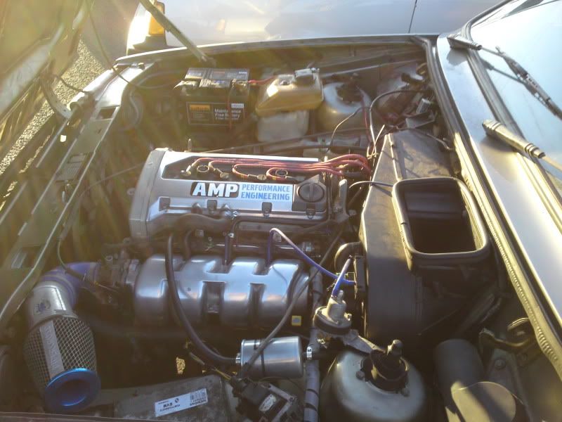

Spec is an F7R megane bottom end with a 1.8 ported and polished head, ported and polished exhaust and intake to match.

@ Kaos, i'm not sure its possible for your downpipe to be direct than that unless you have gone under the crossmember? In which case ground clearance????.....
anyway heres the pics

Engine in the bay

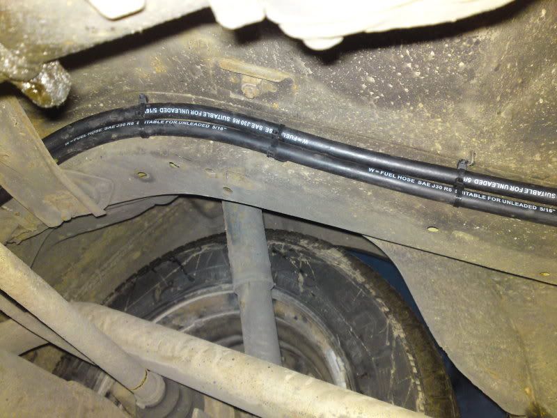

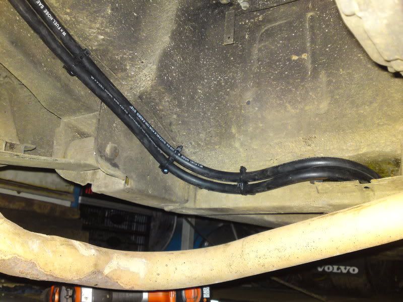

Fuel line routing

Adam, what clips are you using to hold the fuel lines in place? Dont look like P clips from the pictures?
- Posts: 3657
Re: Speedy88's The Tardis: Exciting F7R update!
They arnet they are specific cable tie holder and double cable tied. Ends up costing a fortune in P clips otherwise.
