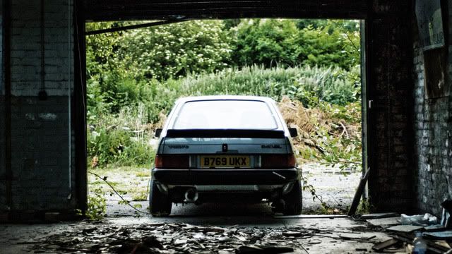

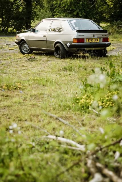

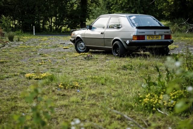

In the mean time I managed to get some more pics. This place is an abandoned warehouse near my home town where I've done previous shoots before, but the gate has been locked. Conveniently, the gate was unlocked (read - broken in to) this time, so I could get my car in. Awesome. :mrgreen:

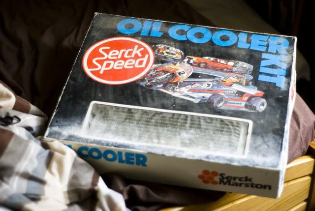

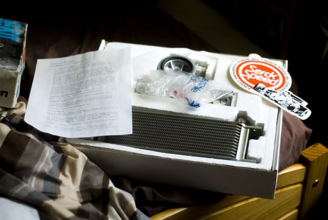

Whilst having a clear out of the garage, my Dad found an oil cooler kit he bought for an MGB eons ago, but never fitted. I stole it off him (asked) and will make good use of it! Just need to get a thermostat so the oil doesn't get over cooled while running normally.
Its pretty retro, but everything is there, and still in good nick.
Whats inside

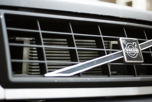

This is where its going to go, behind the grill, in front of the rad. Nothing has been bolted down yet, as I need to make up some brackets to fit it where I want it to go.

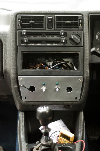

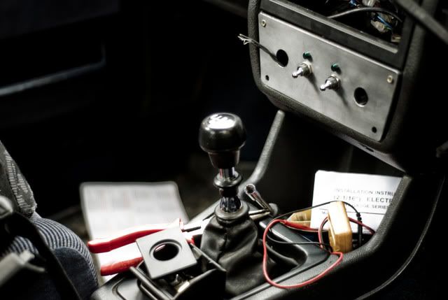

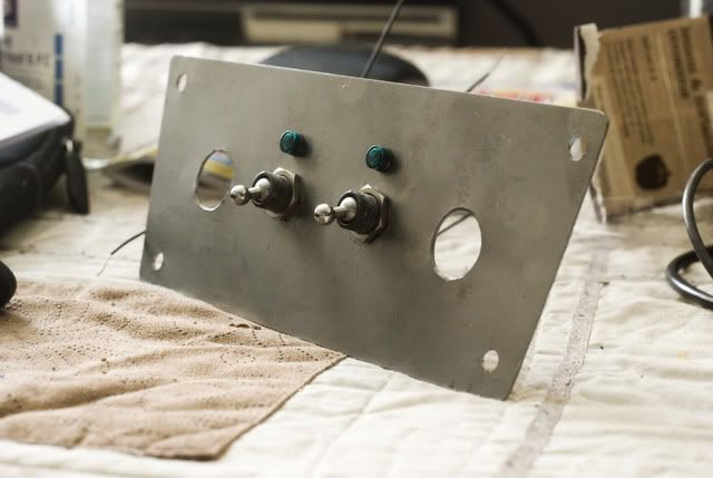

Also, I made up a plate that will house switches, a warning light for the oil pressure and the horn push. The switches will be for the ECU and fuel pump.
It sits here. Far left hole for the oil pressure warning light, and the right hole for the horn.

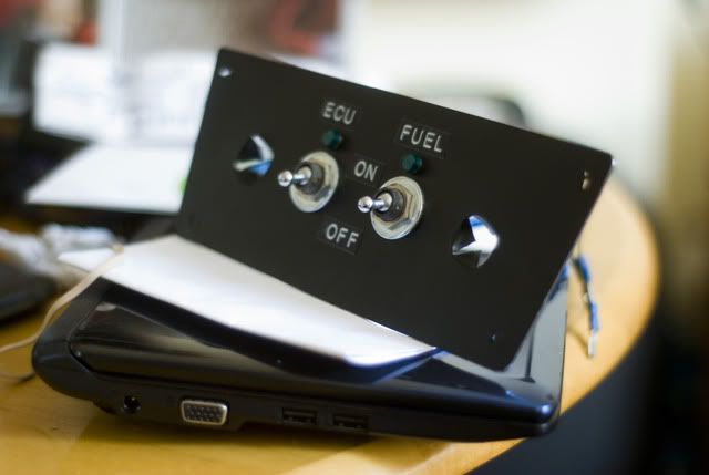

This is how the panel looks now. Wrapped in a plastic vinyl, as I couldn't find any paint. Its a little more scratch resistant too.

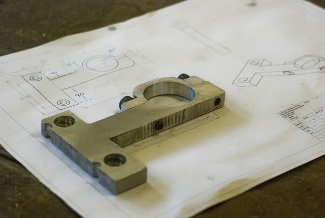

Tested the switches and lamps and they work. Still just waiting on the other bits. Tomorrow is going to be spent machining the coolant pipe bracket out of ali. :D

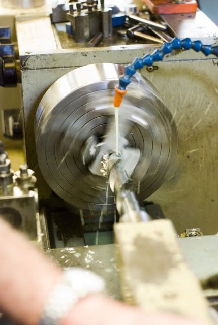

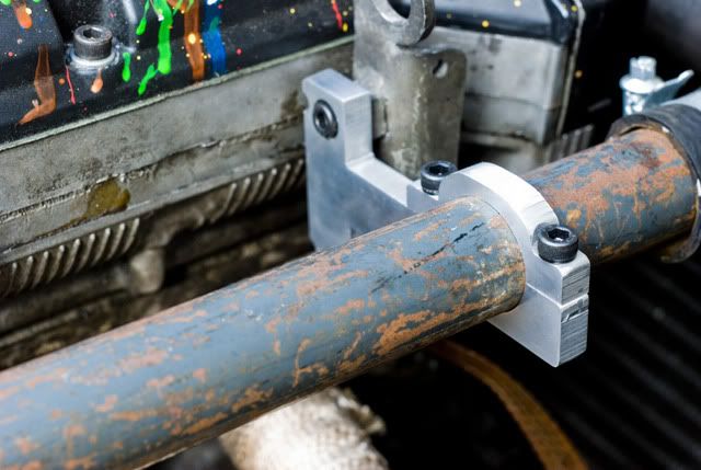

Managed to make and fit the bracket out of ali, does the job well! Not the tidiest of jobs, still looks good. Its under the bonnet, so I'm not too bothered.
Lathing up the clamp
Finished
Fitted
Nice and light and stiff.

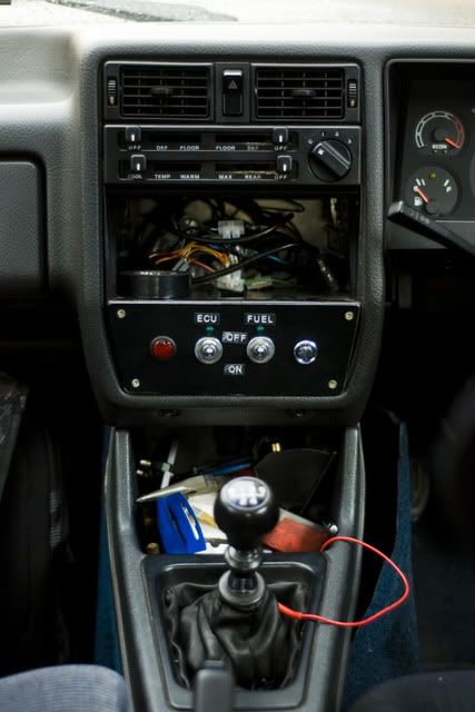

Also got the switch panel fitted and working. had to swap the stickers over, as the on/off seemed to be the wrong way round. Also couldn't get the little lamps to work. I can have lamps, but no power to pump or ECU. Ah well, I'll get it sorted soon. Either way I think it looks epically awesome. :D
I did think the warning light would be a little bigger, woops :lol:

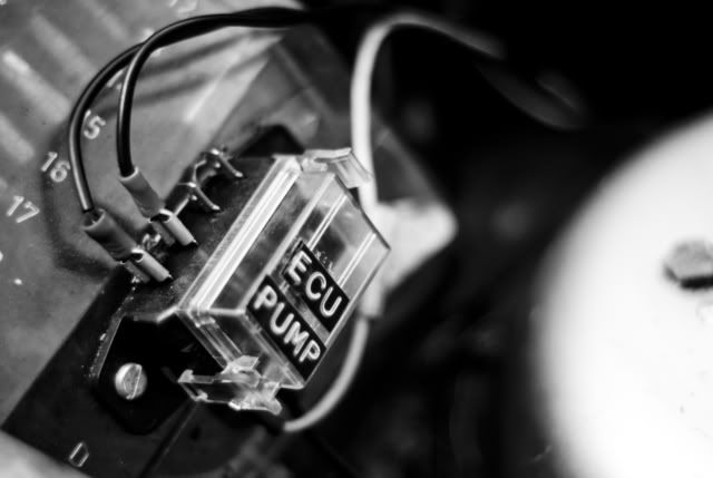

And some better than masking tape labels for the fuse box.
