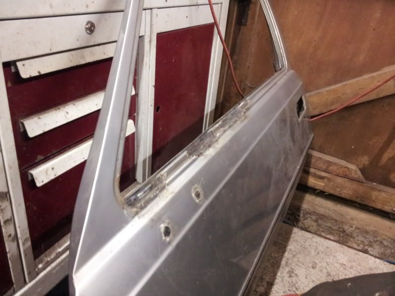

Here's the other door. I just stripped this one down this afternoon, and am very happy with it's condition. I still need to remove the seam sealer from the bottom, but top and bottom both look better than the passenger side so far.

didn't realise they rusted there, well never thourght of it. Repairs look good like!

Your doors are still awaiting dismantling, as is the rest of the Mk1
To be honest they look better than those but I expect I'll find some more rust beneath the trims. As far as I remember the bottoms are A1. If I carry out the repairs as I intend to, it will be only the bottom halves I use anyway (unless I find a mint pair of quarter light doors!). I'm watching this thread closely as I'll be somewhere near that point (doors) this summer. I will get on with it soon...honest!

Andy, iirc on my old doors, there's a bit under one of the mirrors which was crispy that I rubbed back and touched up, and a few scabs showing through in the same area along the top, so with the seals removed I reckon they may well be in a similar state. Overall they are definitley very good though, the bottoms as you say are almost perfect.
I knew when we bought the 343 that these doors were worse than my current ones, but repairable. The things we do for 'style' eh!
