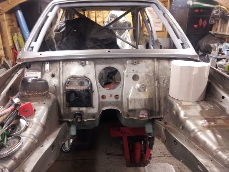

I failed to reassemble the column
 (have no clue where the brace bar bolts to either the column or bulkhead! Even after a phone call to FJ... Anyone got a pic?
This meant I still can't allign my seat, or see where I need to move the column.
So I turned my attention back to the riddle of how to remove the turrets.
Got the bastard out! It was very strange, a combination of what turned out to be a very tight press fit (see the lip below)
and the rest basically being part of the inner wing, although this seems impossible.
Will be replaced with something a bit like this
(preferably in steel trolol)
I know how to remove them now, but they're still a massive PITA!
I'm also about to PM Nikidev, as it looks like his extended turrets running XYZ 200SX coilovers are flat on the top, not sloped like standard. I assumed this wouldn't matter when running pillow ball top mounts or similar, but it's nice to know.
Anyone clued up?

Re: Turbo 360: Turret questions
Almost forgot, spoke to Nev from F1 Moto today and have ordered an awesome modified Escort quick rack setup from him. Gonna 5 link the shell courtesy of F1 Moto too, though that will have to wait a little while.
Time to plough through the plethora of hydraulic handbrakes out there and see if I can find what I want.
What does 5 link the shell mean man? unless youre talking about rear suspension...........
				macplaxton
 - Posts: 3283
 - Joined: 09 Feb 2008 02:29 am
He's talking about rear suspension. You need somewhere to bolt the links to. So you weld link attachments to the shell. Probably.
Correct lads.
This kinda thing, this is a 4 link.
As Rich says, you weld the link boxes to the chassis, then bolt it up.
