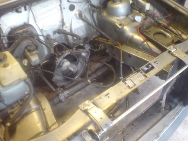

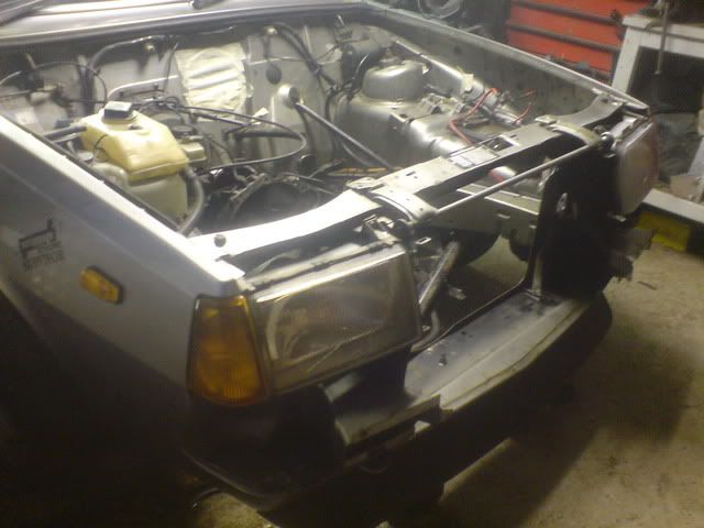

Yesterday saw attention switch to the 360, to get it stripped and see how big this mountain is that needs climbing. lol
A visit from John and Gareth to collect some wheels (we still forgot the one in my wheel well!) saw some easy assistance to remove the dash - cheers boys! I guess I don't have any pics of that. It's not majorly important atm, but I thought it may as well come out.
Hopefully it won't be living here for too long!
Then in the evening Mark and I collected Ron in Marks van, as we all know I'm carless now lol. After some initial mincing by me, on the phone to Richie to sort out the courier for the flywheel I bought from Pyro (cheers to two more people!) we made good progress on removing everything in the way, that was stopping the engine coming out. Then thanks to Micks crane (cheers mate! lol) we were ready to lift.

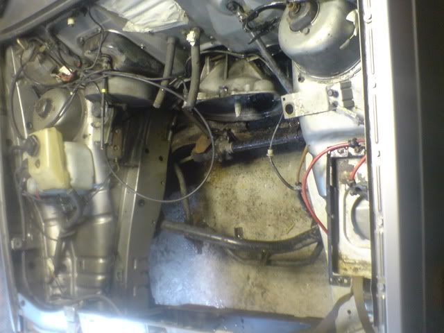

I've been restoring some dignity back to my engien bay today.
The concourse crew need not worry, Carplan degreaser and a paint brush/dish brush FTW. lol
Luckily, Mick was working just around the corner and helped me push the car outside. Engine out or not, that welded diff makes it hard work solo!
Dunno if I have any before pics, but it was covered! Right up the inner wings, the back of the frotn panel, steerign rack, subframe, ARB, bell housing etc etc were caked.
Much better now. Like I say it isn't gonna win any prizes, but at least it will be less of a PITA to work on the bottom of the engine etc. and easier to spot potential leaks.
That'll do.

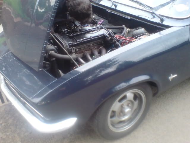

We cracked on with the engines after taking 5 and grabbing some chips in this stunner.

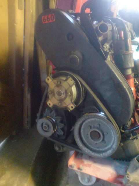

That little weapon is John's, and as can be seen it is running an XE on R1 carbs. It shifts!

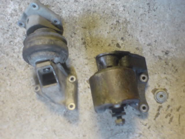

N/S engine mounts.
(Turbo on left) As can be seen, The B19 mount is a direct swap to the B230 block.

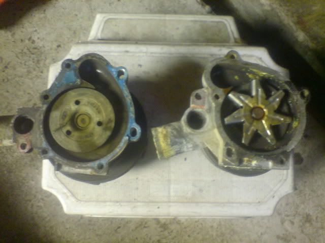

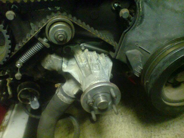

Water pump differences.
B230
B19
and the two downpipes. So much for hacking up my B19 and the B230 to make one. I forgot the B19 is a 2-1 lol.

N/S engine mounts.

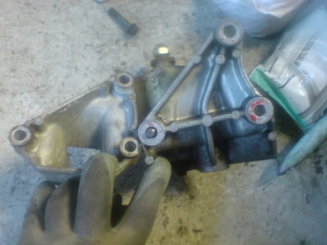

Are you going to use the 360 Engine side bracket? Surely this can't be used with the 940 sit on type? or do you just mean on the LHS.
For the turbo side I've estimated there is just enough space for the 940 bracket and mount, but its that tight that any custom chassis side bracket needs a hole/gap in it to clear the side of the mount casing.

Its the return. The pipe is only secured at the turbo and uses a rubberband type seal at the block, so it needs a rigid pipe. You may need to tap the block or something to secure a flexible line. I thought the Turbo was in the way, not just the oil feed return. Just checked it and the wastegate actuator is in the way. I measure 10" from the top of the head to the 360 engine mount top (excluding the stud sticking out, and raised sides). 10" on the 940 brings you half way down the wastegate control, but its hard to get the full 3D picture, you might be able to trim off some of the 360 Engine mount, and maybe add some strengthening, but it may still hit the wastegate arm or something. It all just looks too close, even if it did fit there may not be enough clearance to stop banging.L14MNP wrote:I haven't had a chance to compare the two yet mate. Will do that today.
First thoughts are maybe to bin the hard pipe for the feed/return (I forget which) in favour of a braided line, which should enable the 360 mount to be used and the oil filter returned to the B19 position.
With the 940 engine out you should try the 360 engine mount on (engine side bracket+mount+chassis side bracket) below the turbo.
Regarding moving the oil filter, the 940 has a water/oil exchange cooler I think. You may need an after market remote flexible kit.

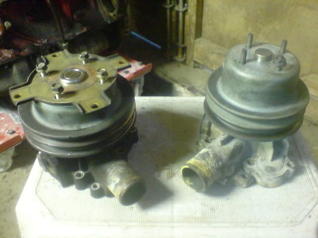

The FJ rocked up with a NOS B200 water pump for me. The pics below highlights the differences between the B19, B200 and B230 pumps.
B19, B230, B200, B200
B230, B200

The O/S engine mount from the B19 fits. It clears the turbo oil feed and wastegate etc. The only thing in the way is the oil return.
B230, B200

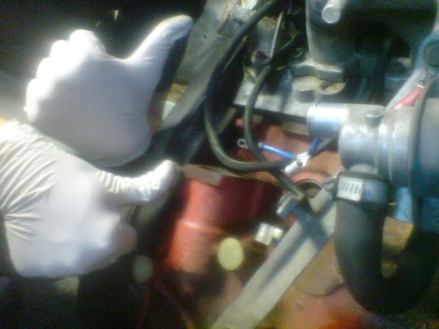

The water pipes for the turbo housing need a bit of re-bending to clear things, but we're there now.
Before
After
It seems as though the turbo housing is going to hit the engine mounting bracket when the engine rocks, but I think I will remove it and grind the lip away and see how it is then. If it's still crap I will cut a section out and triangulate it to regain the original strength.
