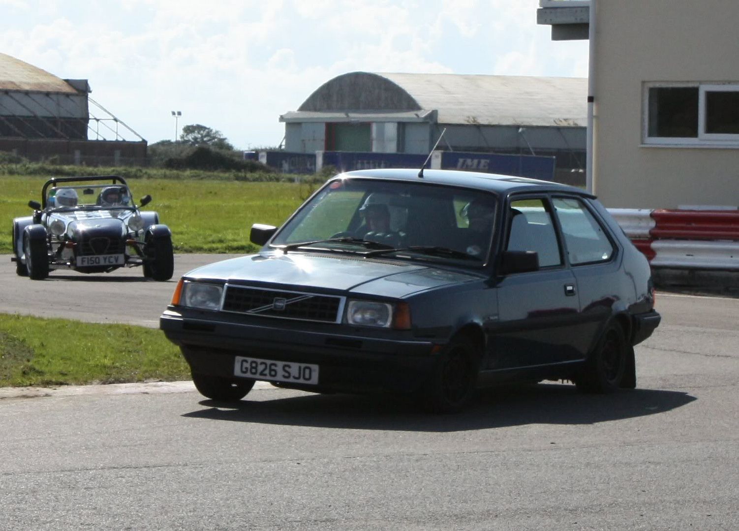

So saturday came and went and it was a great day, the weather forcast was a always threatening. But it turned out great! Not sure if something was up with the front of the car, but i have never ever known a RWD car under so much when hoofing it, 35 front PSI and 38 rear, and with the Landrover shocks on the rear i was expecting it to be very over steery, I will take a look at it at some point. Any way PICS fromt my new uber SLR Camera!

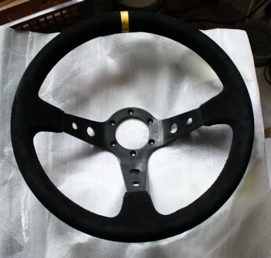

Well finaly decided what was missing from the inside of my car. bit smaller than the std volvo one.
just got to pickup a Pug 205 boss from my local rally spares place tommorow and see what if anything i can do to get the self canceling to work. I will let you know what i come up with.

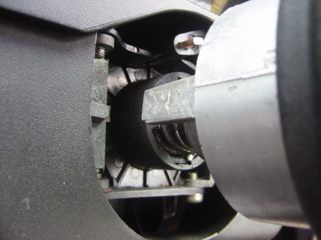

just to let you know, to get the self canceling to work i took the ring from the original steering wheel and fitted it to the 205 boss. i had to grind the canceling stork of the 205 boss though so it would fit up flush.
Hope this helps.

the wheel is a OMP "ahem Replica ahem" even came with an OMP Horn button :) seems to have gone up £8 in price since thursday,

The quality of the wheel was a little off, the 6 holes didn't quite line up so needed to do all the bolts at the same time. and the horn button was to small for the wheel and kept falling out :( got another one with my boss tho.

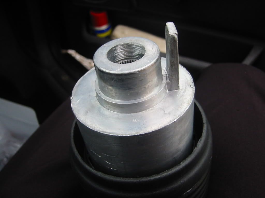

Well i have just come in from fitting the wheel, the boss is an Ektor 1328 i had to shorten it slightly to get the splines completey that worked a treat. still unable to sort the self canceling indicators tho, was unable to use the one of the volvo wheel as it would still be to short.
Still need to mount a horn button on the dash somwhere.
Definatley would like to sort it at some point in the future.
