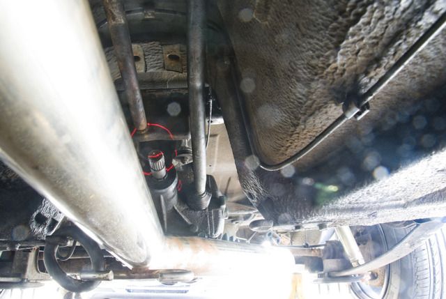

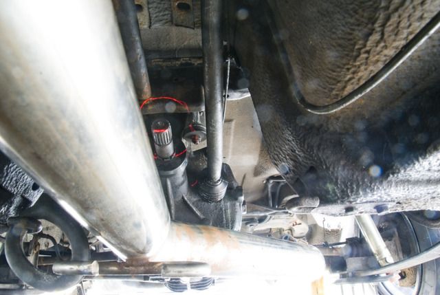

I've been in and out of the prop company's doors a fair few times these past couple of weeks, trying to find out why the prop isn't balancing right. At first, we thought it was just unbalanced, but it was re-balanced to a tolerance of 6.3, which is bordering race accuracy, according to the prop chaps. So fitted, and it still doesn't balance. A few days ago we got the chance to look underneath the car on a lift, and it was found the using a micrometer dial, the rear coupling flange was 0.5mm out of centre. So the prop itself is fine, it's this coupling that's throwing everything out, as it never spins centrally. Plan of attack is for the company to re-do the flange coupling, but to centre it now using my old 1.4 clutch output shaft. this will mean that the flange coupling is pretty much dead central. The other coupling will be check for alignment also. Furthermore, the prop will again be checked for alignment and be re-balanced.
