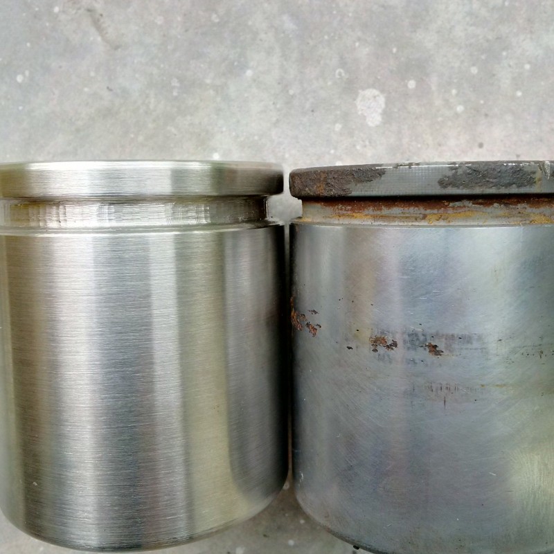

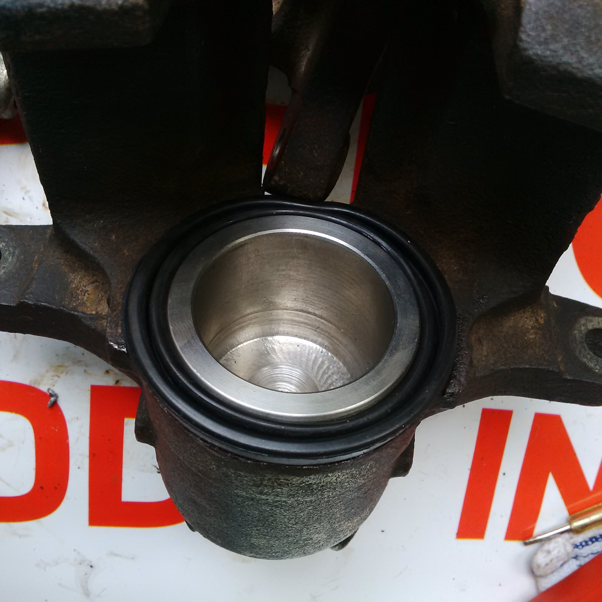

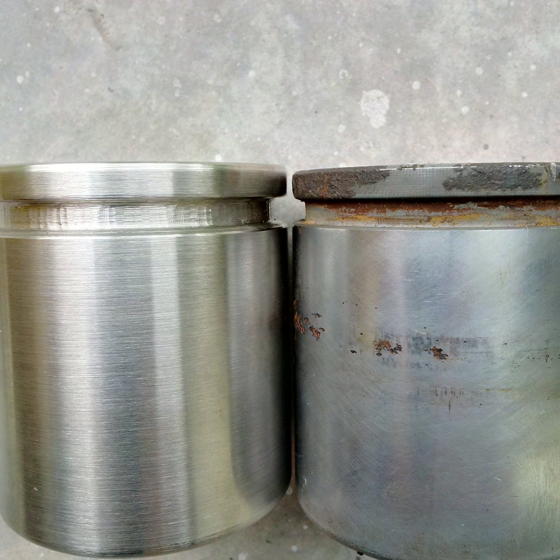

This is the piston that the foundry did. Scrapped of the rust on the edge of the caliper, and it fits perfectly..

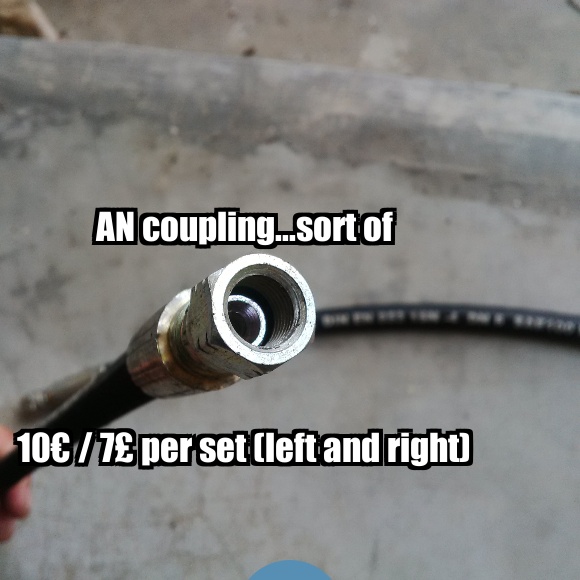

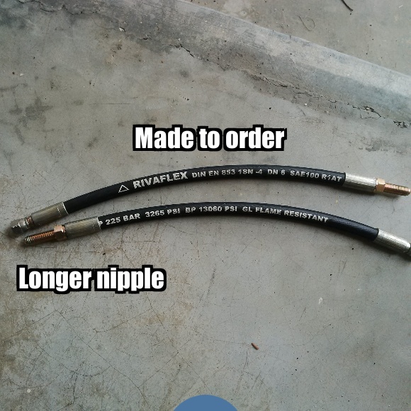

Hello chaps..
A little update..modified brake hose. Made from flame resistant material..hose is suitable for all types of oil and fuel..but the caliper side nut is slightly longer..i think it won't do no harm. Now..all left is to asseble it back..

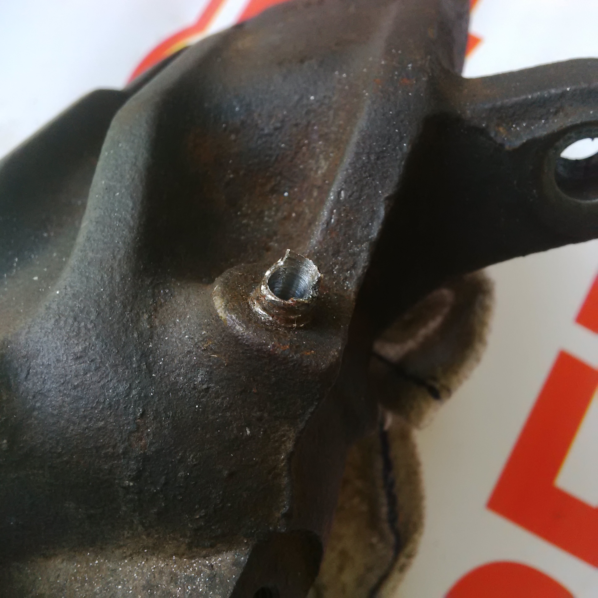

The bleed nipple is so darn hard to get..i sent the l/h side brake calliper to foundry and ask them to remove the broken bleed nipple..he did remove it and make a new thread..he make it bigger. Actually I already acquired another brake calliper but it's for the r/h side. I'll just keep it for future use.
Thanks for the info man.

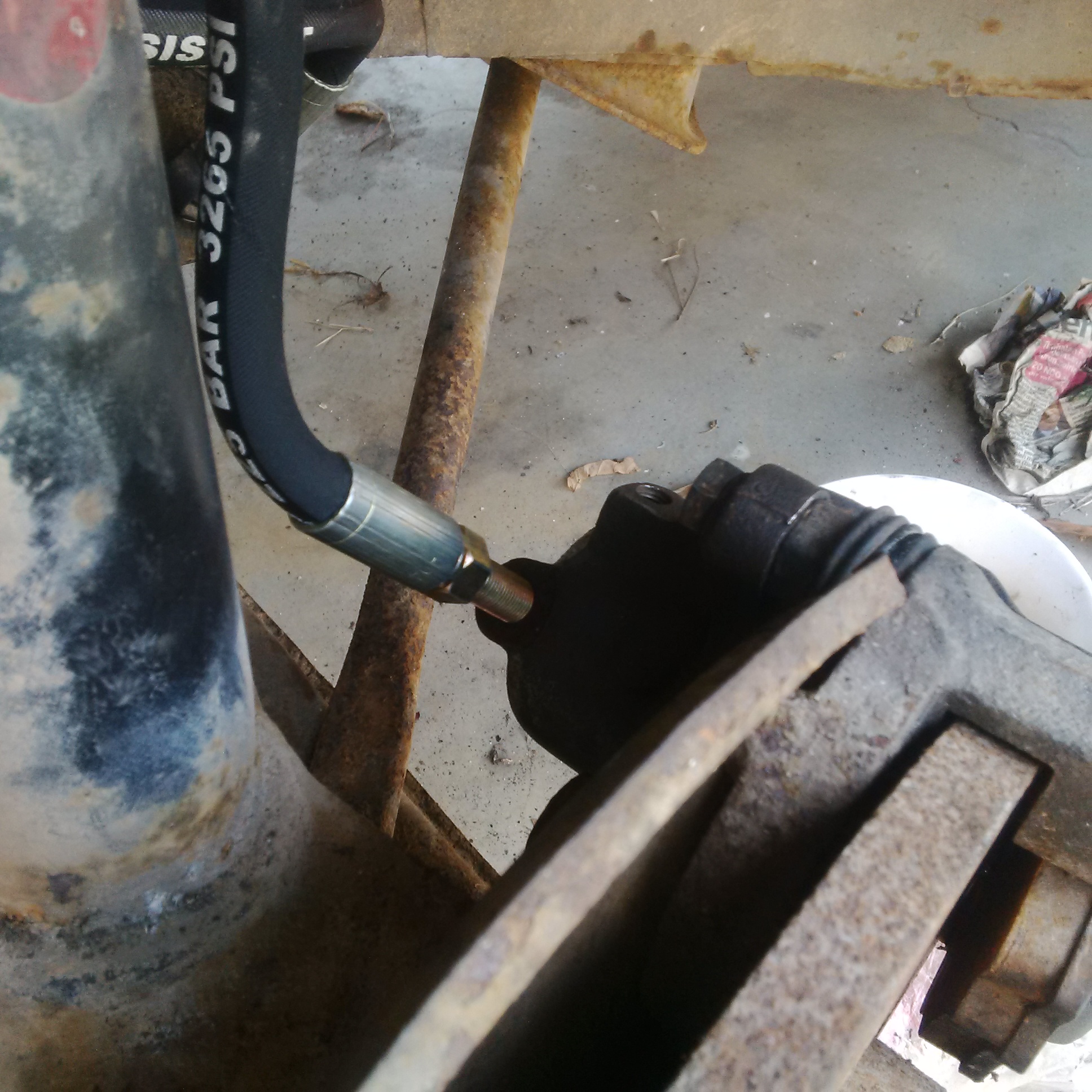

Flexi hose fitted..

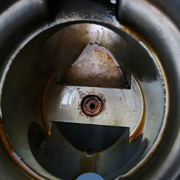

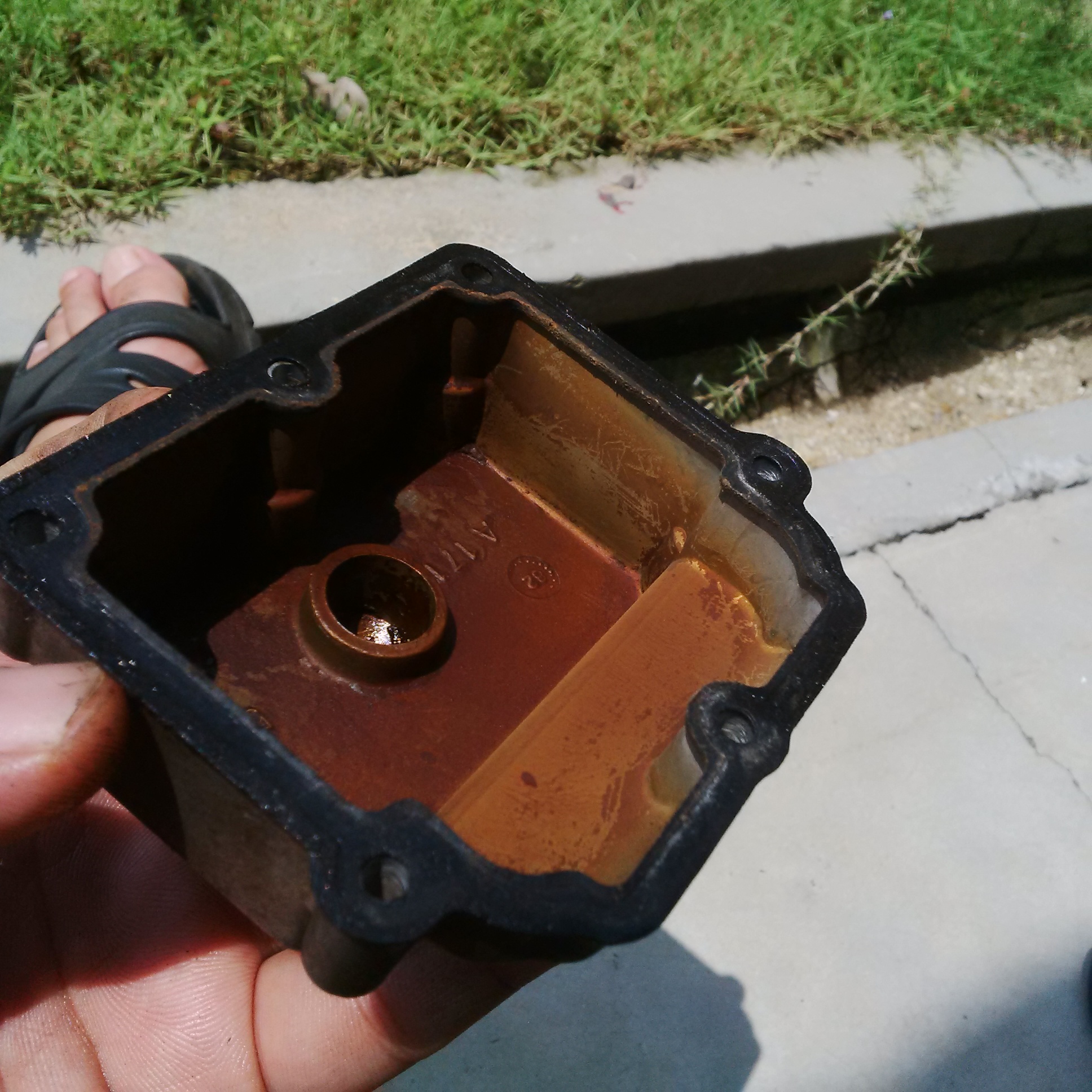

Next project is to clean the fuel tank. This is what a dirty tank will do to your carb.

Hello experts of 360,
Now the carburettor is clean. I am going to remove the fuel tank. From Haynes manual, 1. I must jacked up the rear of the car.-done-.2. Remove the heat shield from beneath the fuel tank.- I don't have the heat shield, it's carburatoer. 3. Disconnect the gearchange rod at the gearbox and unbolt gearchange from the middle of the torque tube. How do I do this?
