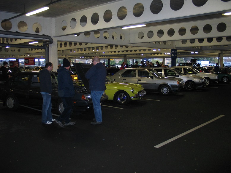

Showing with Marks, Andys and Aidies car
- Attachments
- IMG_2461s.jpg (146.11 KiB) Viewed 13769 times
