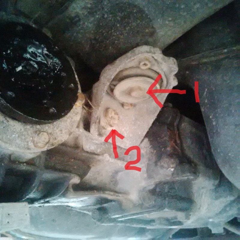

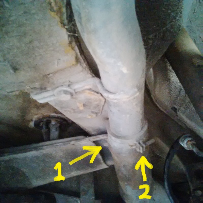

Hello bog, i'm not sure i can find the right size of the bolt if i cut it. Maybe i'll try to apply ride on method. I wasn't sure which bolt that you mention man.. is it number one or number 2? please refer attached picture, i mark the picture with yellow and red, 1 and 2. Please tell me which bolt i need to remove first. Thanks..

I was suggesting yellow 2 (if you mean the pipe clamp) then yellow 1(there are 2 on each side). I'd also change the metal filler pipe to a plastic one otherwise you'll end up leaking fuel from rust holes, although looks OK at the moment.
If you go the red method, Red 1 will not undo without getting a spanner above and gadget arms :), easy enough to get replacements. Red 2 will unbolt from the diff and you can drop the diff below the dedion tube and pull it off (easier to say than do, but keep wiggling). Diff/gearbox and torque tube can be pulled off all at once if you disconnect the gear lever.

Also another piece of advice, if your aluminium brackets are still good I'd clean and paint them when they are off, even just a coat of primer will help prevent corrosion against the steel in the bush. Usually they are very corroded and wasted away. Currently replacements are unobtainium and very tricky to repair.
