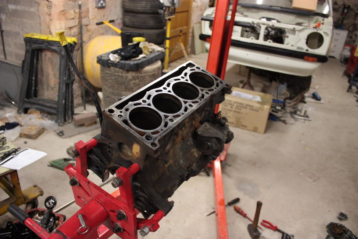

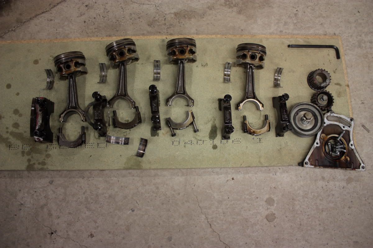

after buying a new T55 Torx bit finding it was to big to fit down into the head, Then finding my original one i was able to get the head off and turn the crank over (with extreme difficulty) to take all the other big ends out. and strip the rest of the engine.
And Everything Layed out nicley :0

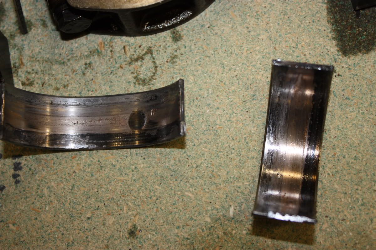

Those clicked the Above picture to Zoom in may have noticed Big end bearing Number 2
as you can imagine these took some persuasion to part from the Crank after they had friction welded themselves to it!
The crank istelf looks not to bad after a good rub down, but im still going to get it measured, cleaned and checked over,
All in all, it looks like i might get away with some new Bearings and a possible crank re-grind. \o/

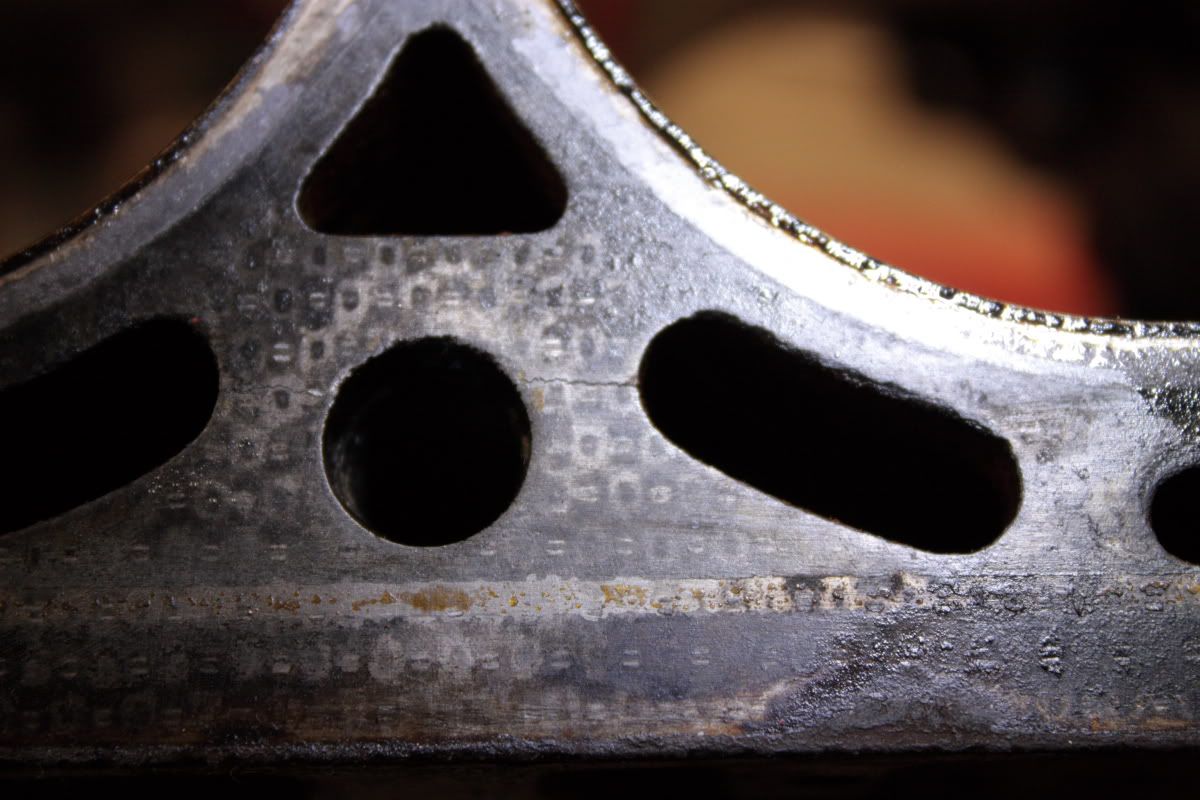

However i did notice these on the exhaust side of the block, there are just through the water channels into the head bolt holes and not through into the oil channels (no cracks there, I checked) it may have been like this for a long time, prior to the big end siezing it was running perfectly, so im not that concerned about it.
- Posts: 3657
Re: WooDooUKs ReVolvo Project (Update 05/03/09) Answers!!
That other block i had from you had done that, its a common problem on the 1.8 bottom ends and williams bottom end. Thats why the later megane bottom end is sought after, its much stronger and doesnt tend to do that.
