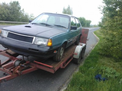

picked up the donnor car which already has a megane lump other than that its going for the crush as its been abused hard rust everywhere trippled up rear leafs held together with cable ties "A HomeMade" rear strut and just abuse all over thankfully he never got the engine going probably something simple as he has loom key and ecu from the megane yet he couldnt get it to work, he seemed fairly DiY in the mechanical side of things so heres a pic ill upload some more tomorrow

Well saved from oblivion, looks like a nice clean car to start from, and a 3 door!

yea people say i was mad as it is mint but then like i explained i dont want to be fixing a dog rather finesse a good one
