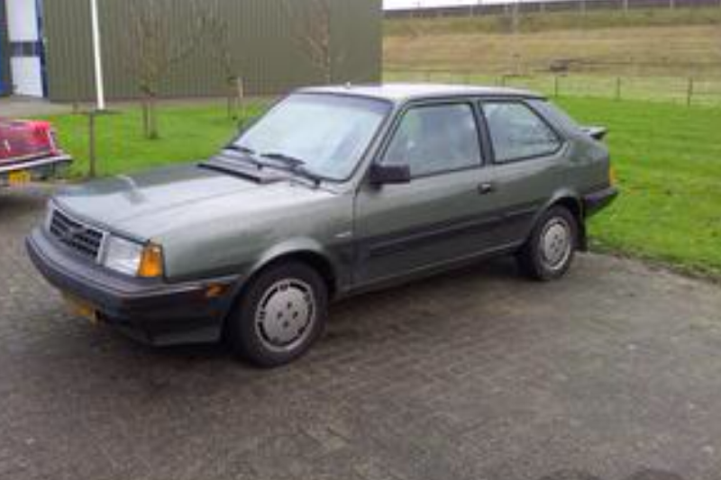

Few weeks ago i found this decent 360 hatch i will convert into my new racer this season. When i will lift over the engine and other bit from the current car i'm not yet sure (end of the season would be smartest)
Anyway here a few low res photo's for now

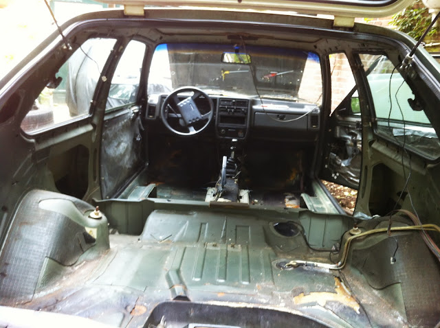

Cleaned out all the interior and started to take out the insulation on the roof and the floor.
Took off the tow hook also, getting lighter
Nothing nicer then coming home from a day at the office and to strip some more stuff off the car

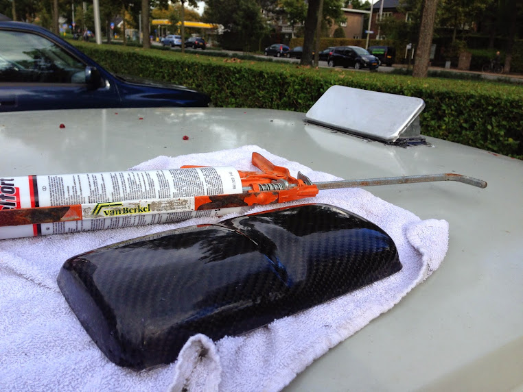

Got a spoiler that goes on the old style tailgate, all the mountingpoinnts where rusted out. Perfect moment to do some weight reduction.. that thing was heavy before i started taking all the rust out!
Not i have to figure out how to mount it back, maybe just bolt/pop it and allot of kit
Gave all the interoir stuff away and traded 2 struts for a piece of plastic that goes on the back

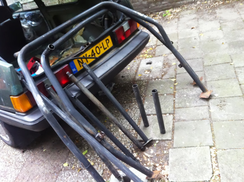

Bought rollbars!
Trew them in the car, i deceided to sand them down first, then i tought maybe i should clean them, while they are clean might as well paint them.
Took them to the garage and started paiting, offcourse i did not change my workclothes, then i hit the bars with my shoes and pants and decided i will do the rest tomorrow

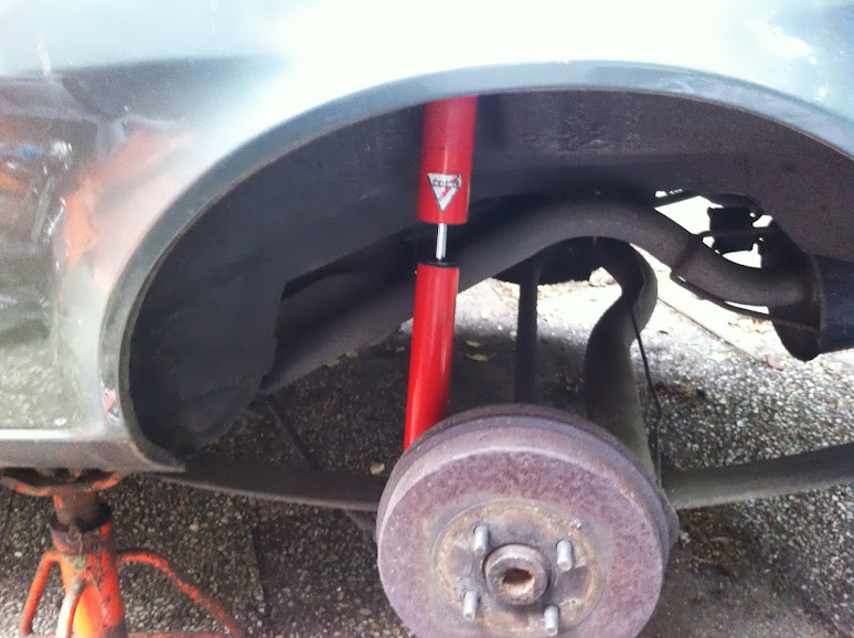

The back is been overhauled with some koni;s
Used the press of the neighboring garage to put in the PU bushings i got from Dai (Classicswede)
I wonder how much of a difference this will make on the leafs

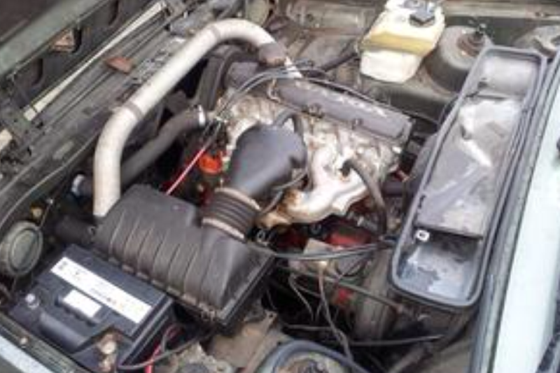

another Saturday spend well, Injection engine back, new downpipe, some welding and the rollbar testfitted
