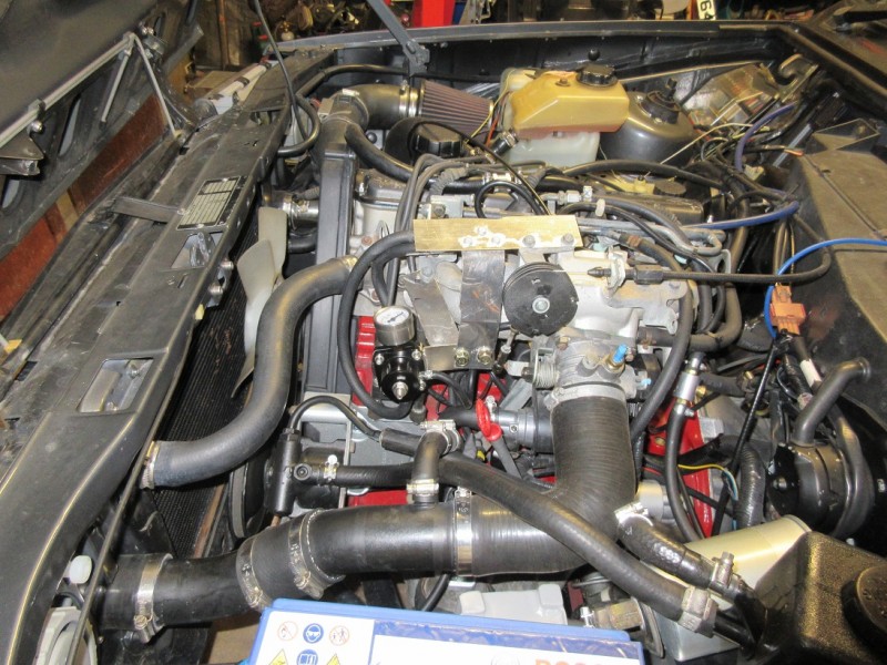

I've added a manual fuel pressure regulator so I can turn the boost up more (15psi now), although drag times don't seem to have reduced much it feels quicker. I need better traction wheels as the track days tyres are designed for some heat, drag is stone cold and spinning up doesn't really help.

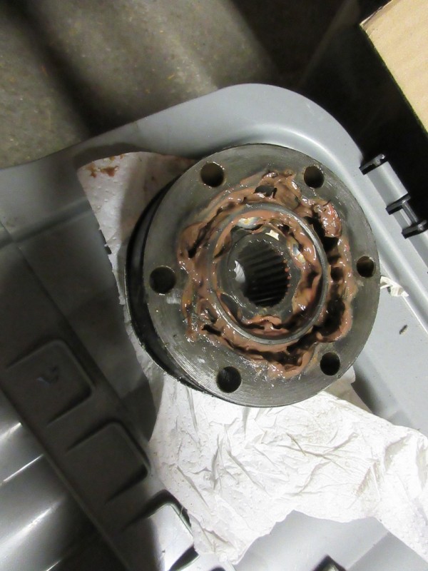

I've chewed a CV joint causing the cars first every recovery truck, annoying because I could have repaired it on site but mistakenly identified the gearbox as the fault. I think the cause maybe grease loss as another joint was also loose, not sure why yet. Seems to be leaking from the metal-metal joint at the flange.

Modified the rad to reduce the blocking bits and added baffles to increase the air flow.

Notice you haven't got a radiator shroud on - am I right in thinking this is designed to aid cooling because it covers the radiator or have you found it to adversely affect cooling?
15psi is pushing that little 13c to the max now, might be worth considering an upgrade to a slightly larger turbo from the same family? 15g, 16/18/19t etc?
Re: 360 turbo saloon tidy up
Yeah the radiator shroud is just to make the fan more efficient at idle/low speed IMO, maybe protect the disti from water. It blocks it at high speed where I am having the temperature rise (max throttle track etc). I am feeling confident the rad mods (removing 1-2cm of blocking material top and bottom) and the baffles will bring this just into spec, but not tested yet because of the CV failure. I think I just needed about 10-20% more cooling. Next step is the wider intercooler.
The 13C seems to manage 20psi no problem, but I know the word on the street is this is pushing it creating extra heat. I'd really like to measure that, but not got decent logging setup yet.

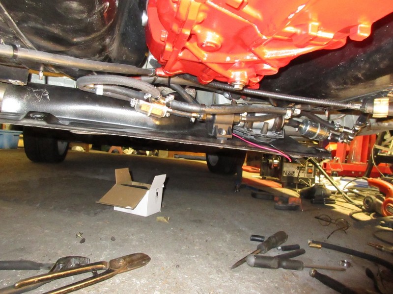

Trying to pump up the leaky swirl pot in the tank with some success. Taking the lob joiner pipe and pumping from that into the inj pump inlet and the tank. Helps me down to about half a tank now, but then starts spluttering briefly on some corners, and recovers quickly. Have found a place above the gearbox for a small custom spirl pot. Brakes
