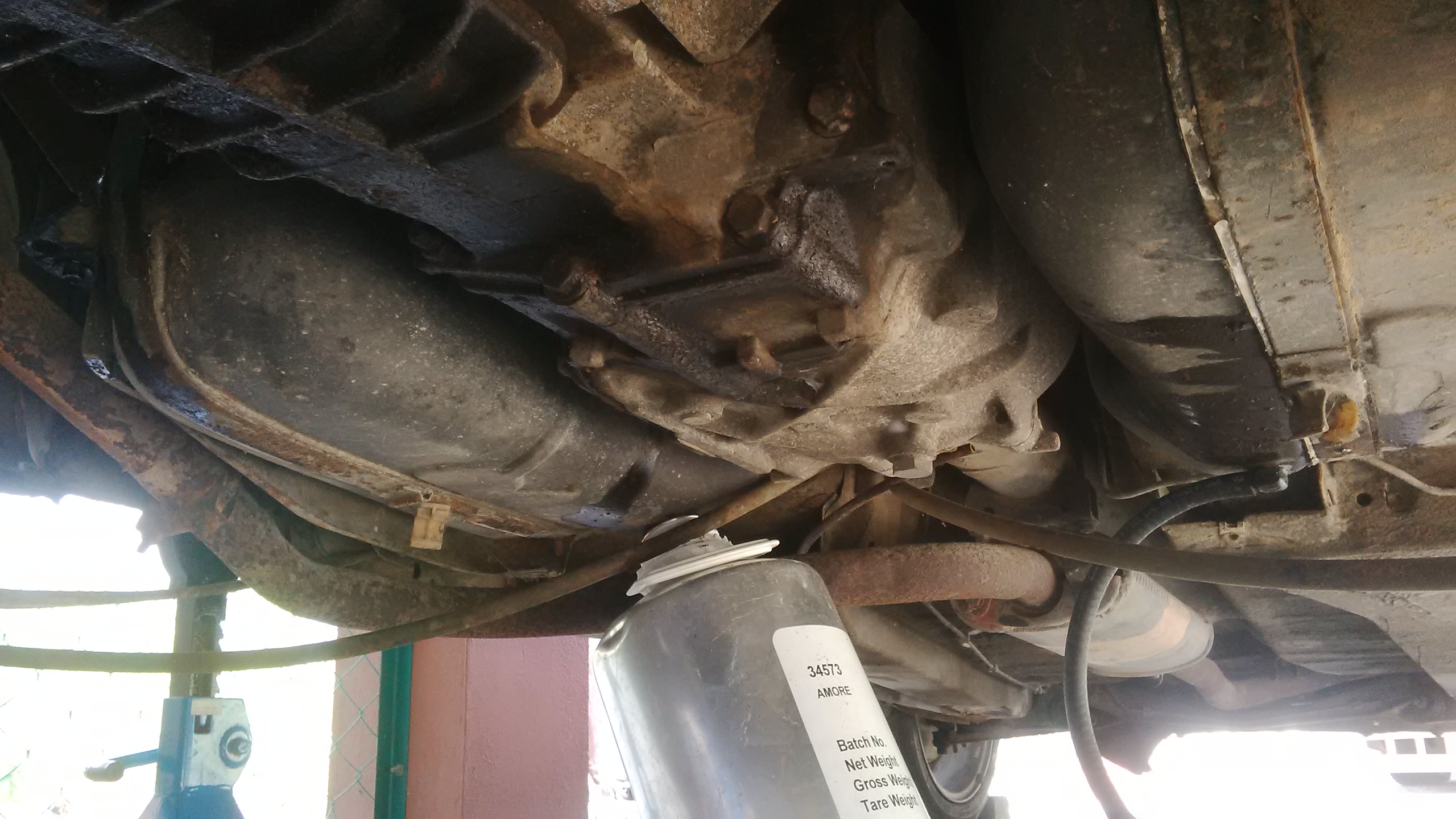

Hello All.. Happy new year..the gls can be start at last..i changed the ac pump, service the carburator and adjusting the float..the engine is quite very good..i post the video later..but there is some problem with fuel delivery..i think the fuel tank need to be service because there is no fuel coming out from the hose..i studied the haynes manual but couldn't understand the term used. What i know from the book is, i need to remove the gearbox and the torque tube..and also tyhe rear drive shaft..a little help please...i'm really sure this will be a difficult job..fyi i already jack the rear of the car..thanks in advance..

Long time, no hear. I don't know the injection cars but I managed to cure my fuel delivery problems on a carb 360 without removing all those things but some unbolting does help a lot. If yours is a carb car it will just be an air lock or leaks in the hoses. I used a syringe to suck some petrol through at one point. Does the pump work.... Can check with petrol in a bottle, carefully.

Post by zack360 » 26 Jan 2015 03:51 pm
Here are some picture.. I have the trolley jack.
How do I get the gear box down?

Hello, Its easiest to unbolt the two brackets at the side of the gearbox and lower it down on a jack.

Yes! Using syringe, or maybe I can use the shampoo bottle cap "the pump" type, good idea man. A friend suggest to use air pressure to clear out the clogged nipple. It's better to do it this way, than bringing down the fuel tank. Thanks man.

Carburetted engines have all the important (supply and return) fuel lines on top of the tank, under the rear seat. You could look at that first, before removing the whole tank. Take out the fuel sender unit, and take a look inside. That should give you a good indication in what state the inside of the tank is. And you can clean the filter and lines at the same time.
