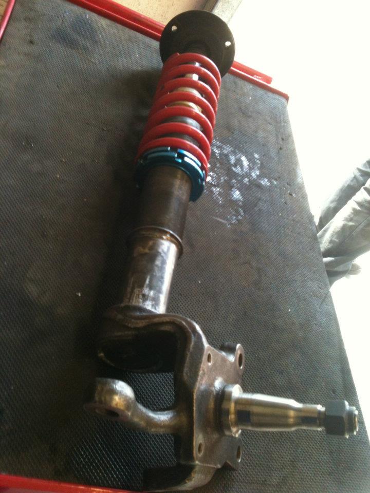

Once the hub castings are ready, start work on the coilovers themselves.
first you want to strip them down - i removed the inserts from the housings by placing the captive nut section into a vice then undoing them. It is important you do this because the heat from the angle grinder and then the welder can potentially damage the insert damper. its also a heck of a lot easier to work on these when theyre just an empty tube :)
again i havent got the best of photos, but you should get the jist of things anyway. you want to get a cutting disc on a grinder then gently start cutting into the welds that hold the mounting bracked to the main body of the coilover.
hopefully you can see where the cut is - if you take it slowly and tap it with a hammer you will eventually see cracks - these indicate the end of the weld and the beginning of the housing tube itself. you want to leave it there and move on to the next area of the weld,
then once youre all done jsut use a lever bar or a hammer and chisel and you're off!

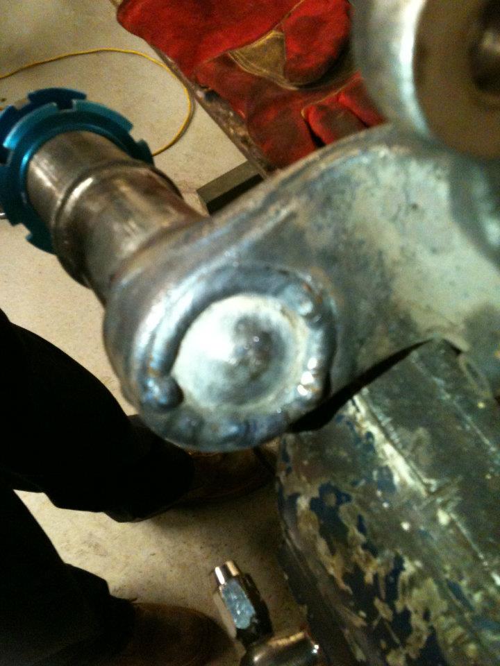

then use a flap wheel to grind the remainder of the welds flat. go over the whole damper to get rid of the protective coating, or in my case rust!
you will have to go over the whole tube to make sure it fits snugly. then using a rubber mallet, simply tap it in! i did mine so it sits roughly the same distance into the casting as the standard damper.
All thats left to do now is the welding. then you can get onto making the top caps.
so turn the welder up to max (i used 160amps for this weld iirc) keep the torch on the casting, briefly sweeping over to the tube itself. this will get VERY hot but its essential to get a strong enough bond with the cast. just try your best not to blow holes in the tube - my technique of just going for it worked well enough, resulted in this:
weld them top and bottom for optimum strength - mine have withstood a run in with a roundabout at higher than average speed and all is straight and good :)

the next bit is time consuming, you basically need to make shims that go between the damper tube and the bearing - i dont have pictures of these however i will get some and add them later, or ill do a diagram (im supposed to be finishing a college writeup on this but instead im doing it here. failing life 2k12.)
the shims need to be in two parts. use a solid bar of steel, about 23 mm or so in diameter - machine one section so it can be welded to the spring location cups you made earlier. then the top part of it, spin it so the bearing sits on a step and then has 5mm of material going inside the bearing between the damper tube and the inner part of the bearing itself. sleeve is the word im looking for i think. then make the part that will go into the top - it only needs to be a 10 - 12mm tall. have 6 -7 mm of it as the sleeve part going inside the bearing, make sure you leave a mm or so of a gap between the upper and lower sleeve - you dont want these to touch as when you do up the damper top bolt they will just compress and push against eachother but the damper will still be free to move up and down. (i know its obvious, but making it clear). once youve made those just put it all together and enjoy i guess.

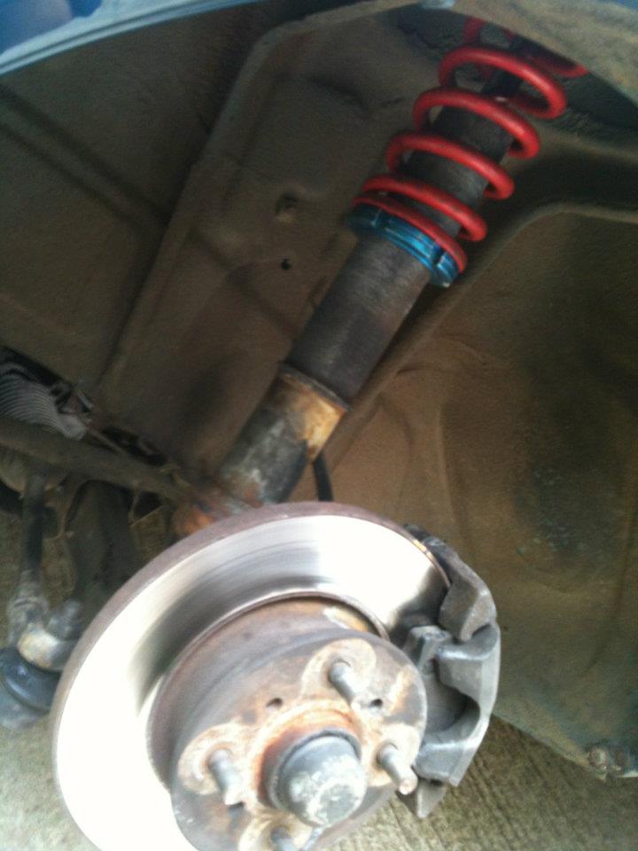

cheers dude! i wouldnt put it much further through, as my wheels sometimes catch on the wheel wells but i have cut the bumpstops down :P. need to get a picture of one of these next to a standard item really, quite a height difference lol

the bit thats directly above the tires on the front, and nope on 13s with 175/60s and still catching :P

My biggest concern is that with welding the strut tube to the hub any missalignment is going to cause poor road holding and uneven tyre wear. If it was combined with an adjustable strut top then taht could be used to correct small deviation. After doing anything like this 4 wheel alignment is esential.
When welding the hub I would highly recomend pre heating either in an oven of with a torch . This will give a much better and stronger weld.
Be very carefull how much heat you put into teh coil over. Welding dampers can be very dodgy due to the oil/gasses.

thanks for the positive comments, i'll make diagrams of the top cap soon as i need to do it for my writeup anyway ill pop them on here and ill try to tidy it all up.
i thought that too Dai, about the tubes being off center, but to be honest using a straight edge it matched up to the standard ones give or take .5 of a mm,
top cap wise, the easiest thing to do is to buy s13 mounts and just weld on thick sheet with the right pcd mounts to the suspension turrets as itll be a lot easier than making top caps from scratch.

The rest of the pics:
