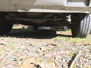

Sorry Kennet I have been very slack and not posted how to do it. I have also missplaced my little drawing I made of how to modify a front shock out of a Camry V6. Very similar I just needed a different nut for the top but machined up a 30mm bolt head with part of the bolt shaft on it and tapped out the innards to suit and also machined out the bush on the top bit of the strut which bolts to the top of the car. You need to bend each of the three lugs on it to allow the bolts to align up. (put the bolts in and place the heads next to the top of the strut and you will see what I mean - they are bent out a bit to suit what is there now).
As you can see in the pic of the top of the strut you can just see some of the rubber which I used to raise the thing. I used two pieces 12mm thick. This gave it a 24-20mm lift due to the compression of the rubber. I put Corrola rims on which are 13" allowing me to fit an oversized tyre on it (commercial ones - with no traction!) which gave me another bit more height of about 20mm.

- Rough drawing
- IMG_4030-1.JPG (19.37 KiB) Viewed 8192 times
- Rear bolt on spring
- IMG_4028.jpeg (34.13 KiB) Viewed 8192 times
- The raised front
- IMG_4025.jpeg (41.14 KiB) Viewed 8192 times
- Top of strut with modified nut
- IMG_4026.jpeg (36.52 KiB) Viewed 8192 times
