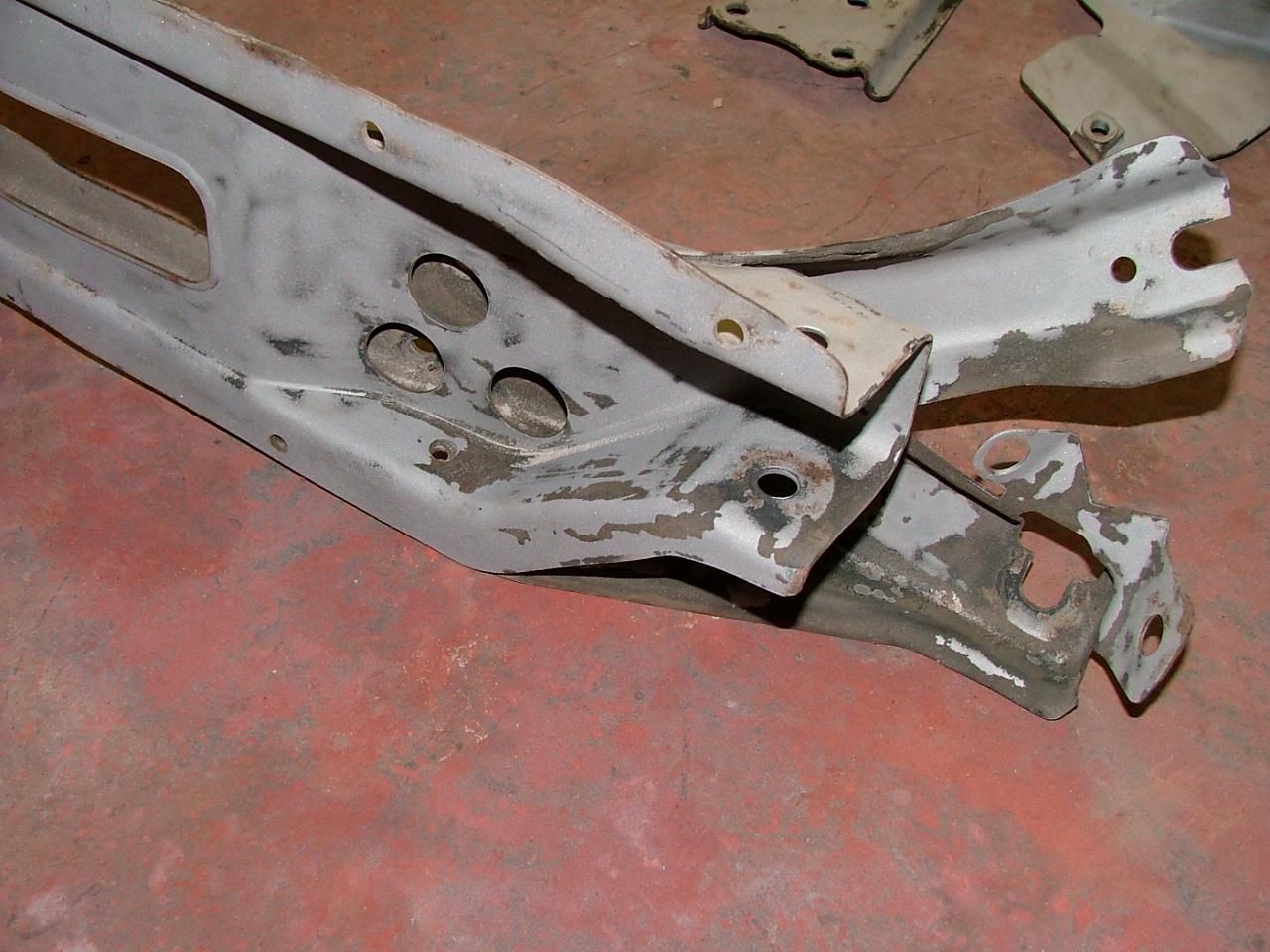

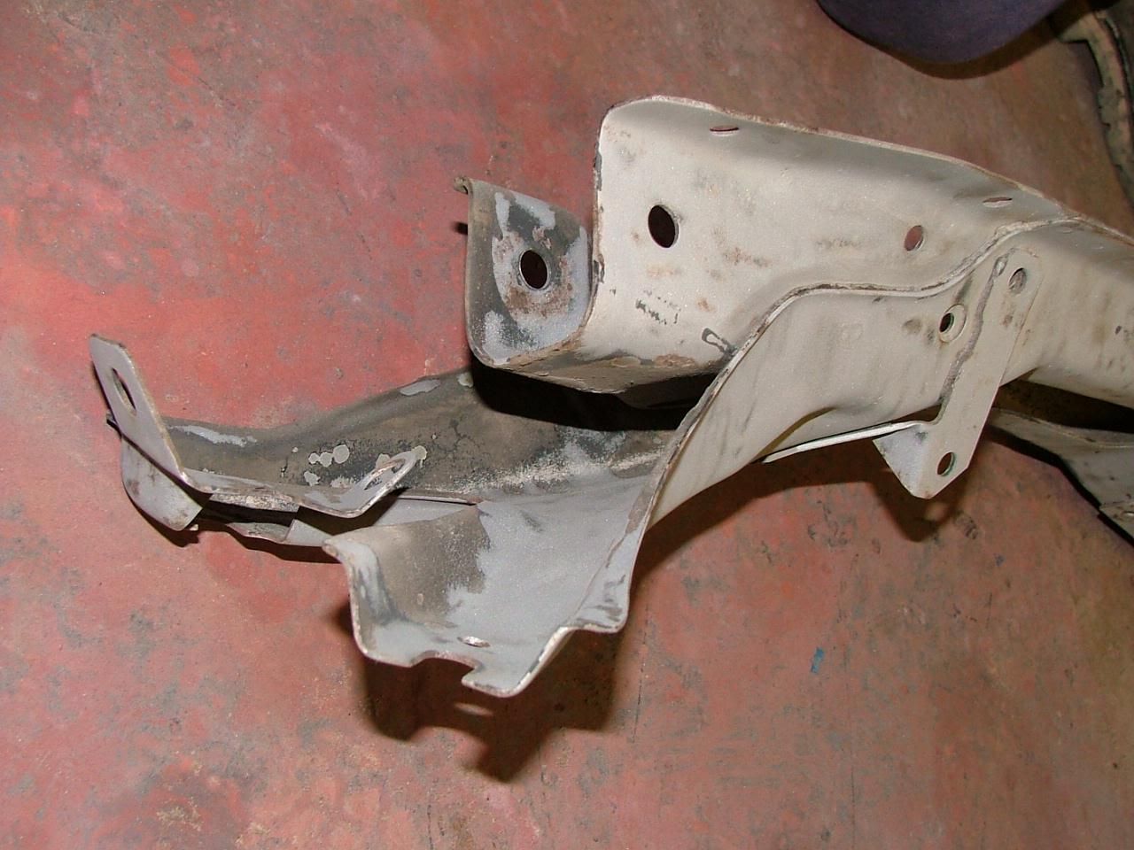

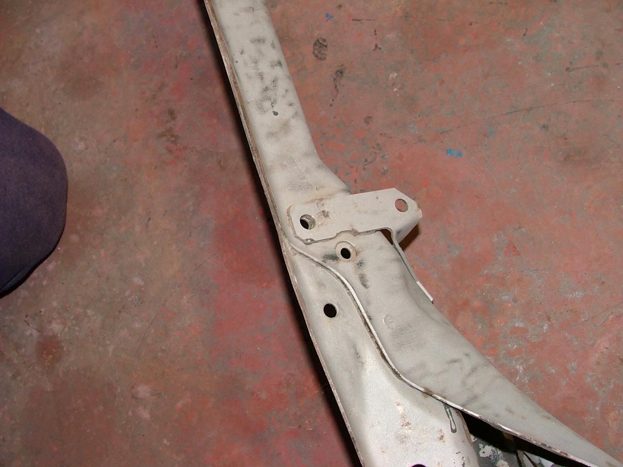

Speakin of which here is some pics of my progress.
The crossmember is now fully stripped and sandblasted. It is also fully strengthened, although looking at those wishbones i might be doing that too!!!
Here are the pics of the sandblasting done, strengthening pics to follow 2moro nite!!!

Looks loads better after a goob blast :D

Yeh cleared all the rusty patches off and they are like new. Strengthened all the spot welds by seam welding the crossmember with gas torch, then migged the back of the turrets where they rot and also beefed up other welds with the mig!!!
Boy is it tough now. I thinks i'm going to box in the wishbones now after seeing those altezza ones.
Cheers Adam

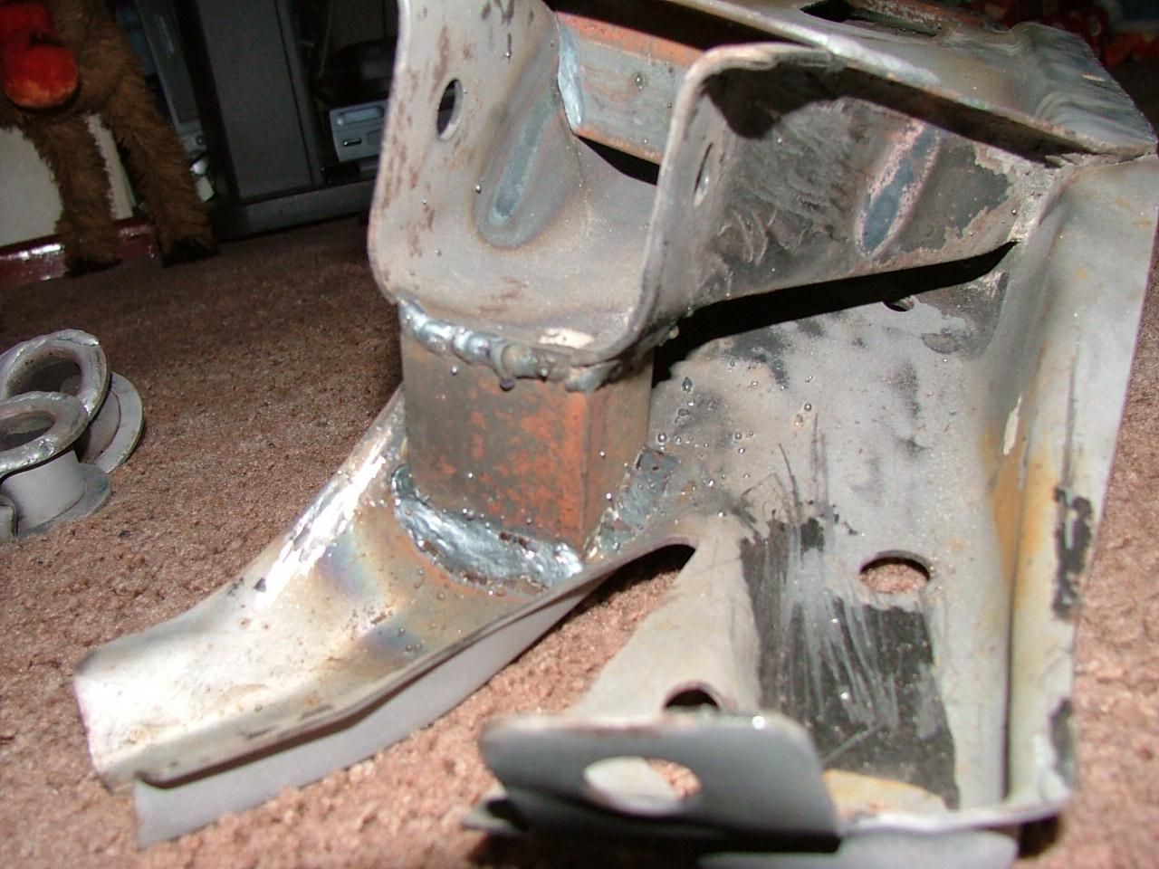

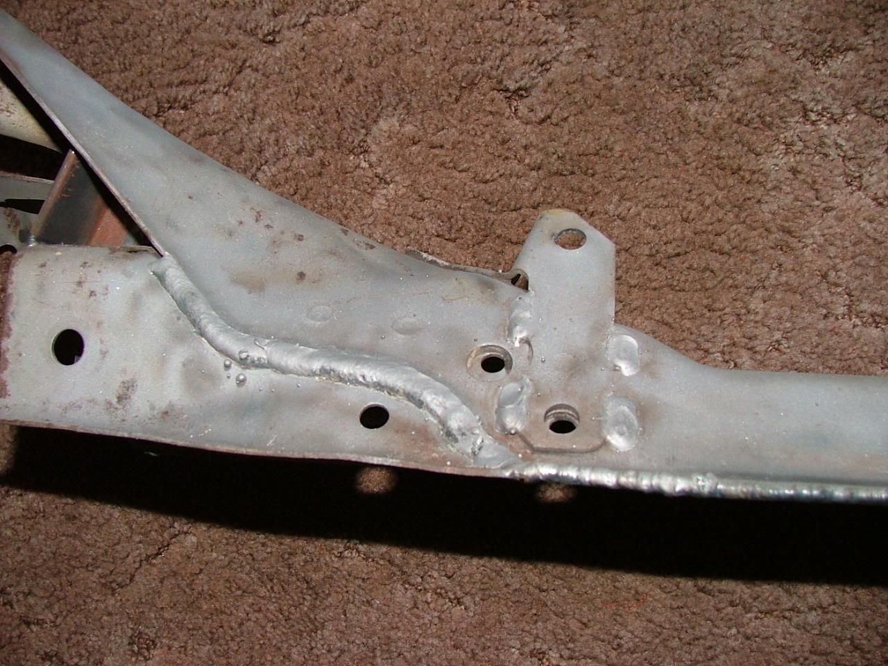

Post by 340GLT » 23 Dec 2005 12:11 pm
As promised updated pics of the strengthened areas. Note some of the welding needs cleaning up yet and then they will all be painted.
Cheers Adam

COOL work Adam! I like part where you have seam welded along the old welds to strengthen....
Ive got a rear suspension I was to recondition... and your post got me thinking... basically... is it a good idea to put new seam welds along and over the old joins/ welds in the suspension after its all clean of rust.?? afterwards you paint it all...

Yeh its good to renew the welds as most parts are only neatly welded to hold them not for strength.

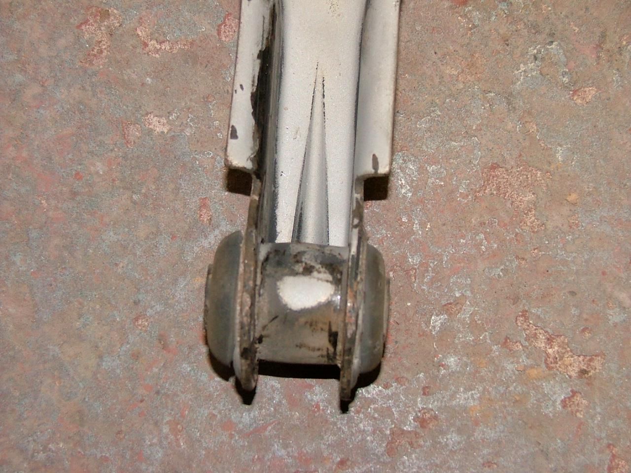

I just finished my arms off tonight. Will post pics of them with poly bushes too. Will try and get pics 2moro, if not it will be Monday.

Finally got round to posting pics of the new arms boxed in, fitted the poly bushes i got from Dai too tonight and made a strut brace for the back in this link!!!
