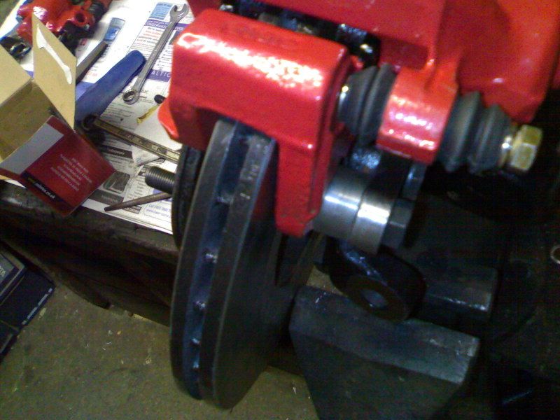

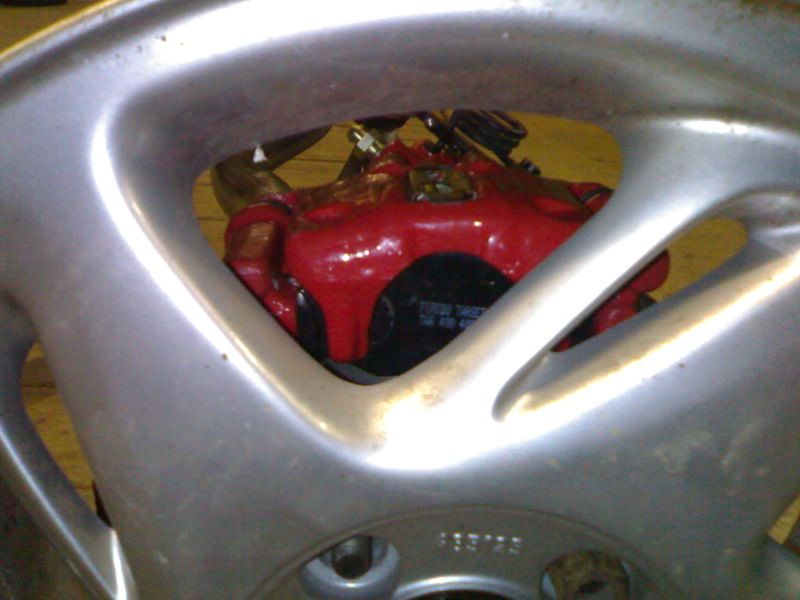

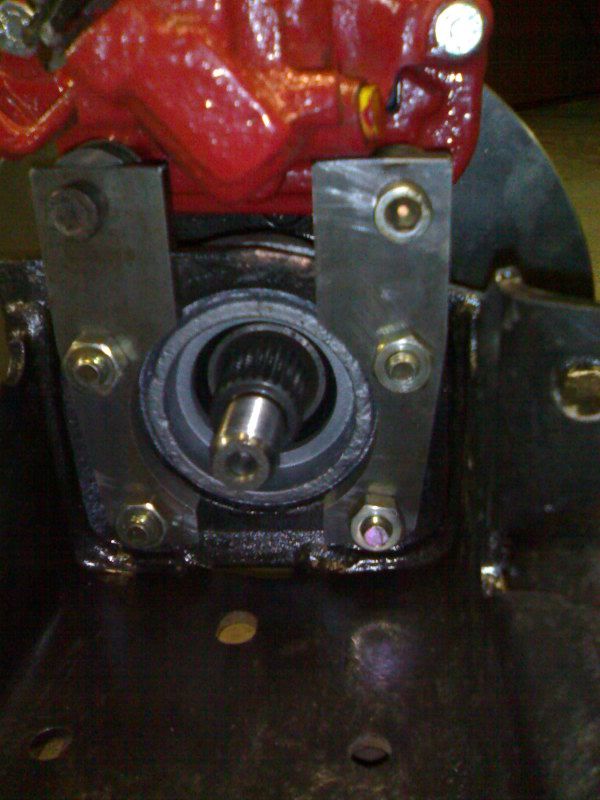

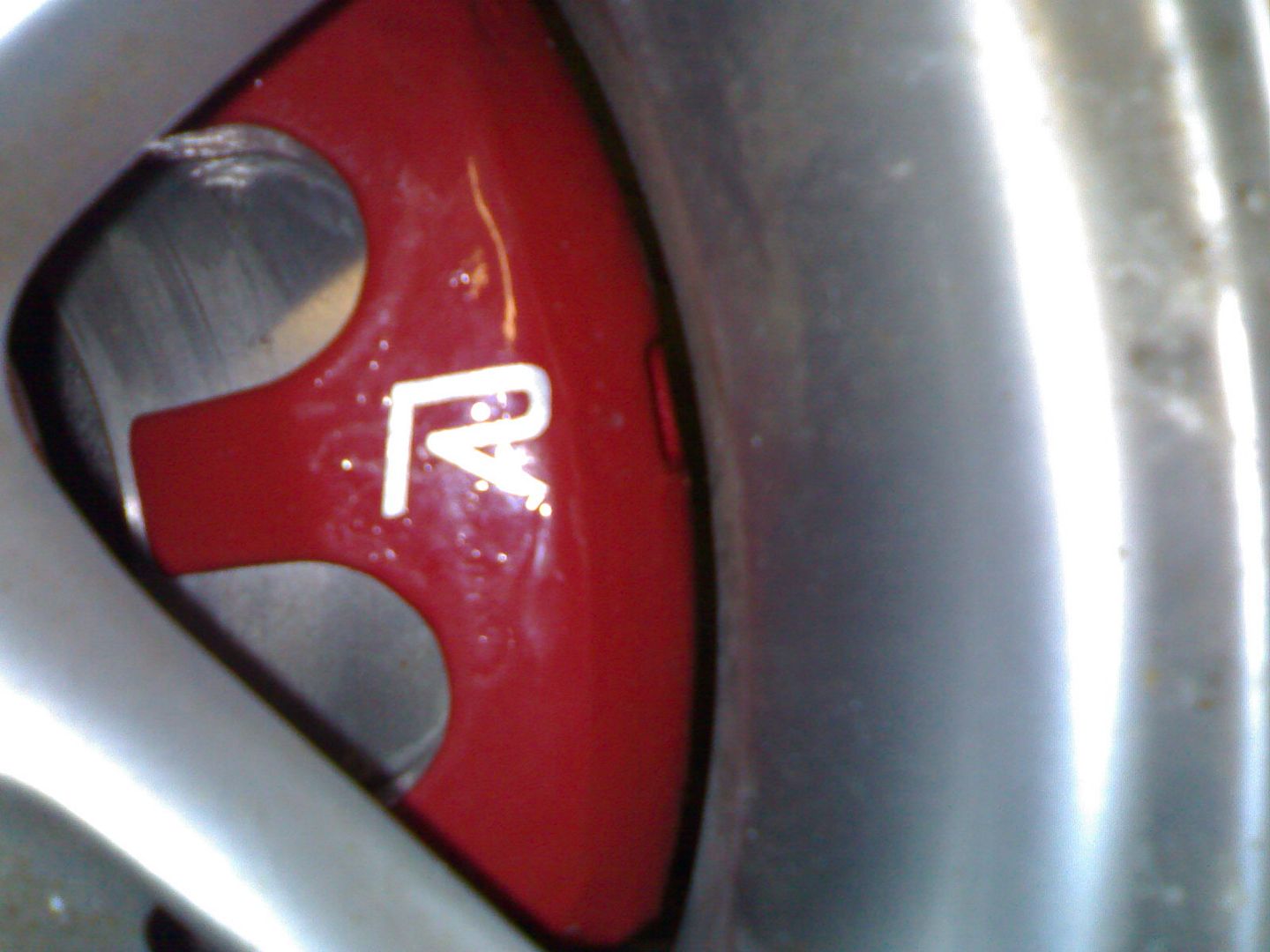

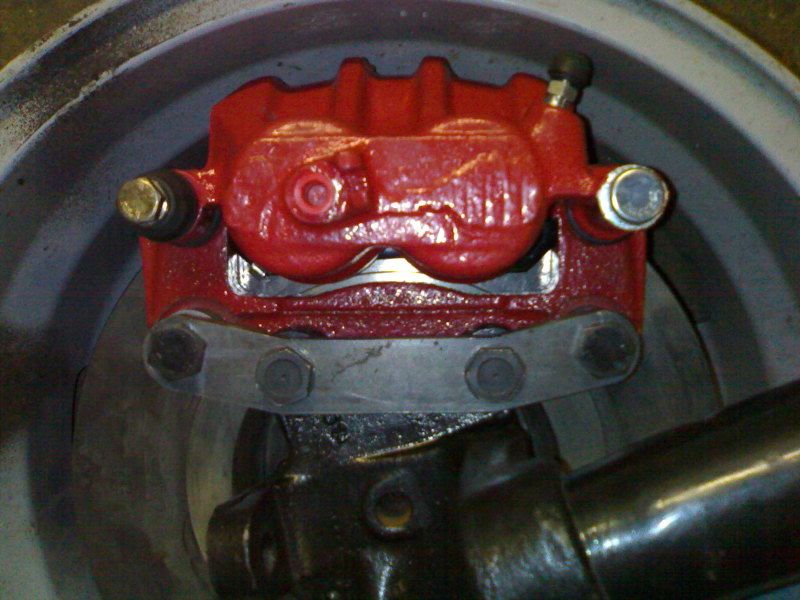

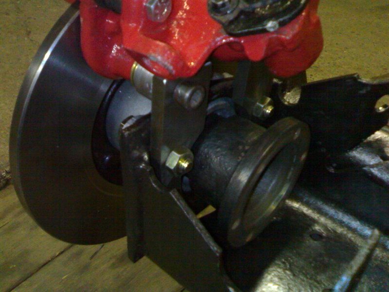

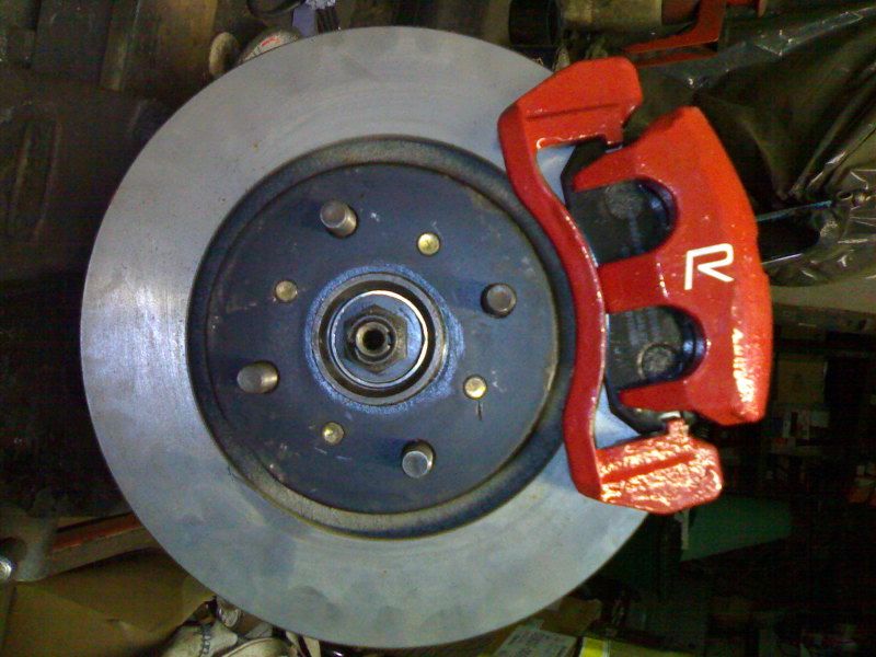

The wait is over. My college project was handed in today and this is what it was all for. Running 280mm vented front disks with impreza turbo twin pot calipers. The rear is using a 226mm disk with sierra caliper and standard handbrake cable. Should be on the car within a week!!!
Here is some of the better pics however use the link at the end for more pics of the build!!

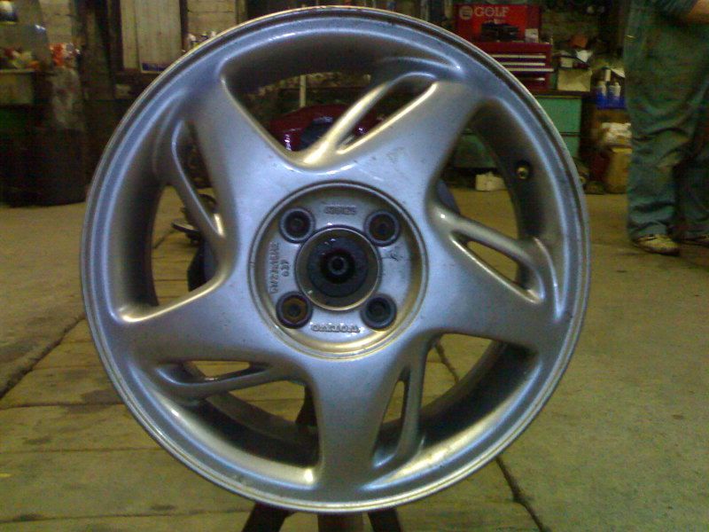

The wheel is knackered, its bent in the back. I wanted to check i could get the brakes under 15" wheels!!!! Mine have a lower offset so should have a tad more clearance on the front edge.
Adam
